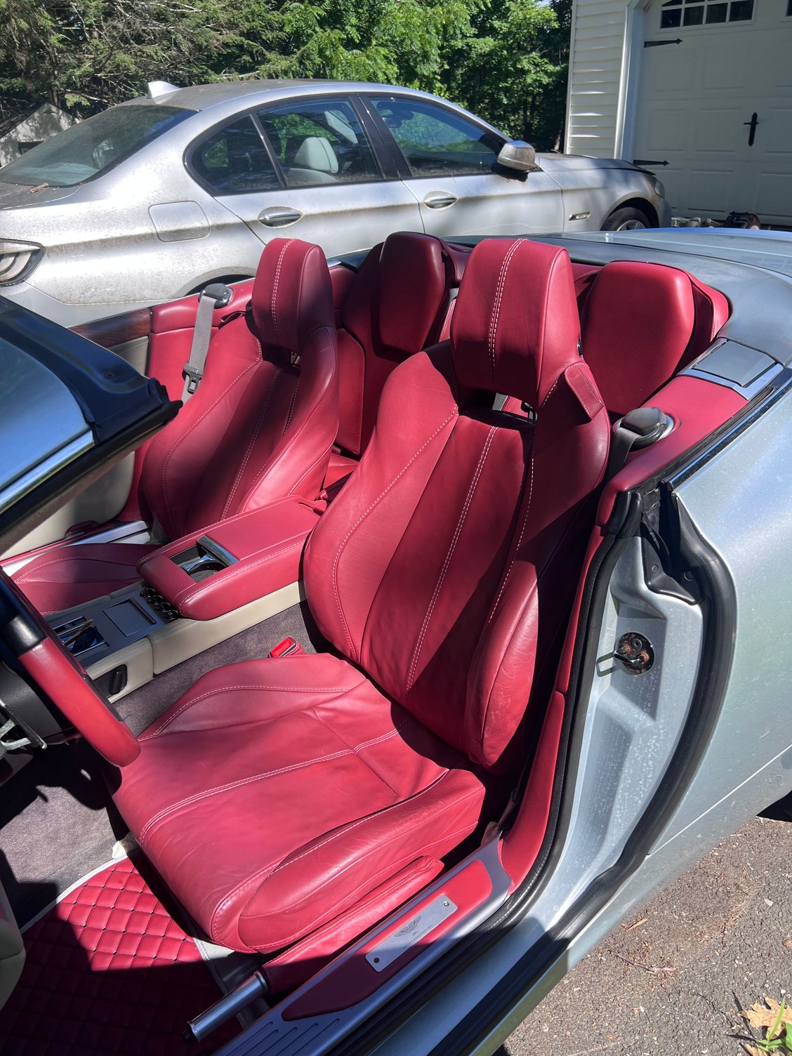

So I’ve finally managed to get the front passenger seat all wired up and back together. Bolted it back in the car and at first it was not responsive to the adjustment buttons. I’ve read about seat resets and managed to get it going. The seat was already in the most forward position. After starting the car and driving a bit. I was able to move it back and down!
But not sure if the backrest was responding. I also managed to wire up the back release button on the side of the headrest with one wire not connected at the base. Brown with orange tracer I believe. But still maintained its function. The only other thing was I did not connect the seat heater as original I believe was 2 wire and newer was 3. And I don’t like how you can see the heat strips through the leather. So I may replace the heating element at a later time. But for now I got 1 done and on to the driver side! And no warning lights on the dash (ie. airbag). Here’s a pic

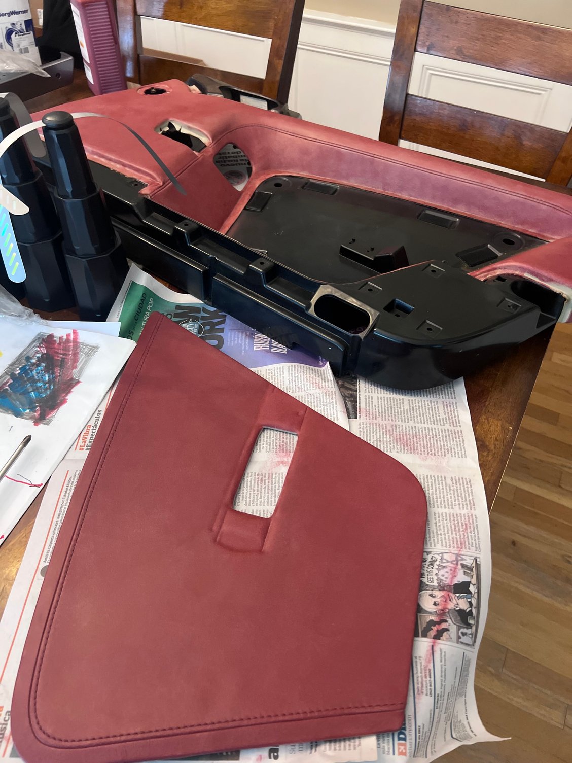

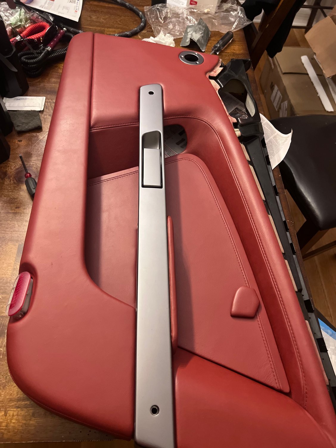

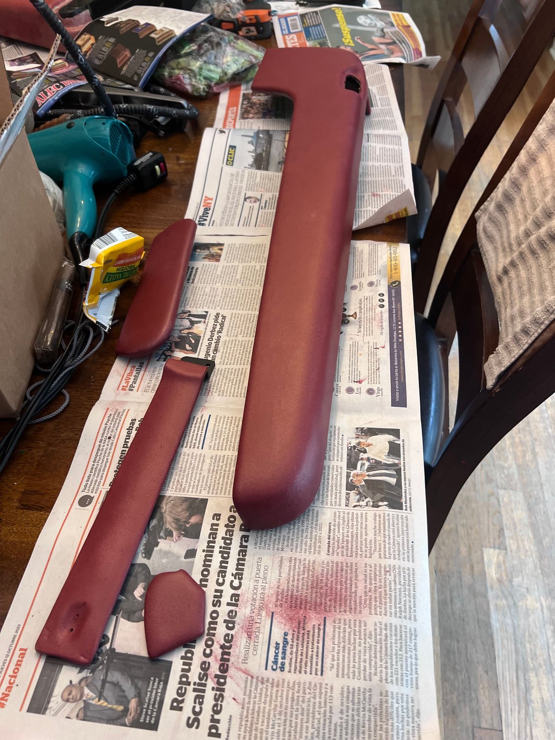

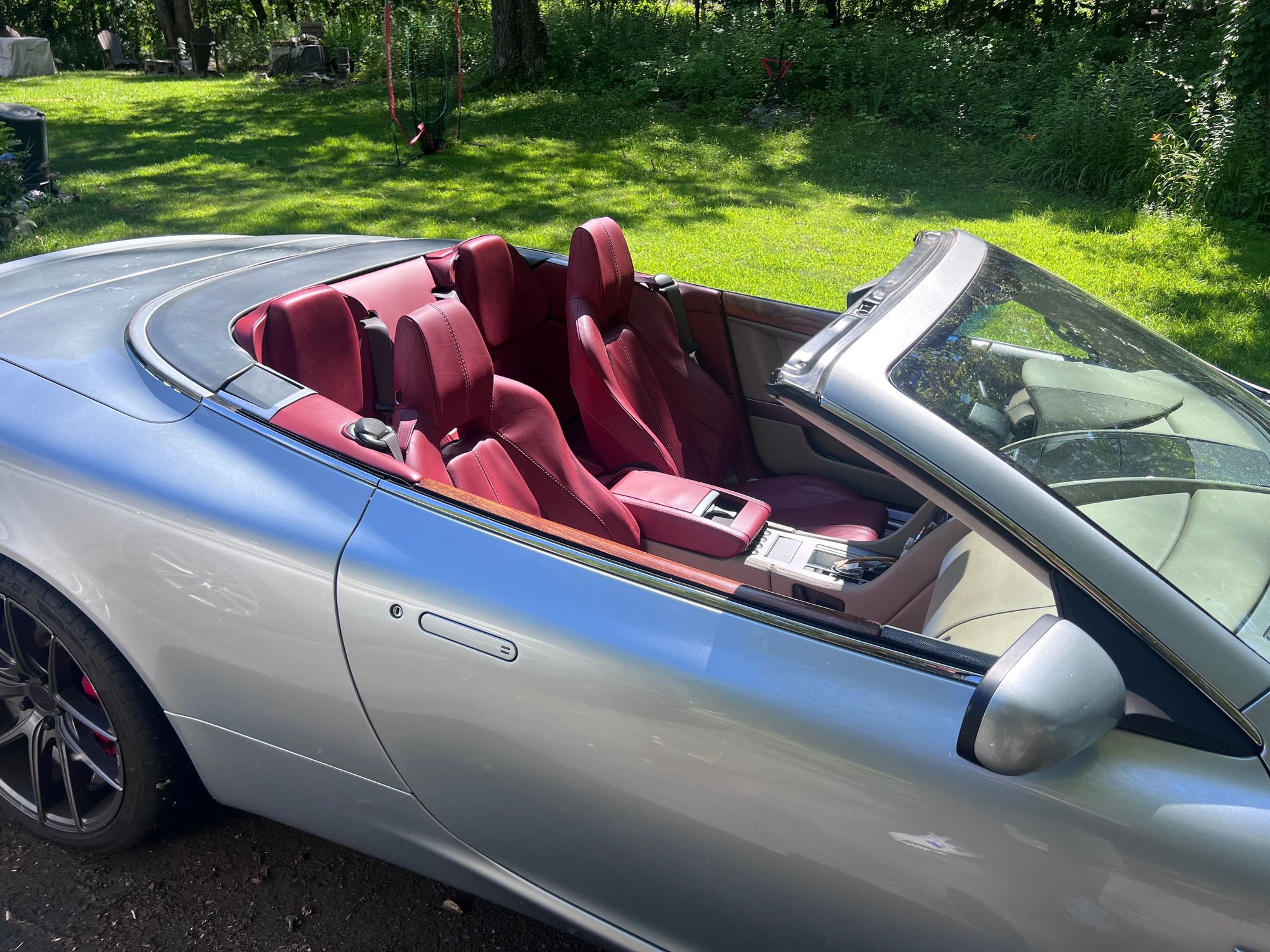

Been months as the project has been on hold. Figured I would’ve had this completed over the winter. Well that didn’t happen. And with the weather change. Recently went to a cars and coffee event with the driver seat not completed. And said that’s it. I can’t continue to leave this undone. So managed to get the drivers seat done. Which made a hell of a difference! And just got the passenger door card done today. Coming along. The dash will need a little more time. But I will get the other door card complete in the next week! What do you guys think.
