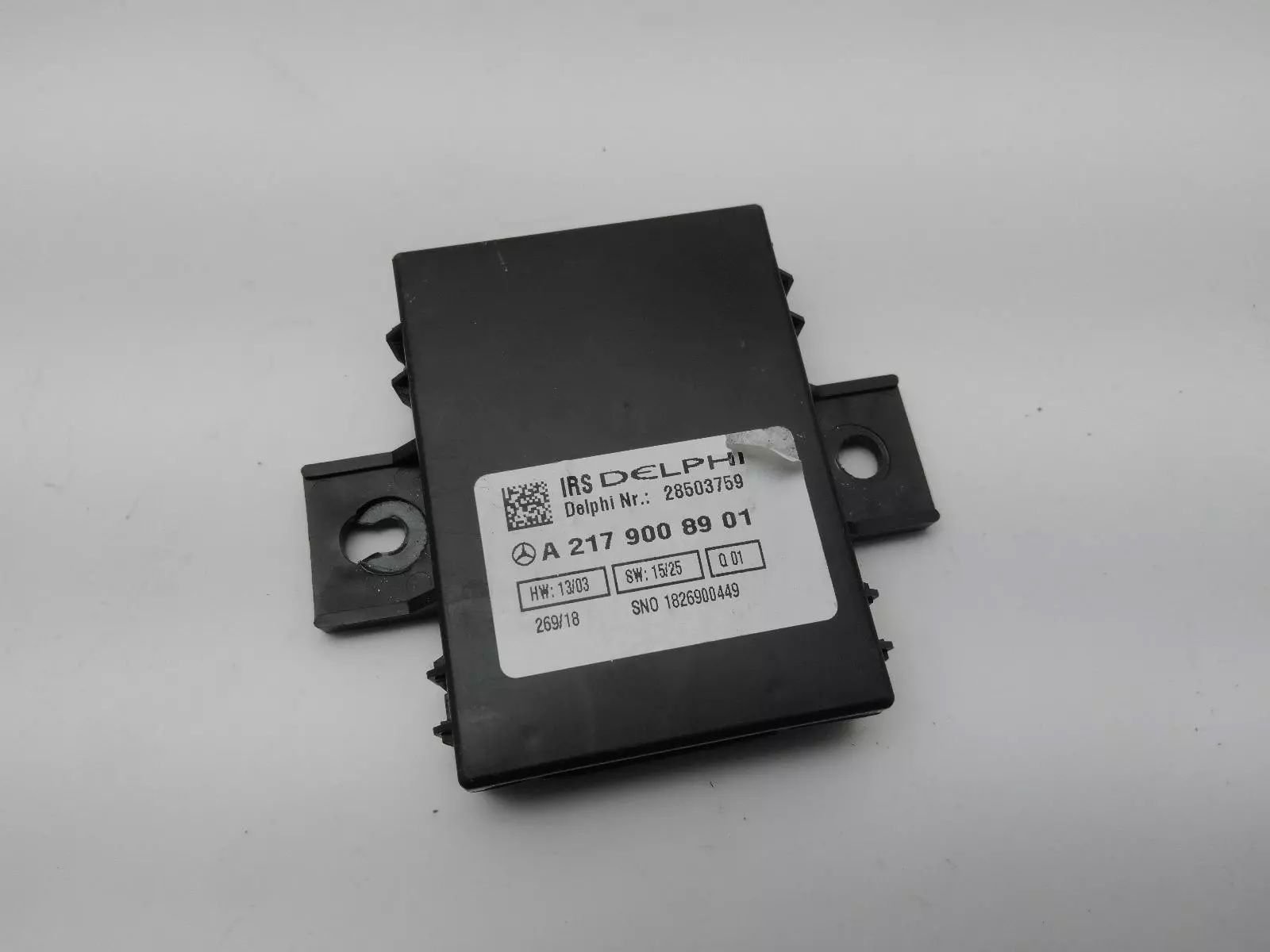

I have a check engine light come on my 2019 Aston Martin Vantage coupe for a while now. I keep trying to replace parts, but it keeps coming back on. The check engine light started off with evap code. I changed out the Evap Check Solenoid. That did not fix the issue. I changed Fuel Gas Tank Filler Neck. Also changed the Vantage Evap Fuel Rails up front. The change up front fixed the evap code, but a few days after check engine light came back on and now the code is Fuel Pump. I changed the fuel pump. Code remains. I have now order 2x Fuel Pump Modules to replace. I was able to changed the Module A0009002218. The second module is A2179008901. I have been trying to find this module all over the car and not able to find it at all. I reached out to the company I bought it from and they do not remember where they removed the part from. I even wrote to 5 other companies that are selling the same Module and none of the companies remember where they removed the part from. I have looked in the back and the front of the car. Does anyone know where Part # A2179008901 is located?

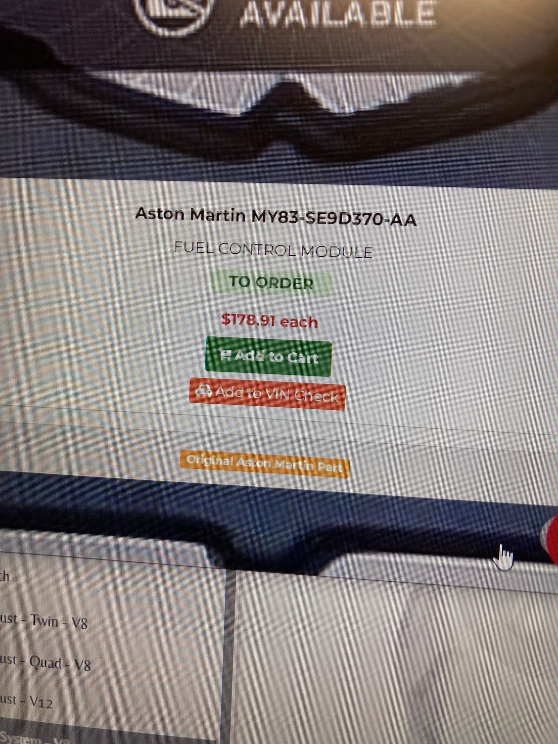

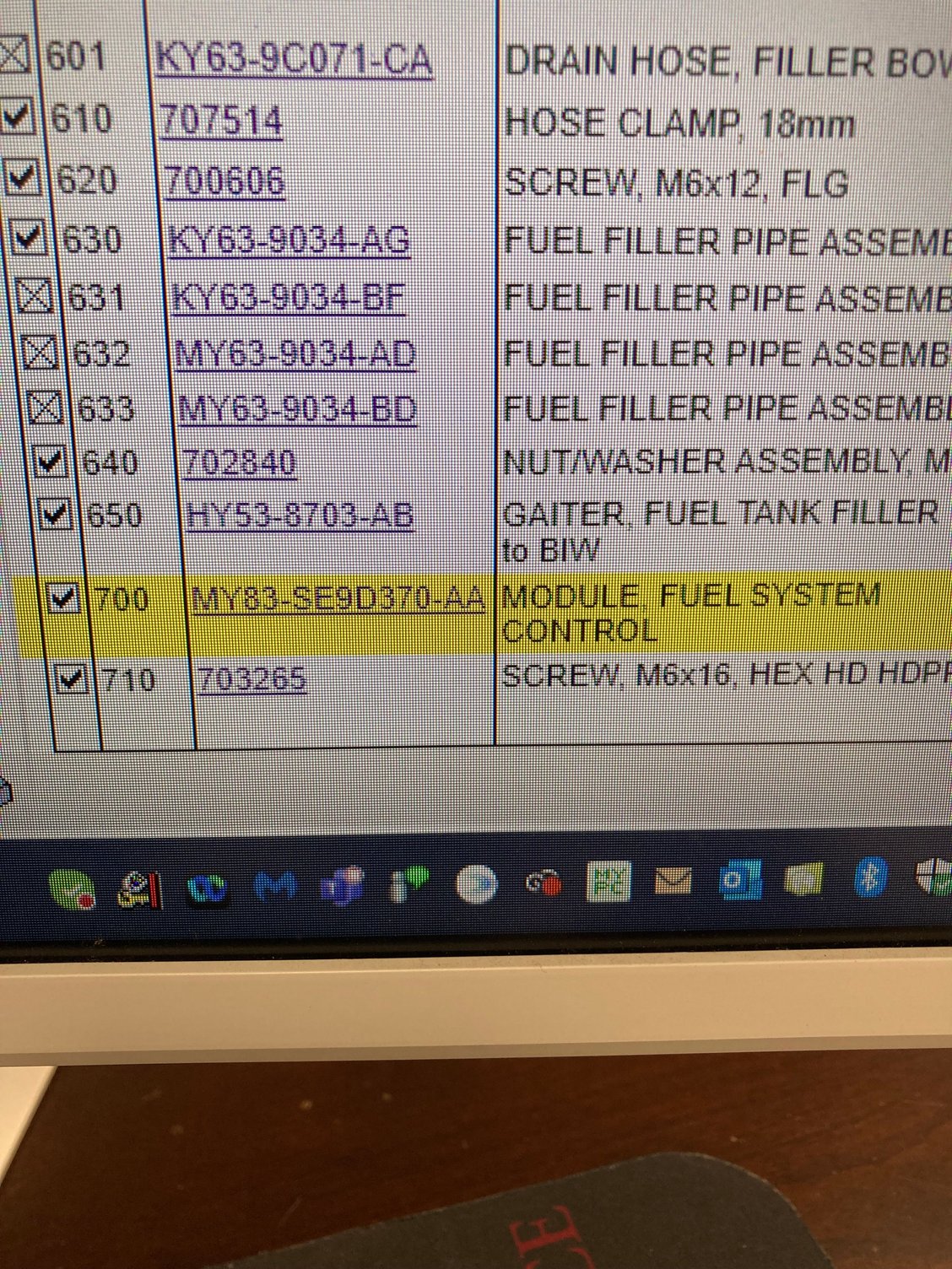

Parts fiche only shows one
Price is from Scuderia
