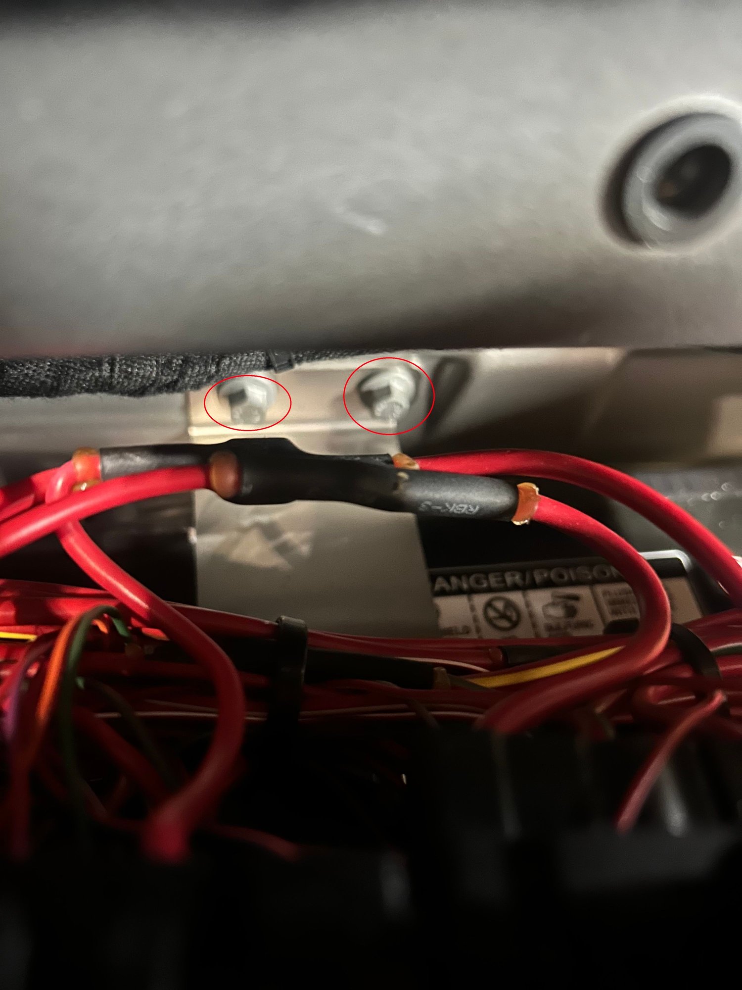

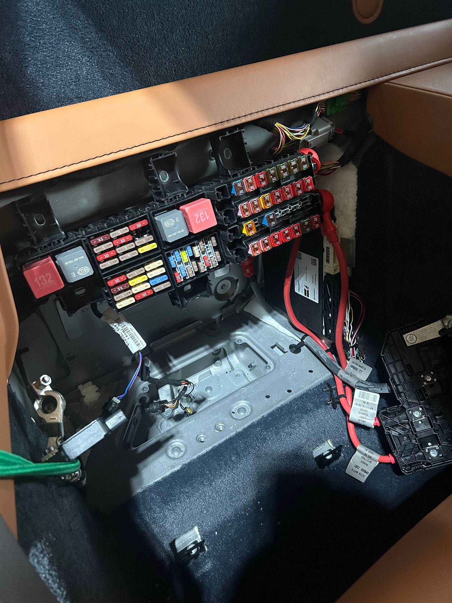

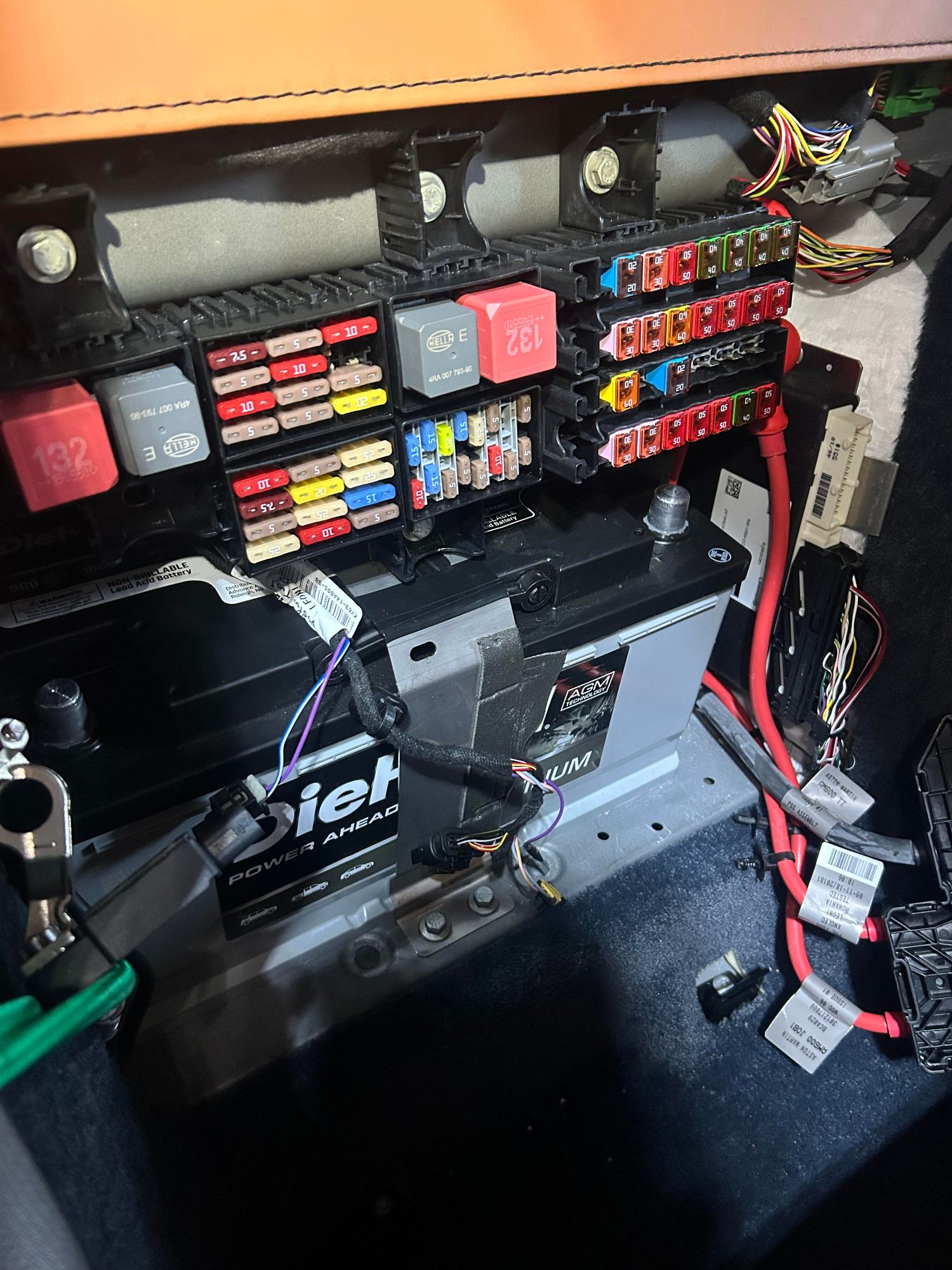

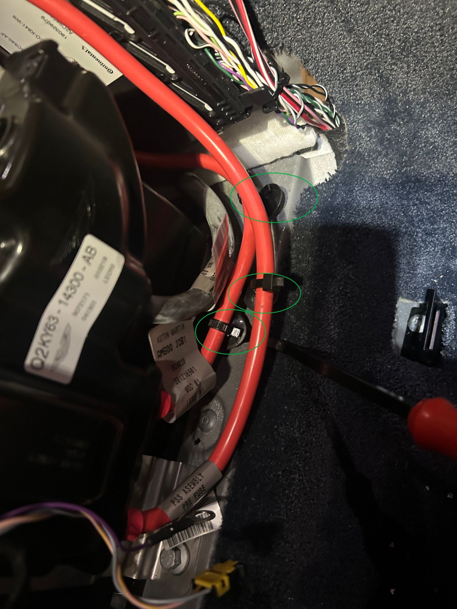

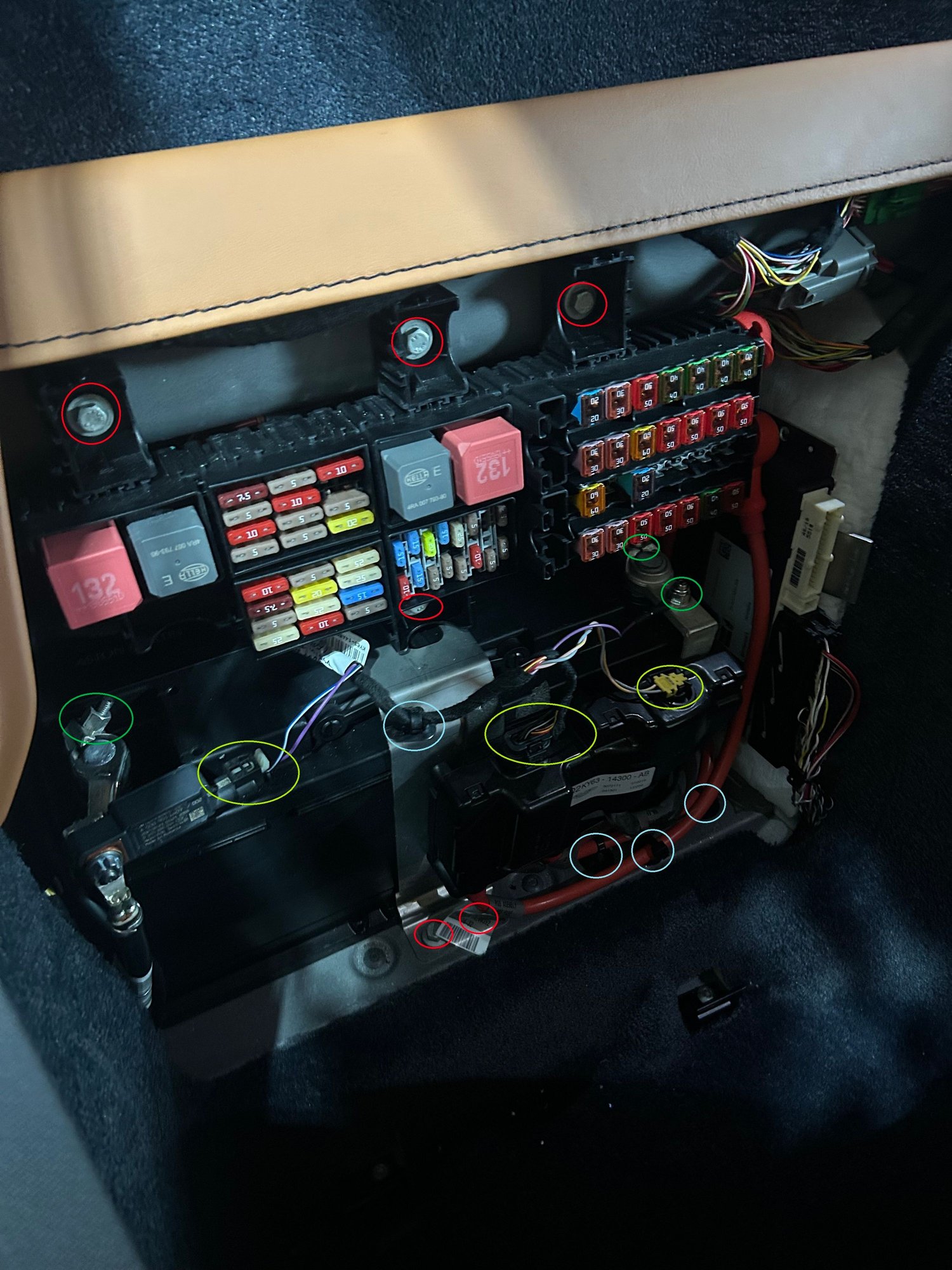

I decided to replace the battery for now and am going to schedule an appointment with the dealer to reset the air bag light and reset the camera system. Here are the steps and some photos of the battery replacement procedure.
1) First move the passenger seat all the way forward. Then pull the manual release handle at the top of the seat so you can move the seat back to the full forward position.
2) Remove the access panel by reaching between the panel and the floor and pulling forward.
3) Pop out the three cable anchors that are holding the two heavy guage red wires into the floor of the car. I used an angled trim removal tool.
4) Unplug the three electrical connections circled in lime green, and pop the wiring anchor loose that holds them to the front of the battery bracket.
5) Using a 10mm box wrench, remove the nut holding the wire on the positive terminal.
6) Loosen and remove the negative side using a 10mm wrench or small socket.
7) Using the 10mm wrench, loosen the positive terminal nut.
8) You should be able to disconnect the positive connection and move the black box and cables out of the way. I used a bungee connected to the steering wheel to pull it back.
9) Loosen the four 10mm bolts holding the fuse panel. 3 on top and 1 on bottom, fastened to the top of the battery bracket.
10) With the fuse panel loose you now have access to 2 10mm bolts that fasten the battery bracket to the back wall. I used a long wobble extension to go under the fuse panel and get to the bolts.
11) Remove the two 10mm bolts that secure the battery bracket to the floor of the car.
12) Pull out the battery bracket.
12) Move the wiring harness from step 4 back under the fuse panel so it is out of the way.
13) Use a bungee to pull the negative wire back towards the wall of the passenger side. I used the passenger side door latch striker to anchor the bungee.
14) You can start moving the battery forward now. On the left side is the vent. I used the trim tool to disconnect the vent from the battery.
15) Once the vent is disconnected, you should be able to pull the battery out. It is not easy! I kept getting caught on the carpet on the left bottom side.

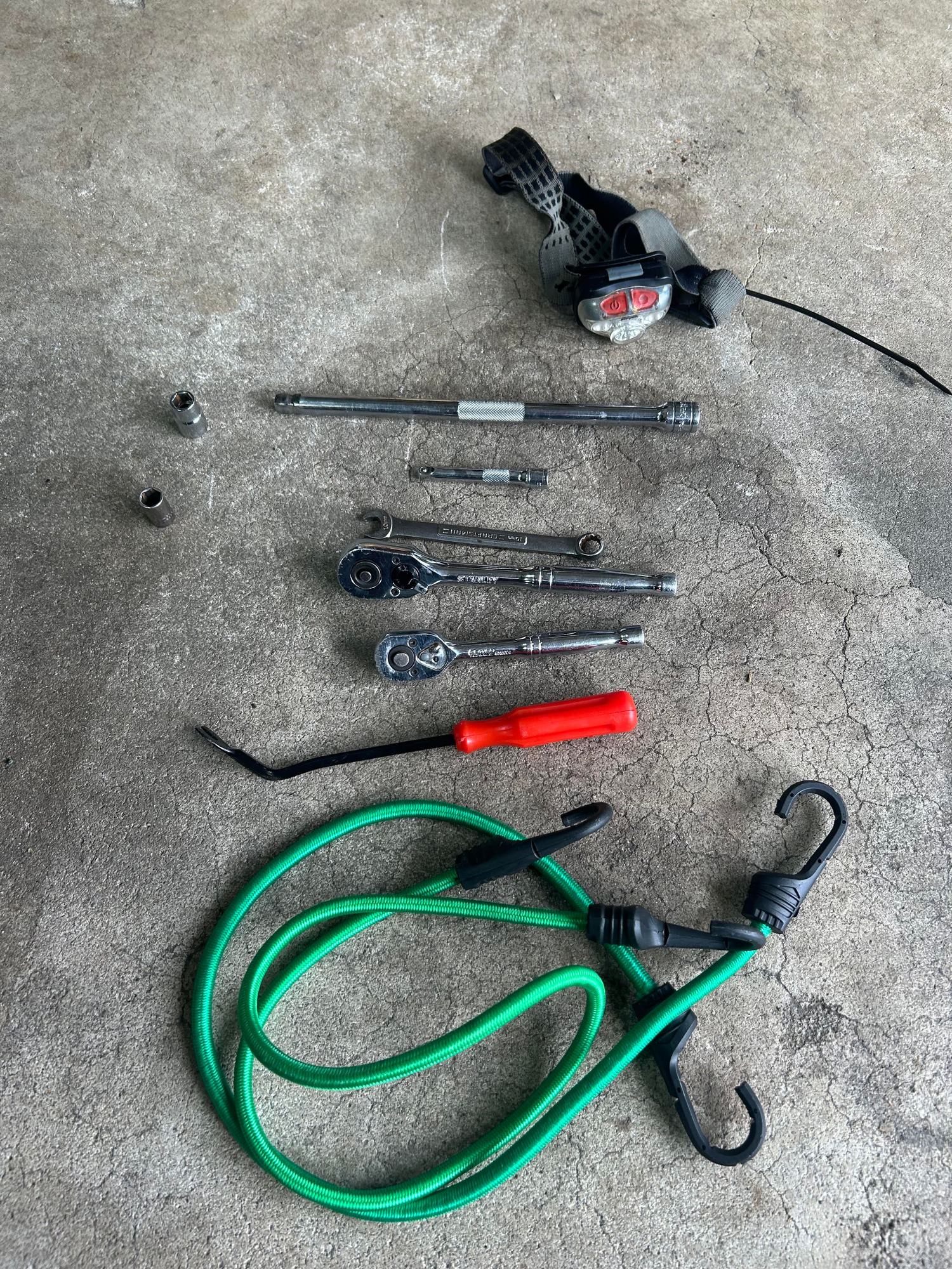

Tools used.
Tools used.
All disconnections points besides the 2 10mm bolts the secure the battery bracket to the back wall. Also the battery vent on the left side cannot be seen in the photo.
Wire anchors.
Wire anchors.
Bungee to hold positive wires.
Back battery bracket 10mm bolts. Access with long extension.
Battery removed.
Battery removed.
New battery in, fuse panel secure. Reconnect electrical components.
