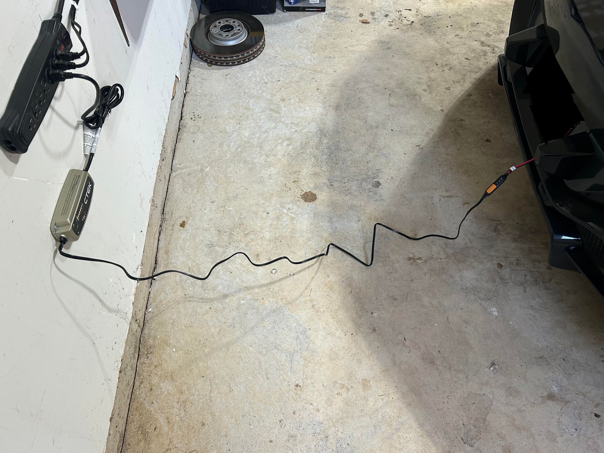

My charger and magnetic connector came in. I do plan to keep it on trickle as much as possible to avoid a dead battery and the subsequent headache. I've done a lot of searching online to see if Foxwell or Autel make a compatible diagnostic tool that can perform the SRS reset, calibrate the reverse and 360 camera, and tell the ECM it has a new battery. It looks like this is going to be my issue regarding completing any work myself. I would actually spend the 2-3K on a high end Autel model if I knew it would give me all the functionality I need to avoid the dealer. I've owned other import/exotic brands (Alfa Romeo 4C, Maserati Gran Turismo, BMW X5) and this is by far the most difficult car to find any information on. I've also had no luck finding a workshop manual which was also no issue on these other cars. Don't get me wrong, I expected it to be a challenge and this all part of the fun to me.
Links to magnetic connector and charger,
Amazon.com: JMR Adapter for Aston Martin DB11 Vantage DBX Vantage DBS Superleggera DB12 Compatible with CTEK (Magnetic Port, with Indicator) : Automotive Amazon.com: JMR Adapter for Aston Martin DB11 Vantage DBX Vantage DBS Superleggera DB12 Compatible with CTEK (Magnetic Port, with Indicator) : Automotive
Amazon.com: CTEK - 40-206 MXS 5.0 Fully Automatic 4.3 amp Battery Charger and Maintainer 12V : Automotive Amazon.com: CTEK - 40-206 MXS 5.0 Fully Automatic 4.3 amp Battery Charger and Maintainer 12V : Automotive
