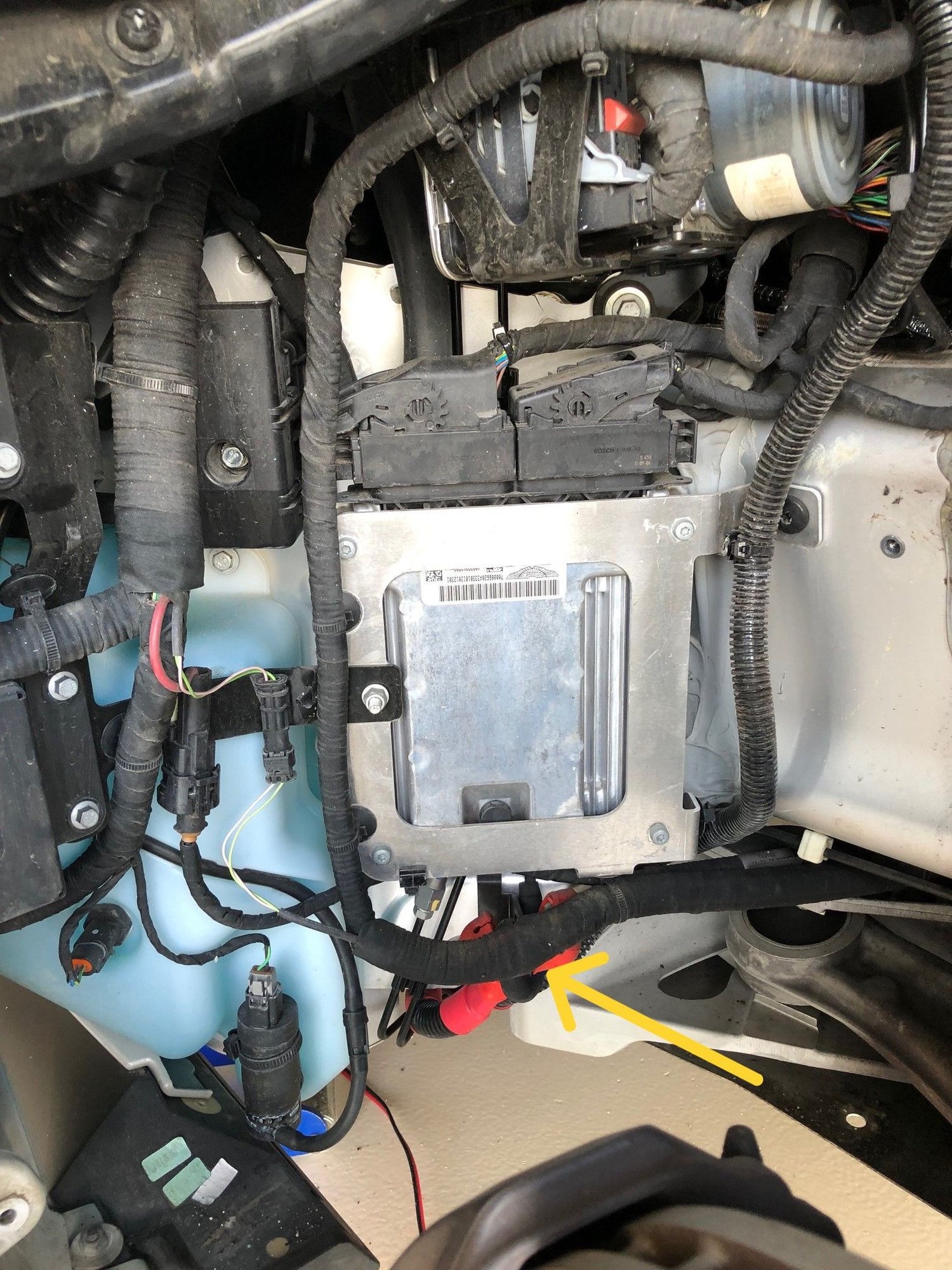

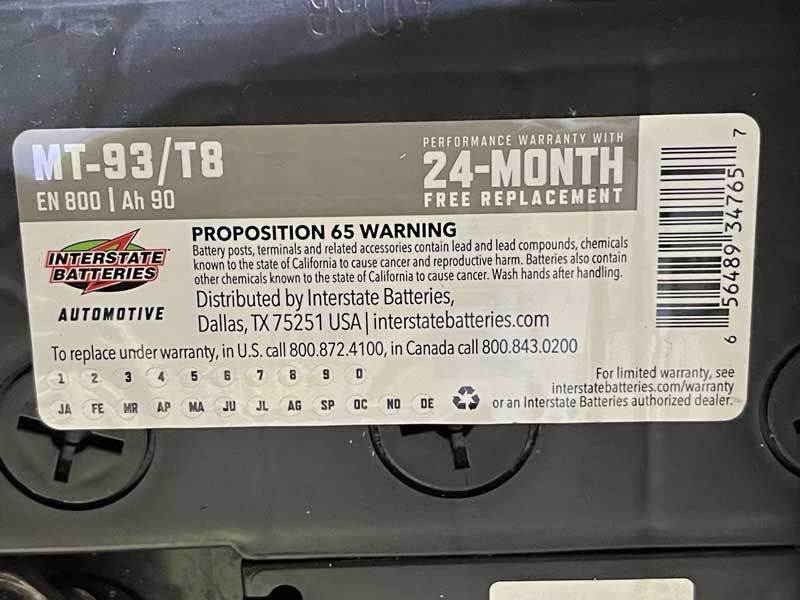

I have a 2007 Vantage and for the third time I have had to replace the battery. The battery is always on a battery maintainer, however a week ago I disconnected the battery maintainer and the battery voltage dropped to 9 volts. Charging the battery overnight made no difference. This battery was replaced in April 2021 by the dealer.
I decided to replace this battery with an AGM Duracell, available from my local Sams Club. The old battery was an Interstate T8 Ah 90. The new battery is an Duracell AGM H8 CCA 850 92Ah.
Pics below
The battery clamps (Red arrows) have been narrowed 1 inch each to facilitate removing them for battery replacement.
If you are interested in the clamp modification or the battery removal process, please PM me for the website address.

I found a problem with my Vantage that was causing a lot of electrical issues, including an apparent battery drain. You might want to check what I found to see if you have the same condition.
Put the car on a lift or jack stands. You'll see that the right front inner fender liner extends rearward along the bottom of the car. Remove the Torx bolts that hold the aft-most section on. Above it, you'll see a stud with two cable terminals on it (see photo below). This is where the positive cable from the alternator connects to the positive cable to the battery. In my case, the nut that holds them on the stud had vibrated itself loose and fallen off at some point, and those two cable terminals were barely touching each other, certainly not enough to adequately charge the battery while driving.
After putting a new washer and nut on that stud I never had any electrical issues again, and I found I could go 2-3 weeks between drives without a tender on, and the car started up just fine.
If you can find the post I made about this a couple years ago it has the size of the nut needed.

13mm nut, and on the top side is the other connection you want to check also. It's directly in from of the CEM (fuse box/control module) also for corrosion.

Referencing post #4, this is very coincidental, but I had the right front wheel well opened on my 2018 DB11 V12 and the same high voltage positive "lug" exists there too, where the positive battery cable connects. Funny thing, I was in there to change out the passenger's door compression cylinder, saw that terminal and instinctively checked its tightness. Good advice!
