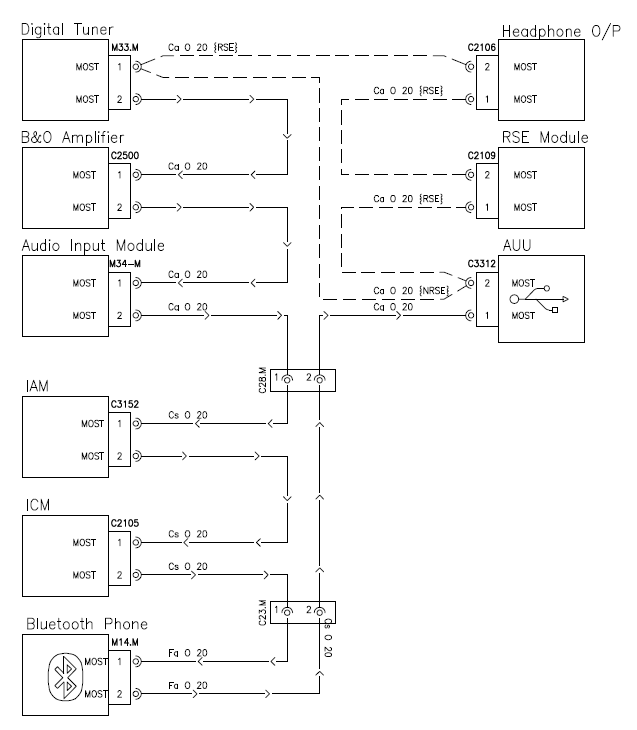

It's hard to tell from the parts diagrams, but it's possible the AUU is under the center console in the rear. The AIM is for the Garmin nav computer to get audio onto the MOST bus as far as I can tell. It should be near the nav unit. The behavior you're seeing with the MOST LED transmitter is normal from what I've seen when the bus is open/broken. Most MOST units only transmit continuously when the bus is whole. Otherwise they're sending intermittent keepalives to the next module on the ring to try to wake it up. You're taking the right approach to troubleshooting the bus. Make sure all modules have power and bypass them out of the ring with the fiber loop connector one at a time until something changes.
This diagram shows the direction and order of the MOST bus in the Rapide.
That's excellent thank you! I was trying to look for a diagram just like that to help trace how everything is tied together in the line.
