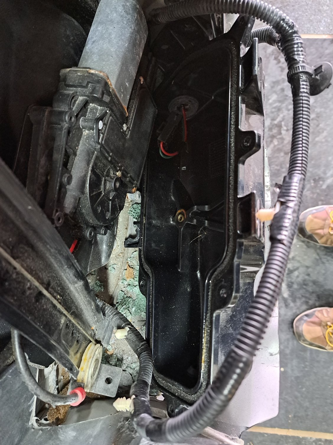

On my DB9 Volante I have a frozen latch for the deck of the top. It is in the closed position and I can't get it to open. Any ideas on how to fix that without having to dismantle the motor that is hidden behind the rear window motor?
Thanks
Francis
[img alt="Hete is the gap
"]https://cimg8.ibsrv.net/gimg/www.6speedonline.com-vbulletin/2000x1504/17360697689164068050493634740169_26616f0bcd6e8d270 f7580ebd690196f7afe8445.jpg[/img]
Here is the gap
Motor assembly taken from my parts car. I had to pry it from behind the window mechanism...

I thought about it but the motor is inside a plastic box in two parts screwed together. 7 screws 6 of which are hidden by the widow motor/ mechanism.
The screwed panel on the box is fairly flimsy and could be cut with a cutter knife and glued back but it would be messy and still behind the window motor.
I may have to resort to that in the end.

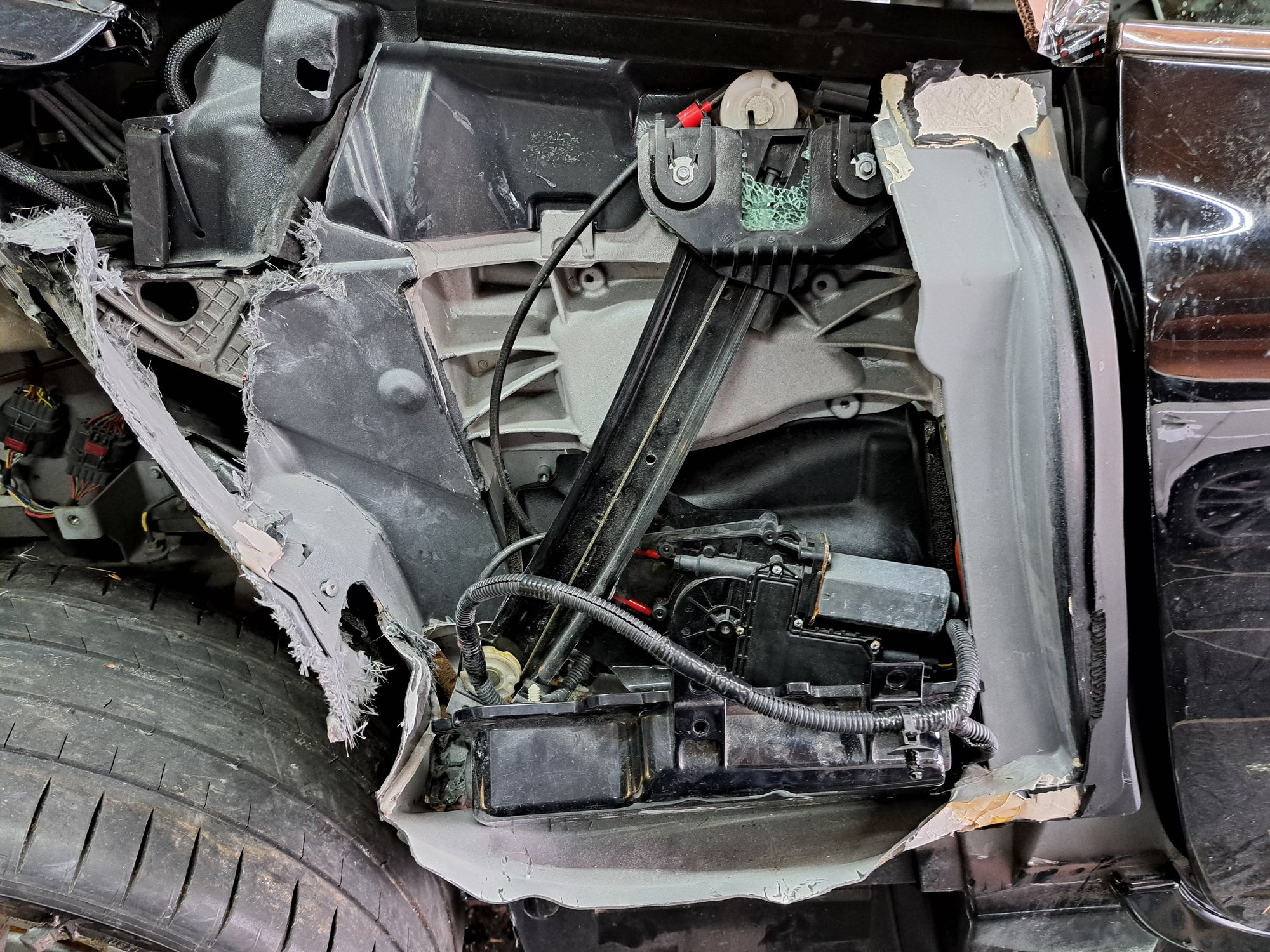

Pictures of the rear-end damaged car.
