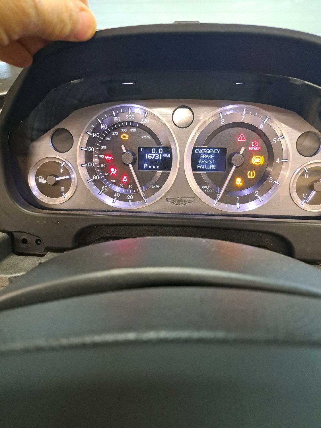

Just did a few things today and here are the results:
Went under the car to put direct power to the starter motor. I don't know if I did this right but I put power to the positive and negative and got the starter motor to crank but it did not engage the 12 cylinder engine...
Did I do this right by just putting a power red from a battery to both pins if the starter motor?
I also permuted both CEM and DIM's and the results are interesting.
DIM from flooded car paired to damages car's CEM and I get the same result as with DIM from damaged car and CEM from damaged car. I get power to the car, it lights up but won't crank the motor.
DIM from flooded car paired to CEM from flooded car and I get a "key detected" message with the damaged car's key!!! Not with the flooded keys...
In bonus, the cd player and the radio both now work. That was probably a bad connection with the CEM before. The radio and cd did not work prior to that on either cars. So some progress but no crank yet.
DIM from the flooded car with 16 731 miles
DIM from damaged car with 29 790 miles on it.

From what I understand about the mileage from Volvo cars (the Aston is basically a Volvo when it comes to the CEM) you should be able to swap in a lower mileage or virgin DIM and when the car is driven the CEM will update the mileage to the DIM. If the mileage from the CEM is higher than the DIM, the DIM will update to reflect the correct mileage. If the DIM is higher than the CEM, the DIM will add its local milage to the CEM milage resulting in 46,521 in your case. The DIM can never "roll back" on its own. I was faced with a similar situation when I bought a low mileage DIM to replace my 59K mile DIM that had a damaged LCD screen. I chickened out and ended up performing surgery to transplant the good LCD into my old DIM so I can't say for sure what will actually happen.
The keys are paired to the CEM and the PCM(s) so they have to match. The VIN is also programmed into the CEM and both PCMs. If you swap them without reprogramming the module VINs will never match the chassis. I don't think anything but an AMDS can do this and you'll definitely need an AMDS to pull the car config from the flooded car's CEM to flash to the new CEM. You might be able to send both cars' PCMs and CEMs out to be cloned, but the flooded CEM needs to be recoverable.
