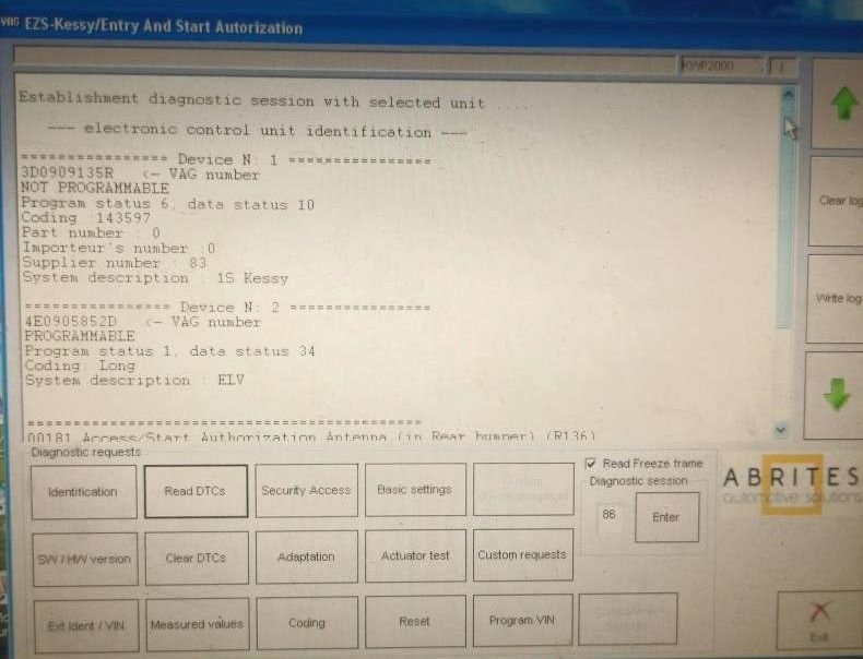

Hi folks,
Can anyone help me on how to reset alam on my 2005 Bentley GT
Due to some faults the alarm is always activated and I have Immobilizer activaed as well and cannot put ignition on and start.
I have 3 genuine keys and all behave the same.
Can anyone help me.
These are the tools that I have:
- VAG KKL cable
- ODIS Version 4.4.10 (my interface Vas 5054a is bad) I have ordered a VAG COM HEX V2 20.4.1interface that will come with Vcds in the next 10 days
- SKP-900 Key programmer-
- FVDI 2014
- Mini900
- KeyDiy KD-X2
- SBB
- Digimaster3
- Zed-Bull
- CarProg
For now please find attached the result of the diagnose with FVDI
Thks in advance
Best regards

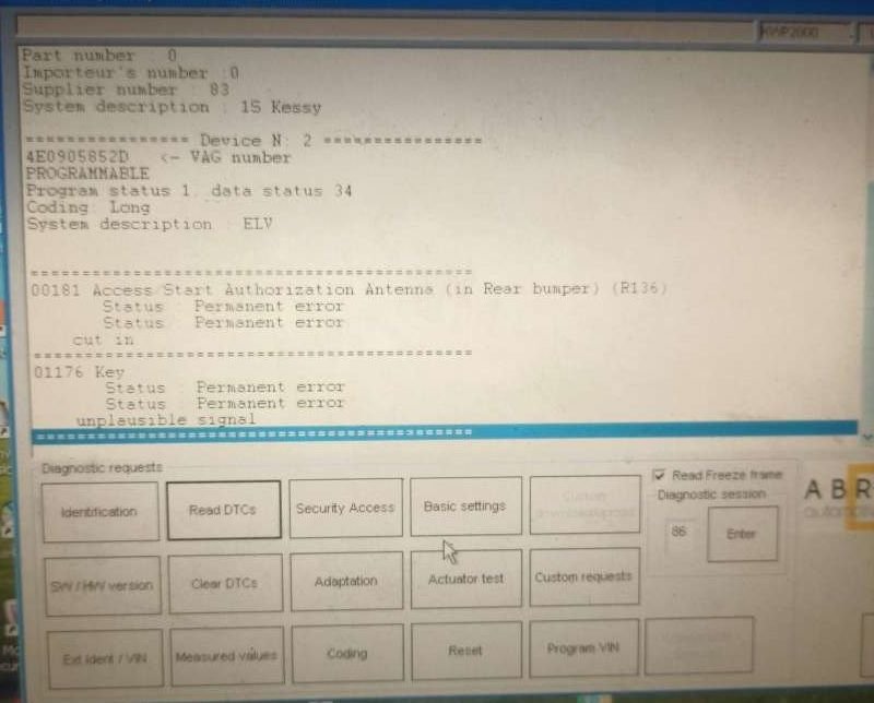

@kilog ,
Please give us some more details about anything that has happened to the vehicle prior to this issue, the IMMO does not keep the engine from cranking over and starting, it allows for it the start, but then kills the engine in about 2 seconds.
Have you pulled the carpet up to expose the KESSY module to be sure that it is not sitting in a puddle of water, this has happened to a few here.
Any other issues or parts replaced, as ALL the following items must be matching from the same vehicle,
Keys, ignition switch, KESSY module, steering column, and both twin engine ecu's .
Your rear bumper antenna fault should not keep the vehicle from starting.
EDIT: ​​​​​​@kilog ,
You say that the alarm is always activated, do you mean that it is always armed, as in the alarm set blinking red LED's in the door panels are flashing, you can disarm the alarm system by putting the key-blade into the door lock and giving it two turns to you left.
Johnny

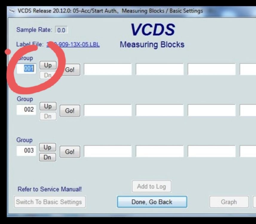

Originally Posted by kilog
Hi Johnny
After
[Select]
[05 - Acc/Start Auth.]
[Meas. Blocks - 08]
Ib the capture attached this what I have
and as you can see there is no room to
Select bloxk 81
Please help
@kilog ,
Hit any one of the up buttons to get to block 81, 22, and 23.
Johnny

Or just type "081, 022, or 023" into the box.
