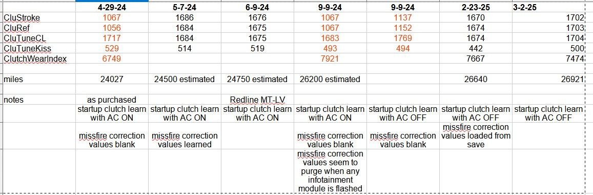

speak to Chris at VAP.
those wear index values are nowhere near mine
be sure to do your engine start clutch learns with AC off
for reference, here are my notes

if you look at my readings, about 30 counts from the encoder for just over 2k miles. VAP says 2000 counts is max (for the encoder or software i'm uncertain). since the ASM will one day determine the clutch is worn and prevent you from driving it, the common wisdom is that at 1800 you are entering the danger zone and need to think about replacement.
15 counts/1000 miles of my driving and it went from around 1300 to 1700 in 24k miles by the previous owner which is 15 counts/1000 miles.
by these rates i have about 6-7k miles before replacement.
i drive pretty easy and just cruise, try to avoid stop and go traffic and sometimes punch it to pass trucks on 2 lane roads.
does that help?
