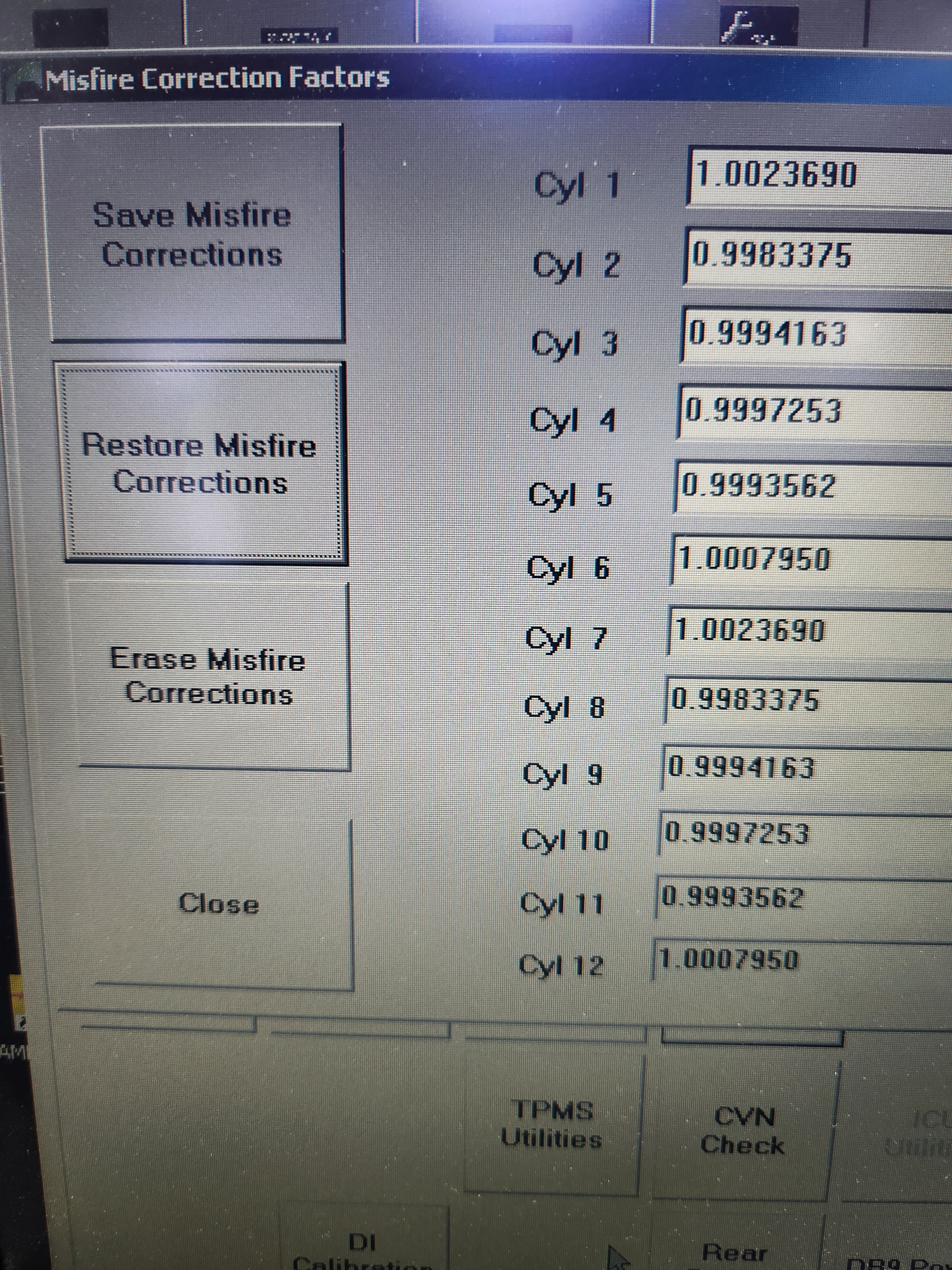

Cleared corrections is easy, the learn could be involved but you definitely need an AMDS for the clearing.
I really gotta find an AMDS to have at home - that looks much easier than BMW's ISTA.
