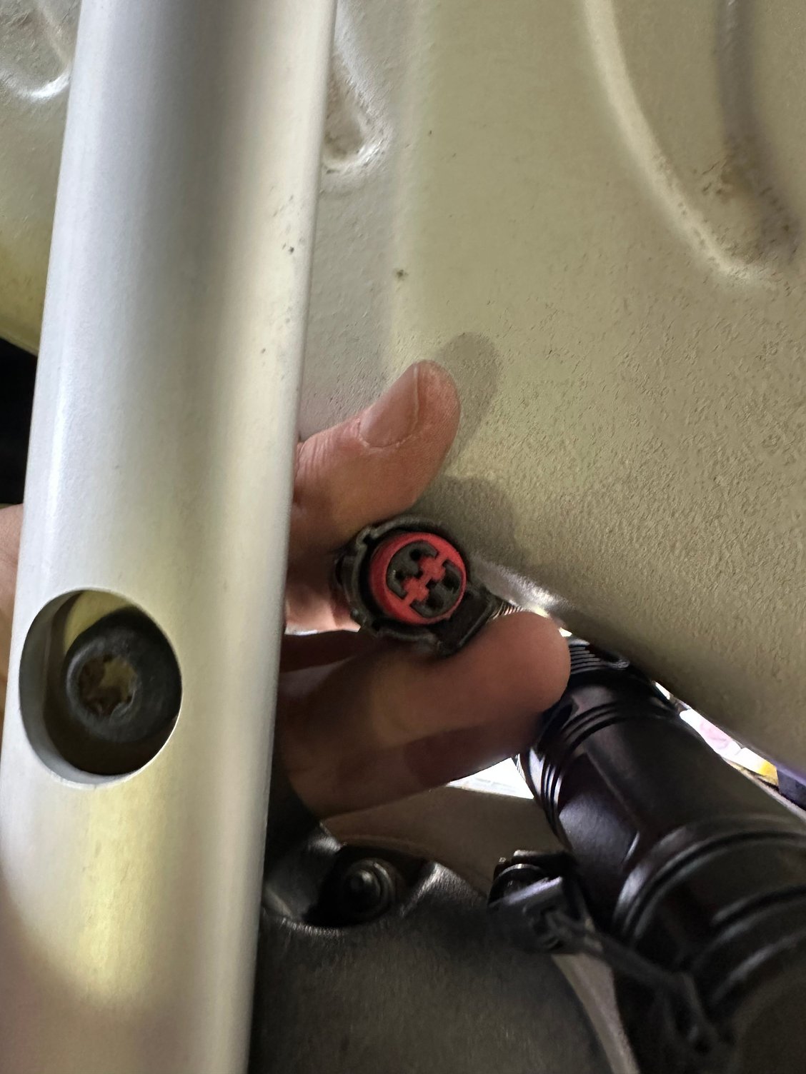

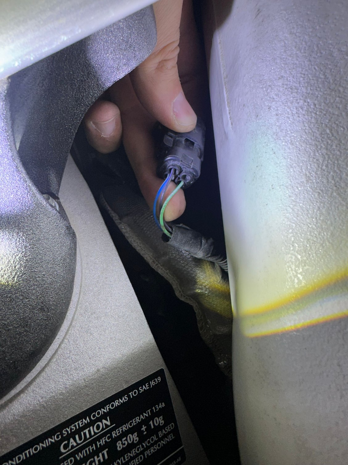

Hey,
After getting my car serviced, the A/C stopped working. I checked under the hood and noticed an unplugged cable, but I'm not sure where it's supposed to go—or if it's even related to the aircon. Could someone help me identify it or point me where to plug that?

The second photo looks to me like an O2 sensor connector…

In the end, it turned out to be the cable to the A/C cut-off switch—it was torn and needed replacement, which is why I couldn’t see where to plug it in. thank you for help!
