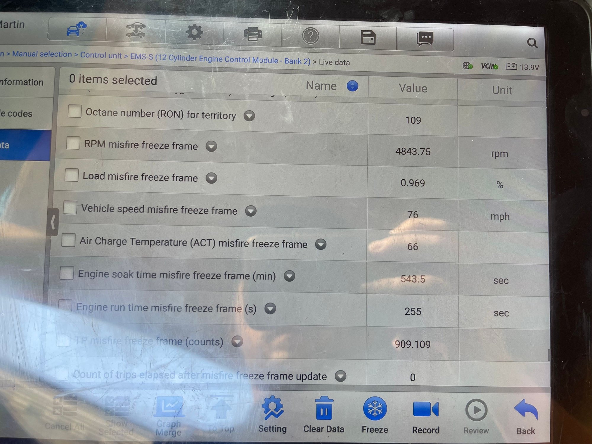

Small update:
I’ve had a chance to review more data, and do plenty of driving. I was able to replicate the hard stumble on acceleration/downshift while logging data.
Really nothing conclusive was found.
However, this morning, I put it to the floor at highway speed, and it misfired bad enough to trip a CEL, and set the emissions and drive slow service urgent warnings. I let off, and after cruising less than 15 seconds, the light and warnings shut off. The car drove normal and smooth the rest of the way to work.
Checked codes and data as soon as I got to work. P0309 (no surprise, based on previous misfire counts)
The plan now is to swap cylinder 9 coil to a known good OEM this weekend. I am also going to swap cylinder 9 injector with cylinder 10, just to hopefully rule injectors entirely.
Unrelated to the misfires, but possibly related to drivability, I did review some transmission data as well.
I noticed something I thought was strange. Solenoid 4 in my transmission was constantly flickering between active and inactive. Key on, engine off, as well as engine in gear. That doesn’t exactly seem ‘normal’ to me, but my experience is predominantly with manuals… can anyone confirm that this is or is not normal? No codes in the TCM, but a solenoid cycling under all scenarios doesn’t sit quite right with me
