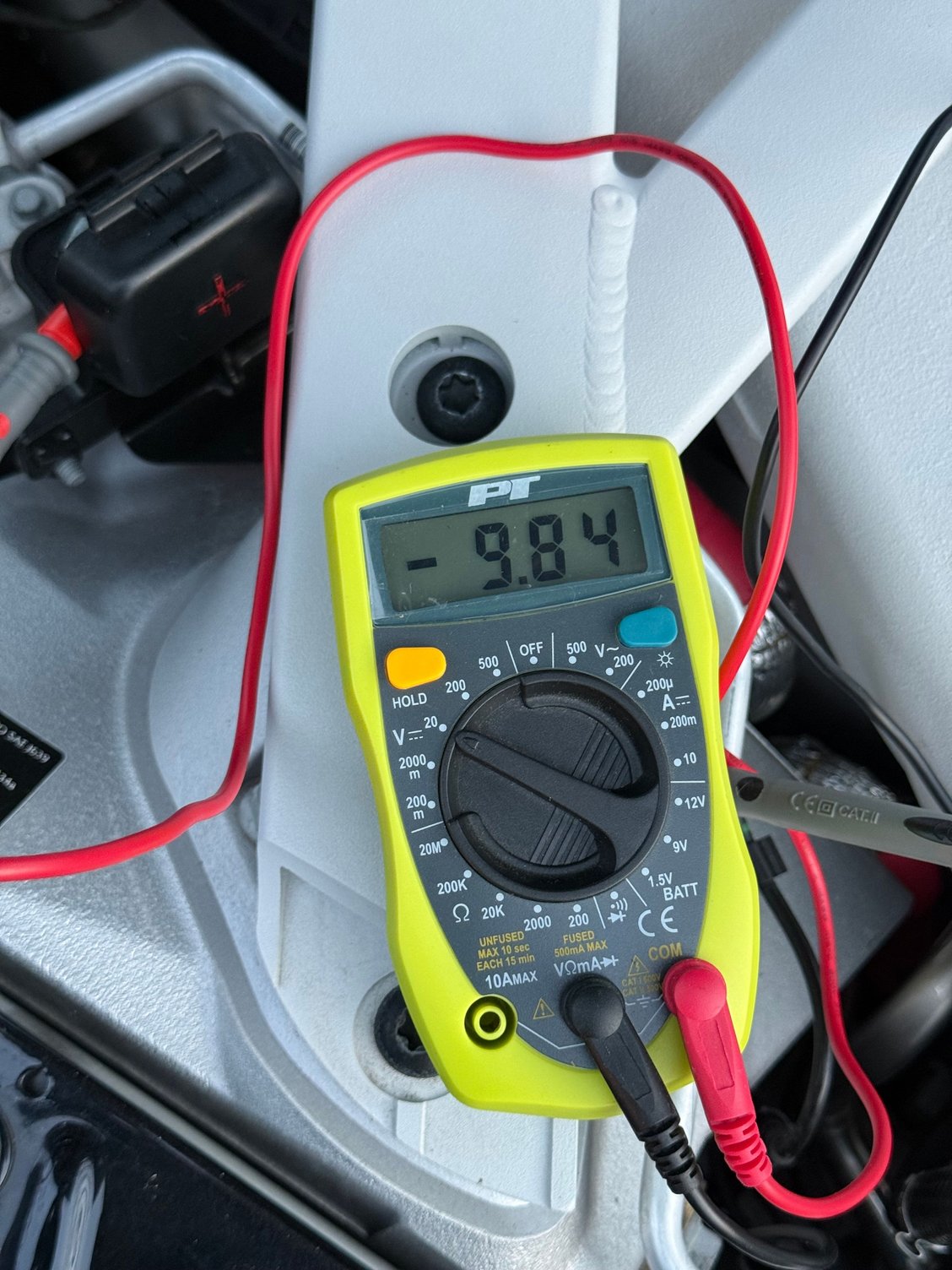

Voltmeter showed battery voltage around 9 I tried to jump the battery with cables off of a 6 cyl Mercedes suv and a V8 Tundra with a 750 CCA battery but it didn’t work. I’m going to try to install a new battery and see if it turns over.

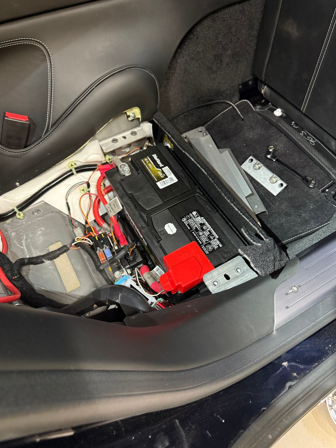

Problem is, I can’t seem to find any Group 93 T8 AGM battery in the U.S. All of the ones I found searching online are flooded batteries. H8 AGM batteries are readily available but from what I’ve read, it’s too tall for the battery compartment and the metal brace won’t fit over it. Any recommendations on which battery to get? Thanks!

I just replaced my Rapide battery a few weeks ago. It's not the one listed on the Interstate site. I learned that one the hard way. The only battery from Interstate that fits is the one that's in the car. AGM is not available. There may be a Bosch one.
The correct battery is MT-93/T8. When I told the Interstate store that their website lists the wrong battery, he said "of course it's wrong". You're right, the other batteries are too tall. I got like 4-5 years out of the last battery.

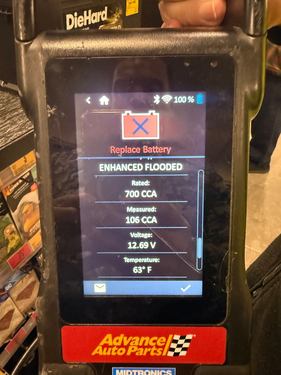

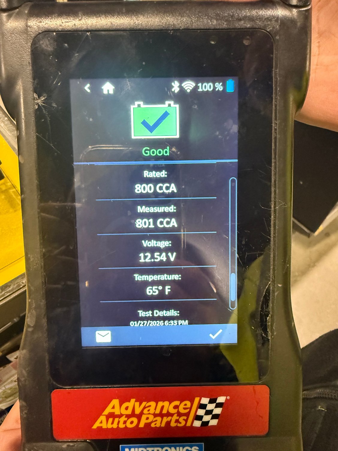

Update on battery situation. I had a friend bring a commercial truck with an onboard generator to supply 16V/10A for a few seconds to jump the car. It started right up and I was able to drive it home where I parked and removed the battery to get it tested and ordered a new one. The OEM battery was pretty much done with CCA dropping from 700 to 100 when tested. I tested the new battery before install and it gave me full CCA.

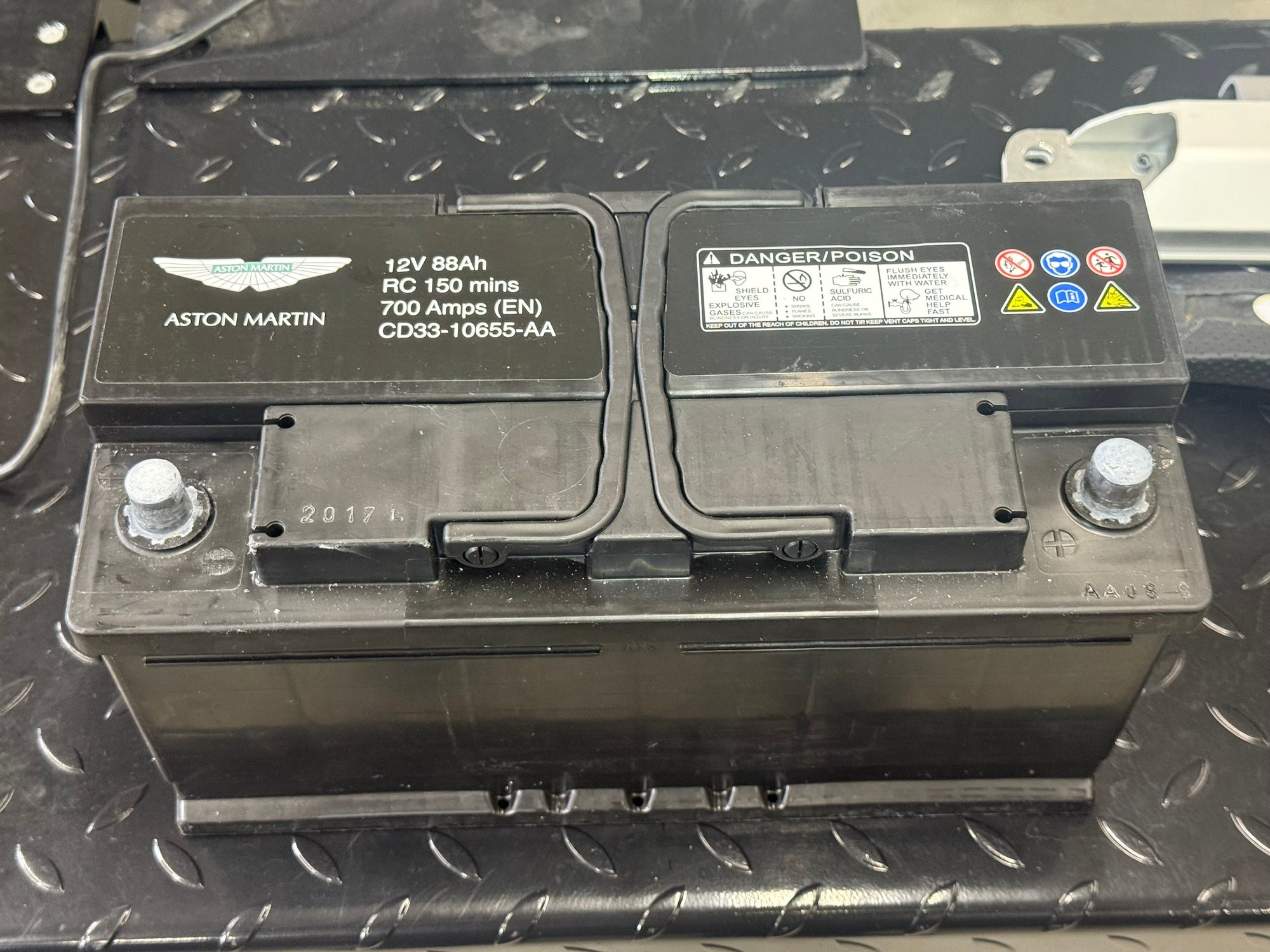

OEM battery is likely made by Clarios as well. The specs for OEM are 700CCA - 88ah - RC 150mins. Price is $520 from the dealer in Atlanta, $336 from scuderia but shipping is $250.
I decided to go with DieHard because it was the closest to OEM specs and had a 3 year warranty. Here’s a list of the brands available.
- DieHard (Advanced Auto Parts) - 3yrs warranty - 800CCA - 90ah - RC130mins. (Made in Spain)
- Super Start EXT (Oreillys) - 3yr warranty - 800CCA - 65ah - RC130mins (Made in Romania)
- Duralast (Autozone) - 2yrs warranty - 800CCA - 90ah - RC 130mins
- Duracell - 2yrs warranty - 800CCA - 90ah - RC130 mins.
- Interstate - 2yr warranty - 800CCA - 90ah - RC unknown
