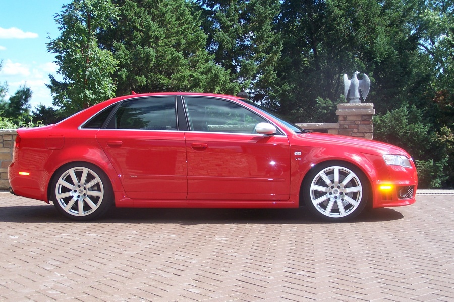

I believe the MTM Haldex unit works only with Haldex-controlled AWD systems-which isn't used in the B7 RS4, it's only in the A3, S3 and TT/TTS/TTRS. The B7 RS4 uses the Generation V Torsen T3-here is mine with MTM's supercharger kit, sitting on Stasis Ohlins:

you are right, i thought Audi did use a Haldex derivate in the QB6 as well.
so a good suspension kit + maybe a pair of stabis should do the trick.
nice car btw, RS + MTM is a great combo.
