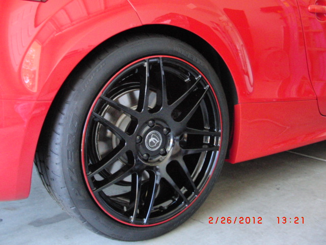

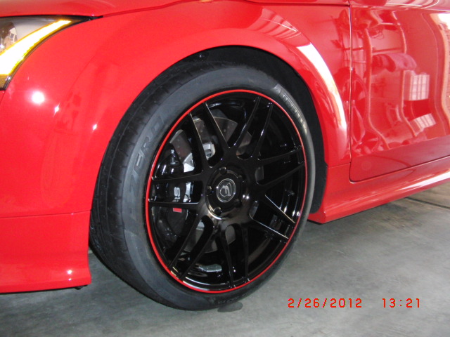

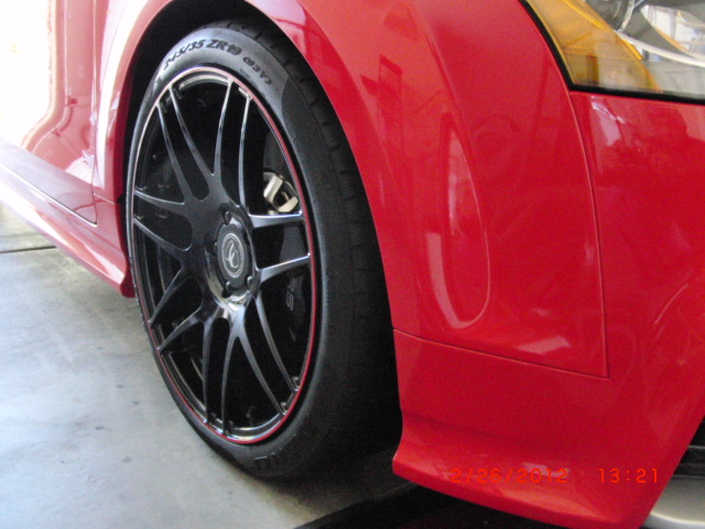

Forgestar F14's 19x9 with 45mm offset.PZero Trofeos 245/35-19. Wheels rub slightly on frt calipers . Ordered 3mm frt and 5mm spacers this AM.Other parts waiting for install are the forge intercooler,H&R sways and springs, short shifter,brake pads,Haldex race,tranny mount,swaybar links.

Installed 3 mm spacers on front wheels today -
no more rubbing. Got the H&R springs on - drop is perfect.Rear sway bar on also.Rear drilled rotors and Pagid pads installed.Haldex race installed w/ RF remote.DieselGeek short shifter does not fit TT RS tranny so I'll work with them on return and hopefully getting right part.Forgestars and PZero Trofeo's are much lighter than stock wheels and RE11's - stick like glue!Going to do the tranny mount ,front intercooler ,brake lines and Motul this week along w/ frt sway bar and then realign the suspension. Scorpion exhaust is on the way from England - hope to have it in another week -10 days.Mods are coming together!!

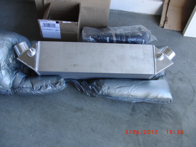

Got the Forge intercooler installed along with the Scorpion exhaust and HPA tranny mount.Trying to break free to drive out to Irvine for the GIAC extreme file.Hopefully by next Monday! Forgestars are more like 22 lbs and the factory wheels are over 30 lbs. Forgestars and PZero Troffeos are way lighter - I'll weigh both before track time the 14th and 15th.Have a Osensor code w/ the 100 cell cat on the Scorpion so I'll be installing bigdaddies minicat cell fix tomorrow or Wed. Still no front brake lines so I'm ordering from Europa Parts tomorrow. Also waiting for DieselGeek to finish up the short shifter. Jim has looked at a local car and I supplied the factory part he need to diplicate so the shifter should be available soon.
