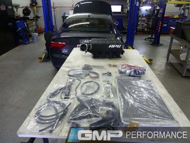

First things first, getting all the parts out of the box and ready to go.

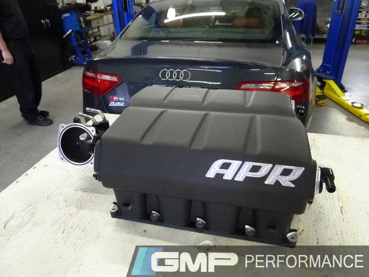

The 44lb chunk of aluminum that nets this car a 150hp gain! For the record, it is only a 26lb increase over the stock manifold.

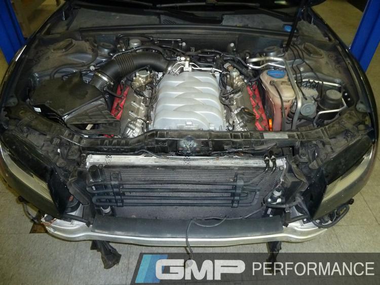

A before shot of sorts

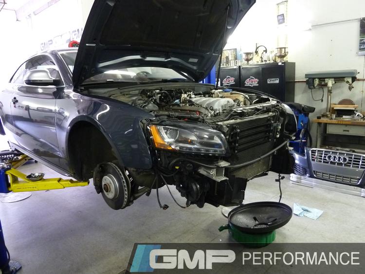

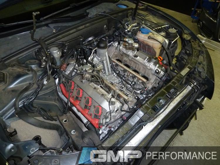

Tearing it down

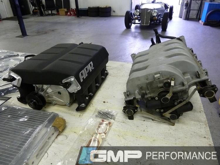

The stock manifold sitting next to the APR supercharger

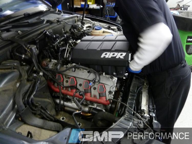

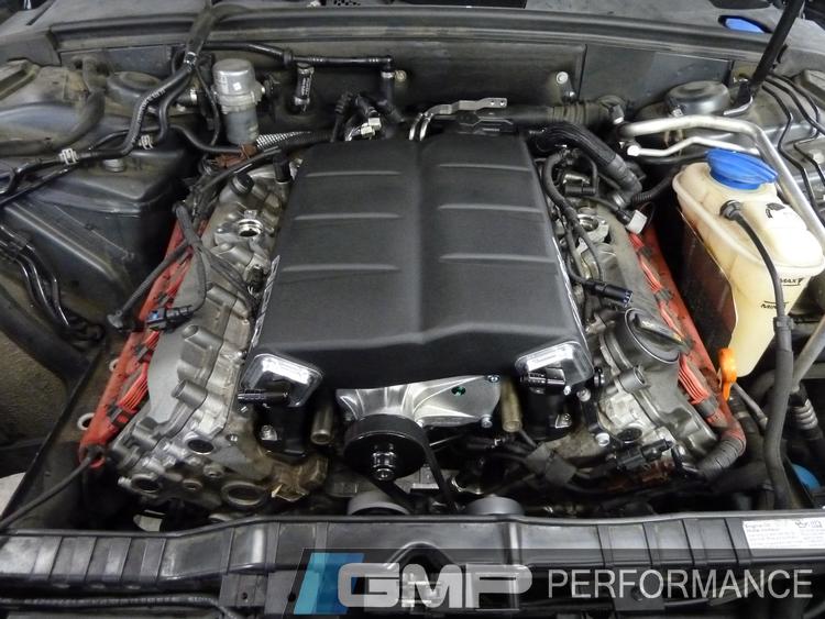

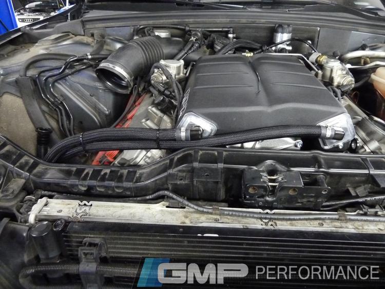

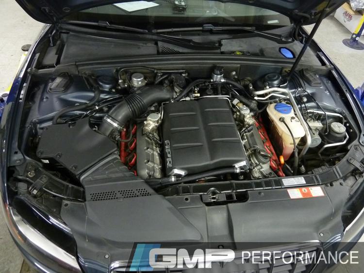

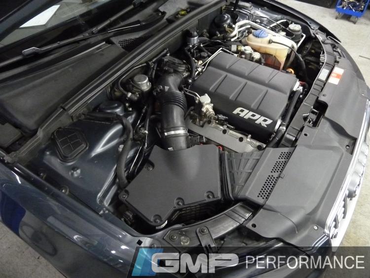

Now the real fun begins. Its time to get the supercharger in place.
Supercharger is in and time for assembly

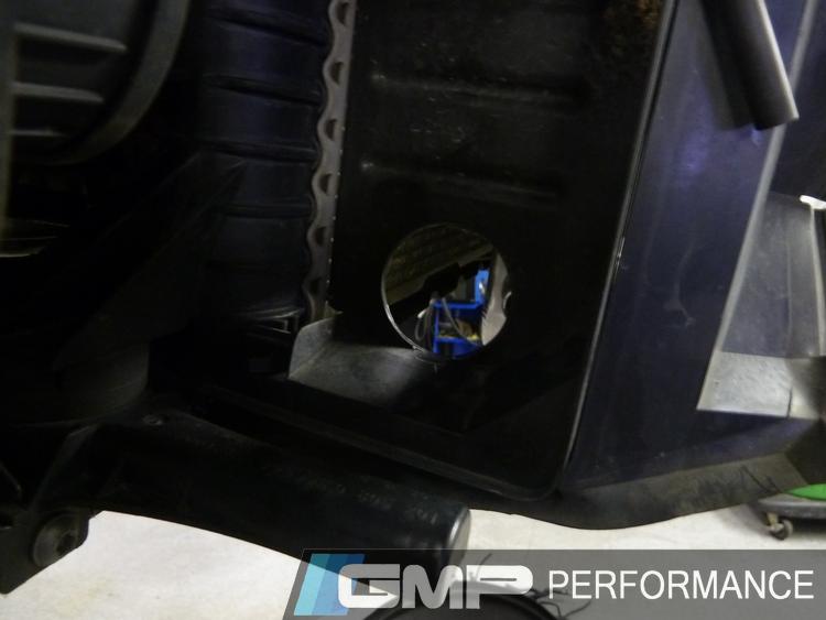

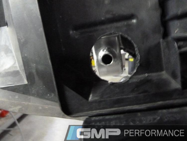

The holes drilled for the supercharger coolant hoses

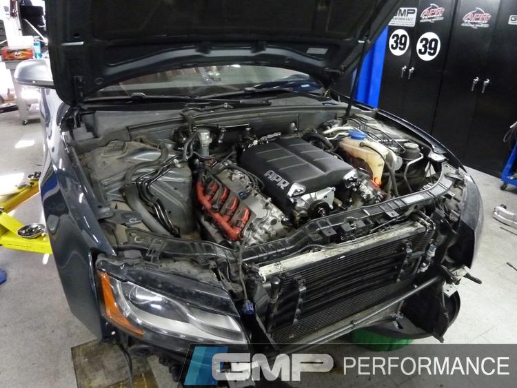

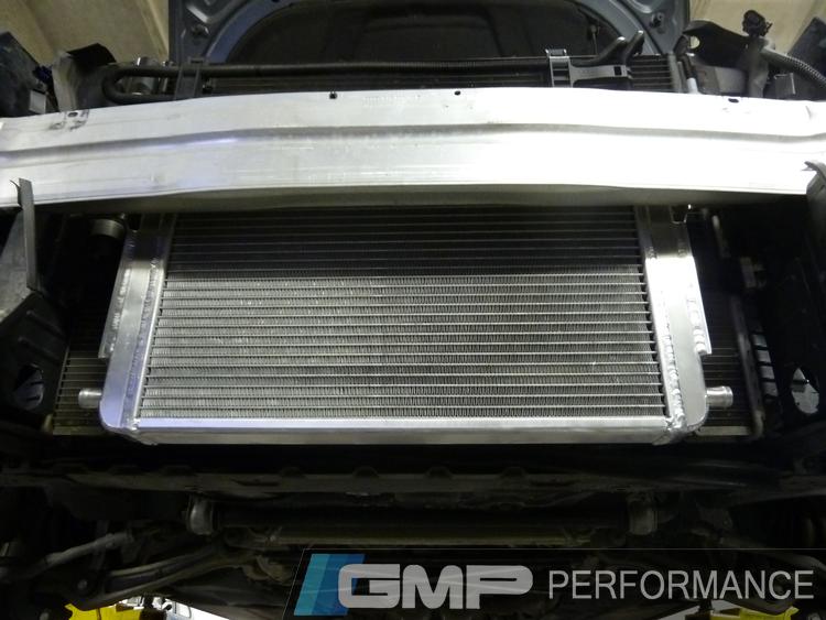

Intercooler installed

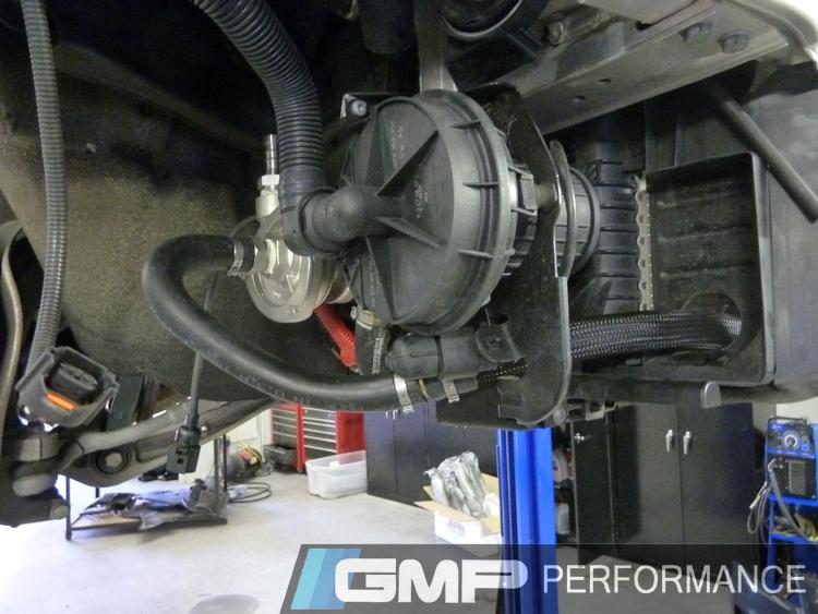

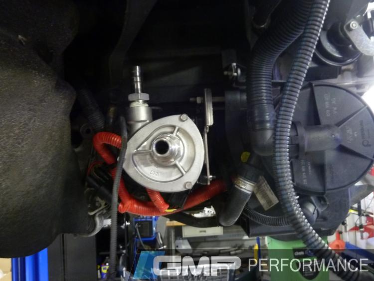

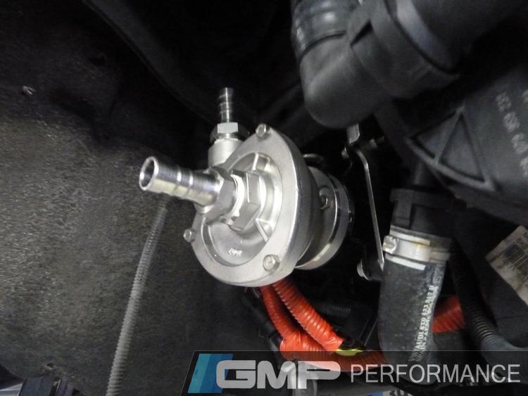

Electric water pump and coolant hoses all installed

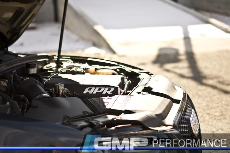

Bumper back on and it's all finished

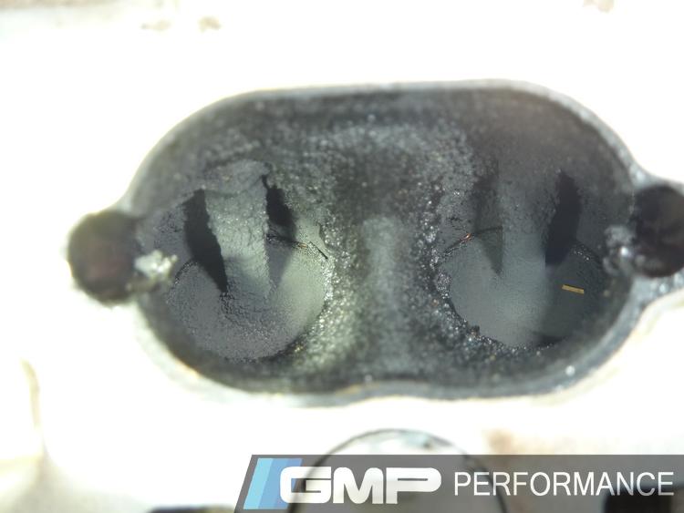

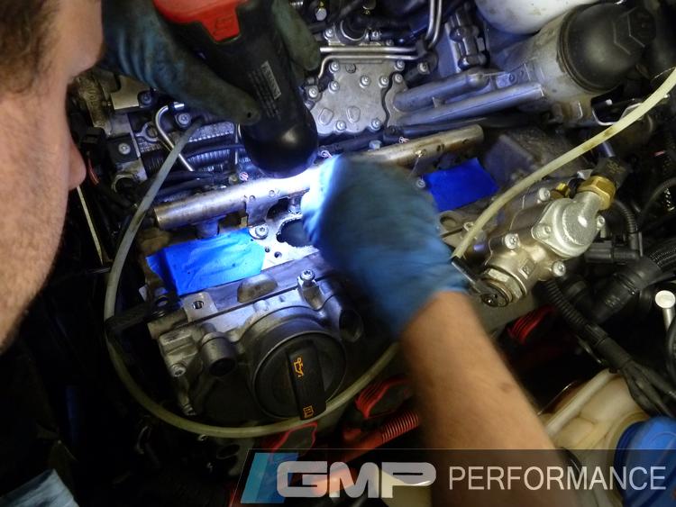

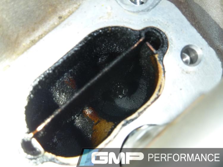

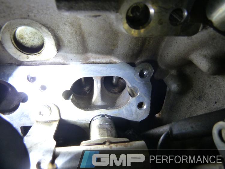

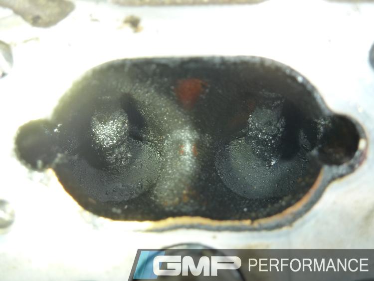

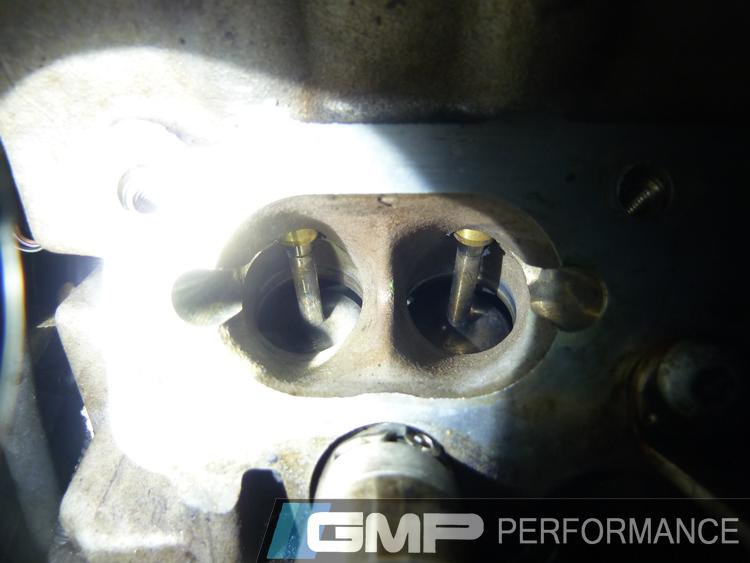

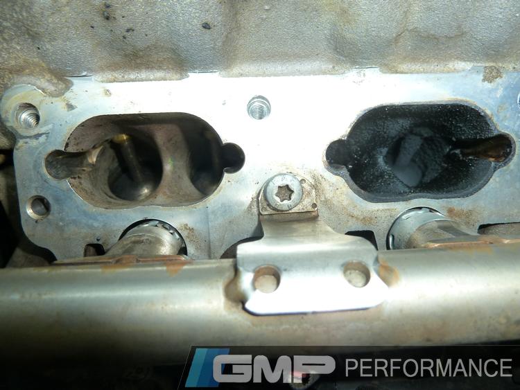

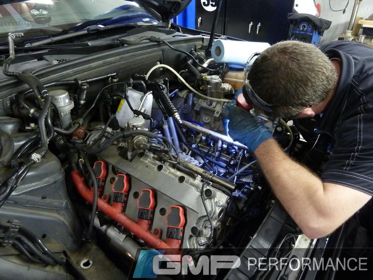

During the supercharger installation, we discovered that this engine had a severe carbon build up in the intake ports. This is a common problem in direct injection engines since there is no fuel in the intake to wash away the deposits as they form. The only way to completely clean these ports is to remove the cylinder heads which is approximately 30 hours of labor that starts with removing the engine from the car. But by carefully manually cleaning the ports with solvents and dentistry tools, we removed the vast majority of the build up.
To show you just how bad this issue can be, here's some shots of the cylinders before cleaning.

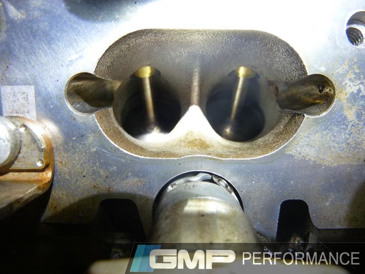

Slow and careful cleaning
And after cleaning
With this finished, looking a lot better, and the supercharger installed, we were good to move on to the next steps.

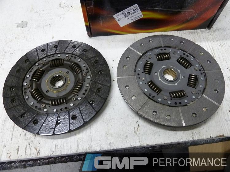

Each DXD clutch is designed to match specific styles and for this S5, we chose endurance. A great option for cars that see track time in the form of longer racing styles, it was developed with APR Motorsport to support their efforts in Grand-Am road racing. The Endurance configuration focuses on reduced transmission wear and perfect transitions from gear to gear. Track time aside, it works wonders for a car with high power that needs a clutch that will keep up with it for the long haul.
The stock versus the new DXD

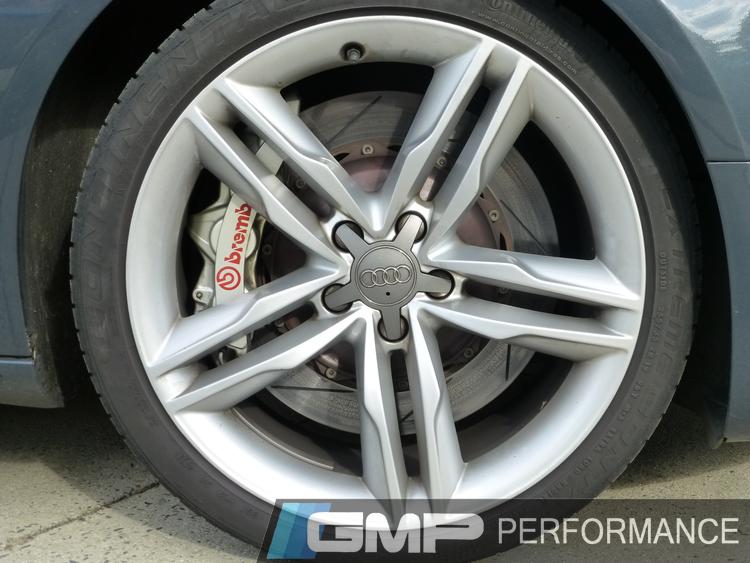

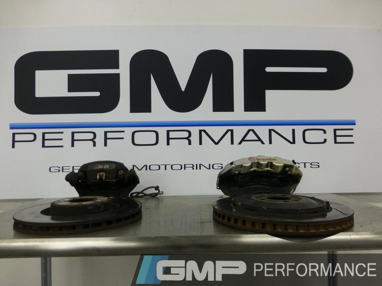

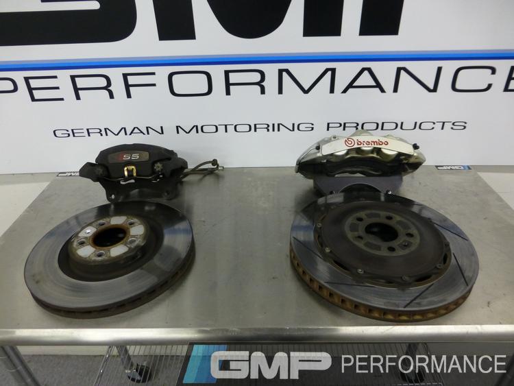

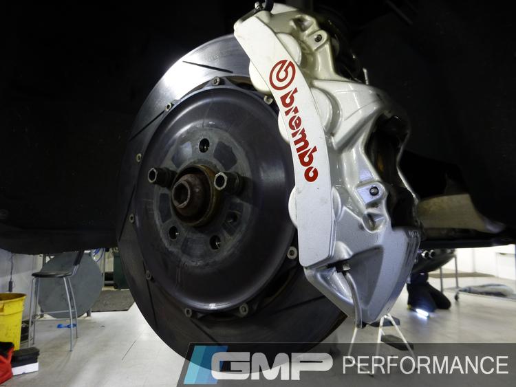

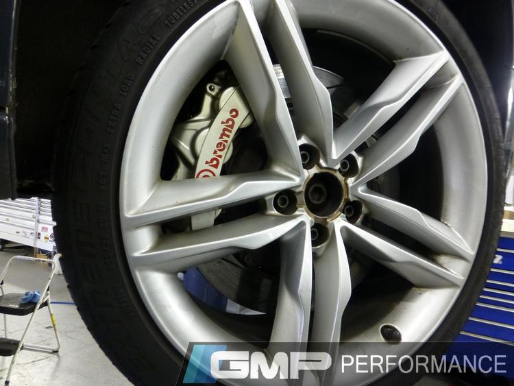

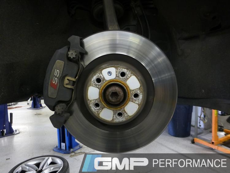

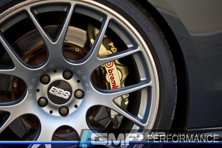

And speaking of track time, high power and long hauls, we can't neglect something as important as the brakes. Brembo is a trusted brand and we see quite a lot of big brake kits come through our doors. This Audi will definitely put them through their paces, both on and off the track. Not to mention, they look pretty great too.

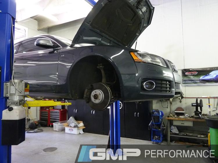

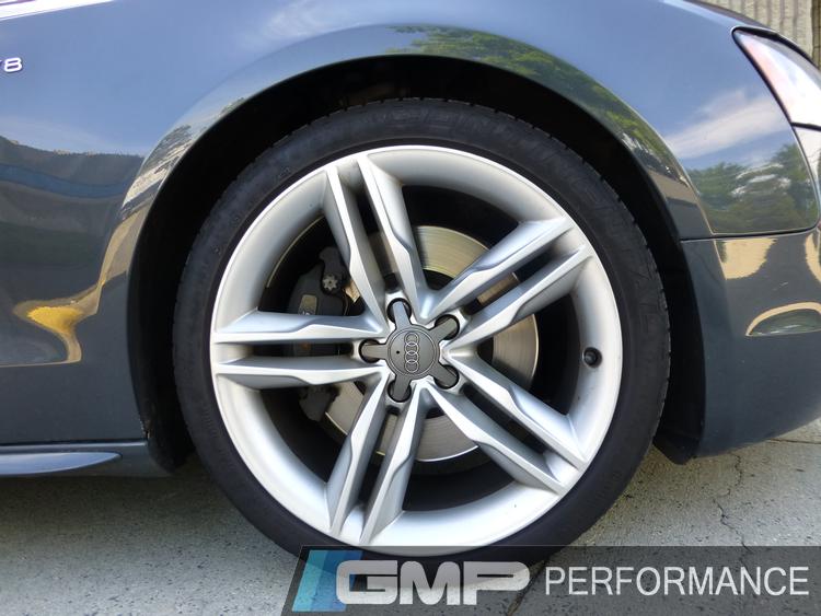

Stock brakes
When sitting side by side, there is definitely a noticeable difference
Brembos installed

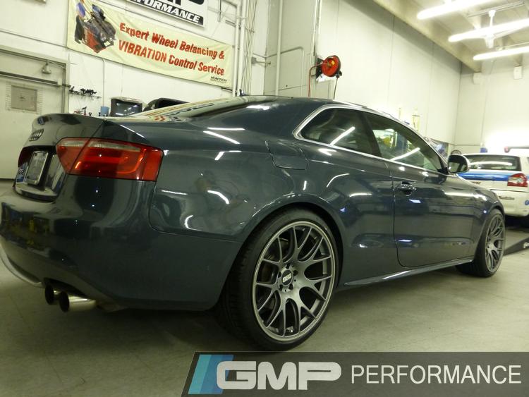

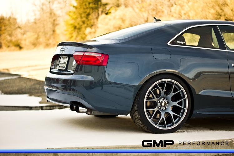

Hey guys! Just stopping by to share a few shots from a recent photo shoot we did of this gorgeous S5. Let us know what you think!
