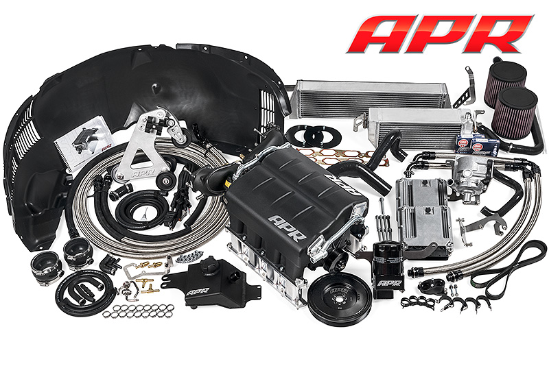

APR is pleased to present the R8 4.2L FSI V8 Stage III+ TVS1740 Supercharger System!
APR’s technical reach has grown enormously since opening in the 1990’s and currently represents a force of unmatched performance without compromise in the performance enhancement sector for Audi vehicles. Our previously available APR Stage III TVS1320 Supercharger System found its way on to several hundred 4.2L FSIs around the world, making it the most popular and reliable system on the market. With more than four years' worth of 4.2L FSI supercharger engineering research, development and testing, APR’s new Stage III+ TVS1740 Supercharger System represents the pinnacle of Audi’s German engineering enhanced by APR’s American ingenuity.
In the factory form, Audi’s high revving FSI V8 can leave much to be desired compared to some of the latest technological advances brought forth by Quattro GmbH in recent years. The APR Stage III+ TVS1740 Supercharger System fills the void by adding an average of roughly 46% more horsepower and torque across the entire power band. The results are nothing short of amazing; taking the R8 from 425 horsepower to 642 horsepower on pump fuel and 689 horsepower on race fuel without breaking a sweat! With 550 FT-LBS on tap thanks to the TVS1740’s positive displacement supercharger expect instant acceleration with absolutely no lag commonly associated with other forms of forced induction.

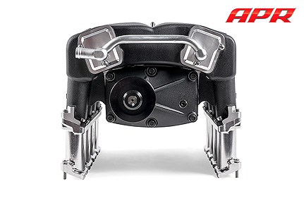

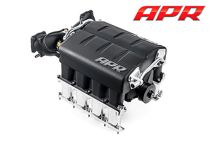

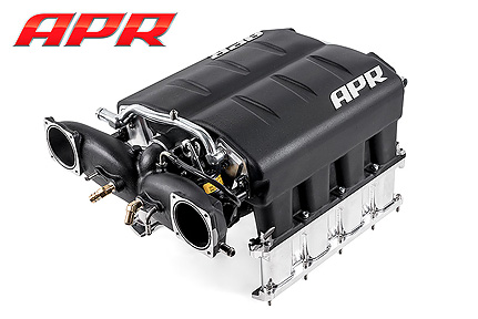

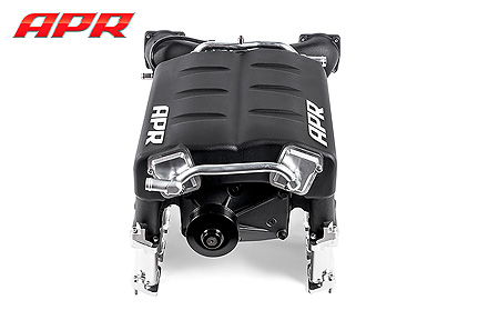

Supercharger, Manifold and Runners
At the heart of the APR Stage III+ Supercharger System is Eaton’s latest Twin Vortices Series (TVS) supercharger unit, the TVS1740. The supercharger system is a positive displacement, roots style pump, utilizing Eaton’s lightweight, four-lobe 160 degree twisted rotors. Cast and assembled as a single, OEM-style-manifold and rotating group housing, the unit is quiet, compact, attractive, easy to install, and requires little to no extra maintenance to the unit itself.
The positive displacement supercharger offers power instantly as the throttle is pressed. Boost pressure builds with no perceived lag commonly associated with other types of forced induction, and provides a large increase in torque across the entire power band. Throttle control is linear and predictable and makes for an excellent driving experience both in daily driving and wide-open acceleration.
Since the supercharger does not compress air as it moves through the roots, it’s extremely efficient during light throttle and cruising situations. Unlike screw-type positive displacement superchargers that are always compressing, the TVS unit can internally bypass unwanted air, resulting in negligible parasitic loss during cruising and thus far greater fuel economy.
The single cast unit and appropriately sized rotating group eliminates potential leak points and allows for a slim, compact design without sacrificing key airflow design characteristics. The unit features a high velocity flow path through the supercharger rotors and an unrestricted discharge port into the appropriately sized plenum. The large plenum equalizes flow across all ports as air feeds evenly through the low-pressure-drop, dual-internal air-to-water heat exchangers. Finally, the ports are separated into individual runners and continue through aircraft grade 6061 billet aluminum extension runners, offering greater operation by eliminating cross talk.
Internally the dual heat exchangers offer technological advances shared by Formula 1 teams around the globe. Each unit features a louvered fin design, which minimizes pressure drop while achieving excellent cooling effectiveness. The extruded multi-rib tubing maximizes heat extraction to be carried away through the large bore coolant recirculation hard lines. Externally, supercharger coolant is pumped through a large front mounted heat exchanger where it’s cooled and circulated back through the charger again.

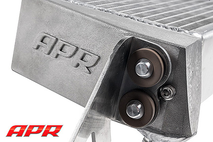

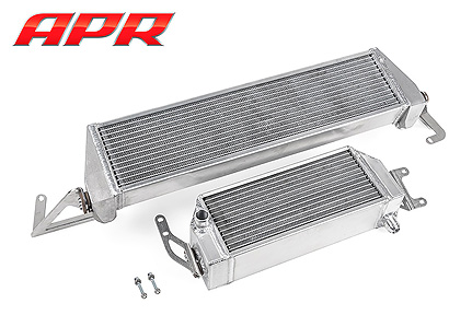

Supercharger Coolant Air-to-Water Radiators
APR’s supercharger system features a large, 585 mm x 140 mm x 65 mm front mount radiator and a second 320 mm x 140 mm x 90 mm side mounted radiator responsible for cooling coolant as it’s pumped out of the supercharger’s dual internal air-to-water heat exchangers. An adequate cooling system is critical in any supercharged application to not only keep power consistent, pull after pull, but also to help keep IAT below dangerously high levels.
The heat exchangers are specific to the R8 platform and feature cast aluminum end tanks with threaded connection points and bleeder valves. Each cooler cleanly installs with the supplied CNC, laser-cut brackets, complete with vibration insulators.

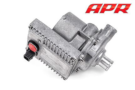

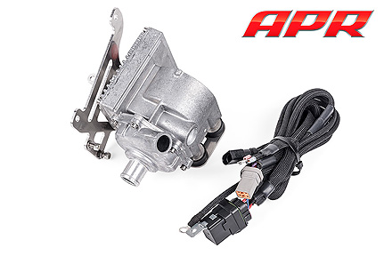

Supercharger Coolant Pump, Harness and Bracket
The R8’s rear mounted engine results in a supercharger cooling circuit spanning over twenty feet and calls for a high quality coolant pump. As such, APR’s supercharger cooling system features a highly efficient brushless cooling pump feels right at home in the R8’s engine bay.
The military grade coolant pump seamlessly connects to the factory wiring harness through the included APR wiring harness with no wire splicing and is triggered by the included relay system.
APR’s CNC, laser-cut bracket provides a simple and clean method of mounting the pump to the vehicle, out of sight, and vibration isolators ensure the system runs as quietly as possible.

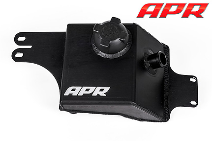

Supercharger Coolant Expansion Tank
The APR coolant expansion tank is used for filling the supercharger’s cooling circuit and for handling liquid expansion under various operating temperatures. APR’s CNC, laser-cut bracket provides a simple and clean method of mounting the expansion tank to the engine bay out of sight. The alumnium tank is anodized black and features a machined APR logo.

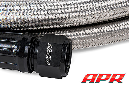

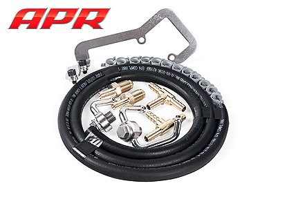

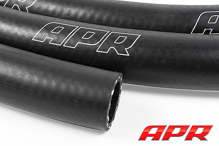

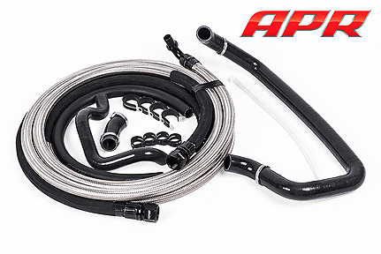

Supercharger Coolant Lines
The APR Supercharger System features dual internal air-to-water radiators designed to reduce intake air temperature, (IAT), before entering the cylinders. With cooler IAT, the ECU will request more ignition advance and result in more power.
A multitude of coolant lines feed the supercharger’s internal cooling system, which provides a circuit between the included radiators, coolant pump and expansion tank. Longer lines, such as those running the full length of the car, feature threaded connections, braided stainless steel outer sleeves and reinforced rubber cores. Specifically routed hoses are made from multi-ply silicon and the remaining hoses are flexible, reinforced rubber. All necessary brass connectors, spring-loaded clamps and OEM style crimp clamps are included.
The factory engine coolant hose running beneath the supercharger is modified for fitment reasons and is constructed from a high quality, multi-ply silicon. Protective covers are provided to shield against abrasion.

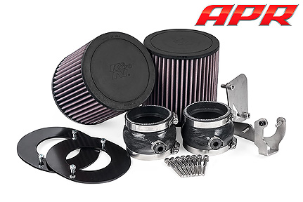

Two high flow K&N filters are adapted to the factory air box to provide fresh filtered air to the supercharger. The factory MAF housing bolts to the metal filter bracket and connects to the throttle body via two multi-ply silicon hoses. The ultra-ridged design ensures the hoses will not collapse under the tremendous vacuum created by the supercharger system’s newly added forced induction.
Laser-cut, CNC-bent air-oil separator brackets reposition and secure factory PCV system beneath the intake system.

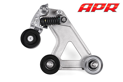

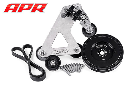

Supercharger Pulley System
The supercharger system’s internal rotors are rotated via a belt and pulley attached to the engine’s accessory drive system.
APR’s upgraded the R8’s belt system to utilize a 6pk belt for additional strength. A new cast and CNC machined bracket is used to properly orient the circuit and features new OEM tensioners, and idler pulleys. The harmonic balancer is upgraded to an OEM replacement, high quality, balanced 6 rib unit.

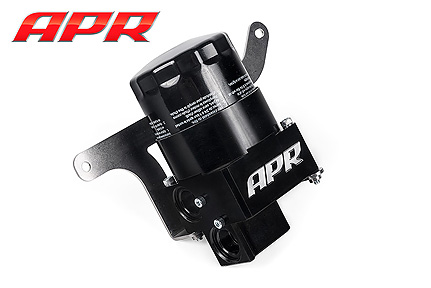

Engine Oil Relocation System
The APR supercharger system’s casting features a large, high flow, dual throttle body inlet system, which provides a high velocity flow path to the supercharger roots. To incorporate this feature into the design APR’s engineers were required to move the factory oil filter.
A CNC-machined billet-aluminum adapter connected to the oil feed and return and provides a connection point for high quality, braided stainless-steel oil lines. The lines route to the new black-anodized CNC-machined billet-aluminum oil filter housing.
CNC, laser-cut brackets cleanly hold the housing in place and out of sight under the factory engine side covers. Conveniently oil changes are now made easier with quick and easy access to the filter.

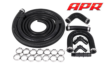

Fueling System

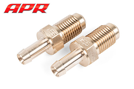

To accommodate the large APR Supercharger, modifications are made to the low-pressure fueling system and evap lines. Each fuel line exceeds CARB and EPA ratings and includes a patent-pending GreenShield barrier. The multi-ply, reinforced rubber hoses are designed to protect against today’s modern deteriorating fuels and include a best-in-class working psi of 225.
OEM style spring clamps and crimp clamps are included to ensure a solid connection. The included mounting bracket allows for a clean and solid install of relocated components.

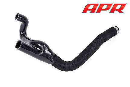

Engine Coolant Hose
The APR Supercharger fills the valley between the cylinder heads and as such, the factory coolant hose was redesigned to accommodate the supercharger. The specifically routed hose is made from multi-ply silicon and features a protective cover to provide a shield against abrasion.

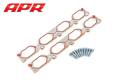

To cope with raised cylinder pressure and temperature, eight NGK Iridium IX spark plugs are included. The plugs operate at a heat range colder than stock, which results in better pre-detonation resistance under extreme conditions. With these spark plugs in, APR’s calibration engineers were able to safely achieve more power, especially in extremely demanding conditions.
Gaskets and Hardware
New OEM gaskets and bolts are provided to facilitate a leak proof connection between the cylinder heads and APR Supercharger runners.

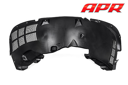

Fender Liner
The side blades on the Audi R8 provide an excellent mounting location for further supercharger air-to-water radiators. The APR Supercharger System utilizes a vented R8 V10 fender liner to allow proper airflow through the air-to-water radiator and in doing so, borrows an engineering design element from the V10 platform. The fender liner installs cleanly without any destructive trimming to the factory parts.

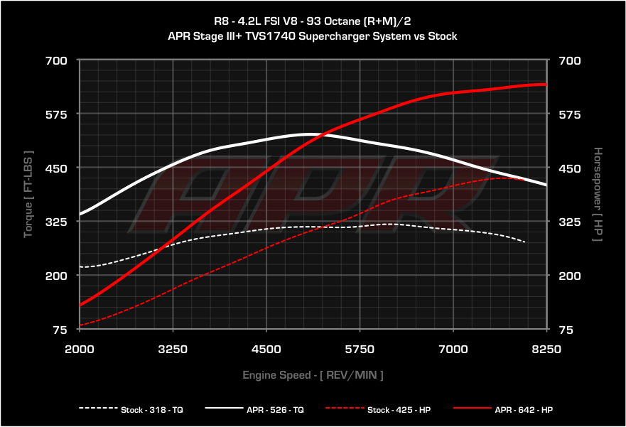

Dyno Testing
Horsepower and Torque was measured in APR’s in-house, soundmaster dyno cell, using a dynapack all wheel drive dynamometer. Multiple stock and modified runs were conducted and the SAEJ1349 corrected results were averaged together to represent the differences between a stock and APR Stage III+ R8. Crank power figures were estimated based on Audi’s factory advertised results.
Click through the tabs below to view output using various fuel grades, power measured at all four wheels, estimated at the crank, and the absolute gain over stock.
Click the links below to see power output at the wheels, estimated at the crank and with different octanes
91 Octane | 93 Octane | 100 Octane - Measured All Wheel Horespower
91 Octane | 93 Octane | 100 Octane - Estimated Crank Horsepower
91 Octane | 93 Octane | 100 Octane - Gain over Stock
APR Stage III+ TVS1740 Supercharger System Calibration Report
Output:
424 HP & 317 FT-LBS of Torque - Stock as Rated by Audi
425 HP & 318 FT-LBS of Torque - Stock as Measured by APR
611 HP & 511 FT-LBS of Torque - APR Stage III+ with 91 AKI or 95 RON fuel
642 HP & 526 FT-LBS of Torque - APR Stage III+ with 93 AKI or 98 RON fuel
689 HP & 550 FT-LBS of Torque - APR Stage III+ with 100 AKI or 104 RON fuel
Max Gains over Stock:
+200 HP @ 5,350 RPM & +200 TQ @ 5,100 RPM - APR Stage III+ with 91 AKI or 95 RON fuel
+220 HP @ 5,600 RPM & +214 TQ @ 4,950 RPM - APR Stage III+ with 93 AKI or 98 RON fuel
+263 HP @ 7,900 RPM & +239 TQ @ 5,900 RPM - APR Stage III+ with 100 AKI or 104 RON fuel

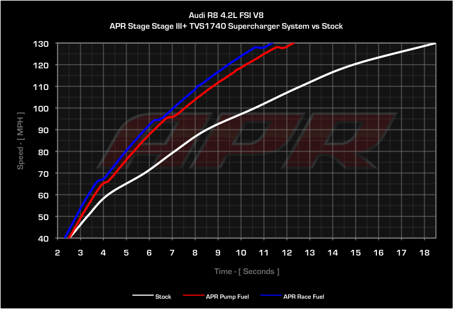

Acceleration Testing
All too often performance upgrades show improvements during a single dyno pull, but lack the ability to show the same performance in real world conditions. Furthermore the dyno may be unable to illustrate the system’s response and other tuning changes designed to make the system instantly react to the drivers input. Through acceleration testing, APR’s engineers were able to improve power delivery during launches, after gear changes and prove the cooling system was up to the task of sheading heat to keep power consistent.
APR’s local certified quarter mile drag strip is a perfect and safe testing ground for high speed, 130+ MPH sprints. Using Car and Driver magazine’s measured results as a benchmark, APR’s Engineers setout to prove the Stage III+ Supercharger System was capable of increasing the R8’s performance substantially.
Car and Driver magazine measured the R8’s sprint from 30-130 MPH in an underwhelming 17 seconds. However, with the addition of the APR’s Stage III+ TVS1740 Supercharger System, the vehicle entered a league of performance often shared by exotic supercars. Using 93 octane fuel the same acceleration test was completed 6.5 seconds faster! Through testing higher octane fuels, and eventually weight reduction and tire changes, the gap grew even larger, ultimately resulting in an astonishing 44% reduction in time.
Many more acceleration tests were performed, including record setting quarter mile passes, proving an APR Stage III+ TVS1740 Supercharger System is the ultimate upgrade for R8!
0-60 MPH
4.20 - Stock (Car & Driver Magazine)
3.61 - APR Stage III+ - Full Weight with Street Tires and 93 AKI Fuel
3.34 - APR Stage III+ - Full Weight with Street Tires and 100 AKI Fuel
0-100 MPH
10.60 - Stock (Car & Driver Magazine)
6.91 - APR Stage III+ - Full Weight with Street Tires and 93 AKI Fuel
6.31 - APR Stage III+ - Full Weight with Street Tires and 100 AKI Fuel
60-120 MPH
10.7 - Stock (Car & Driver Magazine)
6.57 - APR Stage III+ - Full Weight with Street Tires and 93 AKI Fuel
6.03 - APR Stage III+ - Full Weight with Street Tires and 100 AKI Fuel
60-130 MPH
14.30 - Stock (Car & Driver Magazine)
8.69 - APR Stage III+ - Full Weight with Street Tires and 93 AKI Fuel
7.88 - APR Stage III+ - Full Weight with Street Tires and 100 AKI Fuel
30-130 MPH
17.00 - Stock (Car & Driver Magazine)
10.49 - APR Stage III+ - Full Weight with Street Tires and 93 AKI Fuel
9.56 - APR Stage III+ - Full Weight with Street Tires and 100 AKI Fuel
ID:	354451   Click image for larger version
