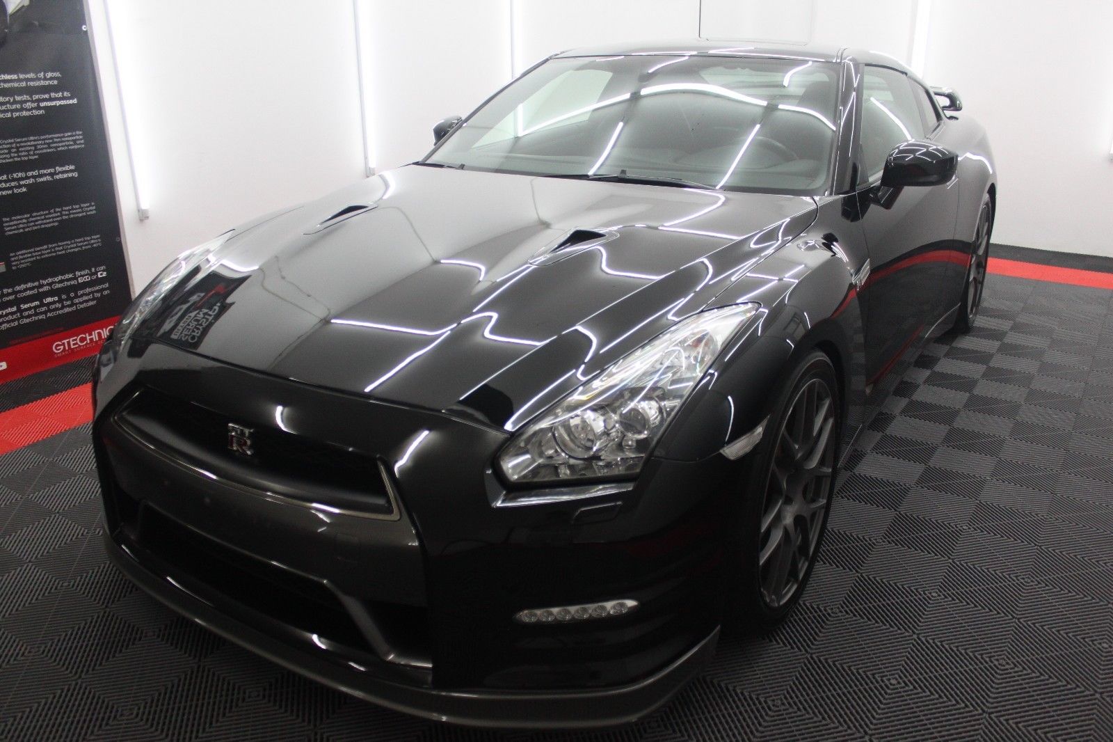

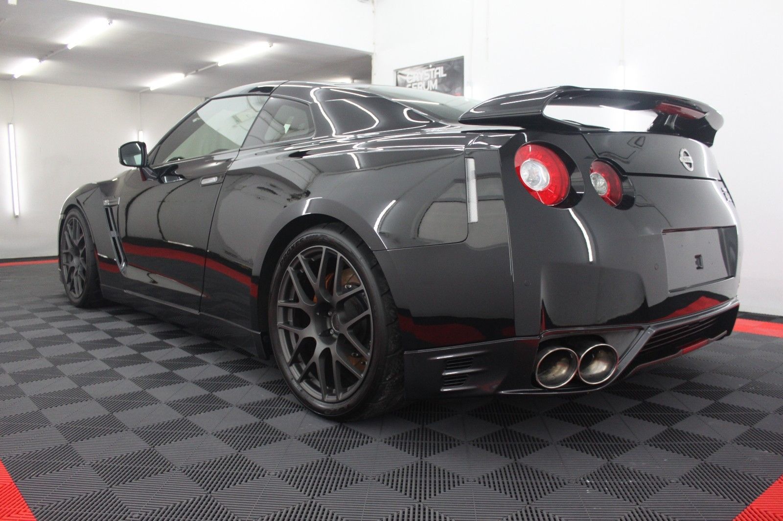

Nissan GT-R 2011 1200Hp in Europe
Year: 2012
Make: Nissan
Model: GT-R
Price: $114999
Mileage: 59000
Color: black
Transmission: Automatic
Drivetrain: 4WD & AWD
Year: 2011
Model: Black Edition
Engine: VR38 Stroker 4.1L
Wheels: TSW Nurburgring 20 "10J / 10.5J with MPSS tires
Year of built 2017 - Engine / Transmission / Diffs / Brakes everything is almost new!
Estimated 900-950hp and about 1100Nm on pump gas and 1200-1300hp potential M85
Engine, trans and fuel system rated up to 1800hp or more, needs bigger turbos and clutches for more power if needed
Flexfuel sensor to run methanol or ethanol directly in the tank, car does low 4s 100-200 on pure pump with a very conservative tune, high 3s with more aggressive tune on pure pump, no meth or tricks
I guess flat-low3s on pump+meth in tank
Engine never used with meth till now, only pump and low boost and timing, will incluide race tune if needed.
Before used a simple 3.8 engine (rods and pistons only) with the same setup and did 3.7s 100-200 with pump and meth spray (not in tank to reach high % of meth)
ENGINE - 6500km since rebuild including breaking-in and a roadtrip with my kids to Vienna (2500km)
- Block reinforced - Darton Dry Sleeves 96mm bore
- Stroker kit with BILLET crankshaft BRIAN CROWER 94.4mm
- Rods Manley Turbo Tuff
- Pistons Diamond Billet 96mm with Big Wrist Pins
- Linney Billet Girdle
- Oem Bearings
- New Oil Pump
- DODSON Water Thermostat
- DODSON OIL Thermostat
- Tomei Camshafts 256/264
- Double Springs FERREA
- Valve guides and Valve Spring Retainers New Ferrea Valves + 1mm
- New VVTI, Timing Chain and Tensioners
- Cosworth gaskets
ENGINE TURBO
- 2x GARRETT GTX 3076
- Custom Manifolds upgraded for high boost pressure.
- Downpipes 76mm
- 2x Wastegate TIAL 44mm
- 2x FORGE BOV
- Custom Intercooler 5.5 "
- Custom intercooler piping
- MAP 4bar
- Speed ​​Density kit
- Custom Exhaust 102mm CatLess
- Intake 80mm
- Linney Throttle Bodies 72mm
ENGINE FUEL SYSTEM
- 2x Veyron Fuel Pumps, 1200hp / pump
- FlexFuel system with Hijack Gauge for Meth / E85% info
- 12 Injectors system (6x 1050cc Primary & 6x 1650cc)
- ASNU 12 Injector Controller
- Linney Injector Rail KIT with Fuel Pressure Monitoring
- Custom Secondary Rail
- Aeromotive Fuel pressure regulator
- Custom bigger fuel lines
TRANSMISSION
- DODSON V3 1-6 Extreme Duty Reliable up to 2000hp
- Baskets and Pistons A + B
- DODSON Solenoids
- DODSON Straight Cut Gears Cabin shift sound
- LINNEY Oil Pan
- LINNEY Circlips set
- FORGE OIL COOLER KIT
- 8 Plate Clutch T800
- QUAIFE FRONT LSD
- QUAIFE REAR LSD
- New BELLHOUSING (2017+ upgraded model) + OEM bellhousing
DRIVETRAIN
- LITCHFIELD BILSTEIN NurburgRing suspension
- KW Sleeves
- WHITELINE sway bar and BUSHINGS
- AP RACING BRAKES slotted
- Ferodo DS2500 (F & R) and DSUNO / 1.11 (F / R)
- KAPS 4WD Controller (adjustable percentage of rear / front traction)
MANAGEMENT
- ECUTEK ECU phase 7 by LINNEY
- 4maps from 1bar to 2 + bar
- Bluetooth Ecutek + smartphone app license
Another Ecutek USB
- Live logging on your smartphone
- Valet Mode and much more options from Ecutek
- ECUTEK TCM
- Traction Control Adjustable
- Clutch Capacity Adustable
- Touchpoint Adustable
- 7k or 8k RPM software
OTHERS
- 4 Rims 19 " Japan Racing 9.5J/11J
- 2 Rims 18" Japan Racing 10.5J
- 2 Drag Radial Mickey Thompson Tires 325/40/18 (new)
- 4 Michelin Cup2 295/30/20
- 4 Michelin Pilot Super Sport 285&295/35/20
- 4 Toyo R888 Semi Slick 285/315 R20
- 4 slicks Pirelli 295&305/680
