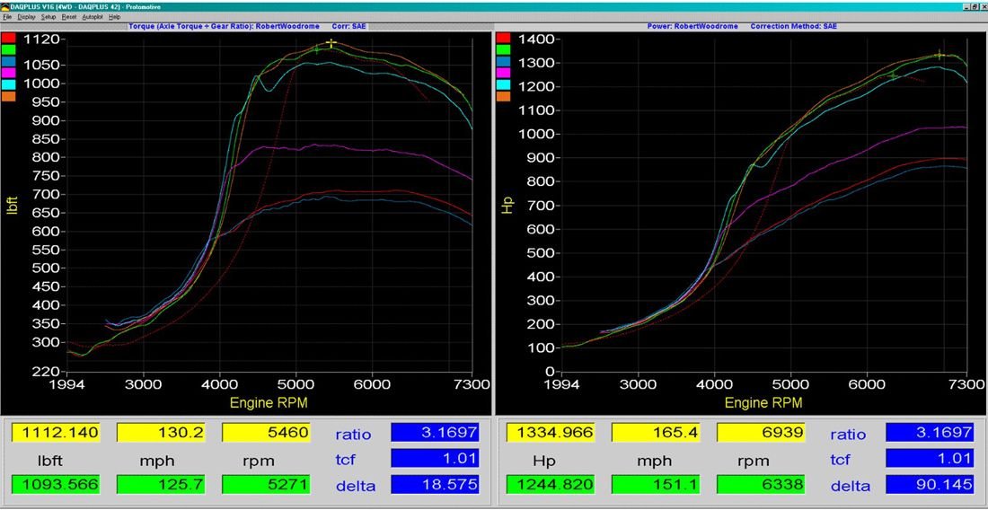

Here are 2 dynos sheets that were provided by Protomotive to put things into perspective.
Here is a dyno pull below on Protomotive's Dynapak dyno of a very similar 4.2L build, a little smaller than the 4.3L my 997 is running. The boost level was about 2.3 on Garret GT3794 turbos. Results: 1564 whp / 1145 wtq
Here is another point of reference below. GT3586HTA turbos (same turbos as my build), but this is a dyno from a 4.1L setup running 2.2 - 2.3 bar of boost at the highest settings. Similar build otherwise - Results: 1334 whp / 1112 wtq.
From Todd at Protomotive:
"Keith, I’ve not run your exact combo here in my shop, so I can only get about this close on either side. We’ve also always stuck to the 103.6 bore here vs. the 105.4 like you have. The machine work is silly to get the 105.4’s in there. The 103.6 is almost drop in. The 4.1 has become our cookie cutter build, lol…
The more interesting part vs. peak power about your 4.3L build is the fact that it probably makes 800+whp at 1 bar of boost!!! Most 996/997.1TT with bolt on’s take 2 bar to hit that number. I know your car is stupid fast, but it doesn’t take so much boost to get there. The lower boost numbers produce a super reliable 800-1000whp package vs. a 1350/1400whp running 2.2-2.3 bar stuff.. Sure you can talk about the peak numbers, but there’s Honda’s out there making that kind of power. They just pop all the time. Running 800-1000whp daily drivers is a whole other thing and very few people can place claim to that"

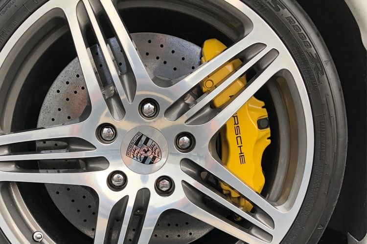

Porsche OEM Carbon Ceramic Brakes (PCCB)

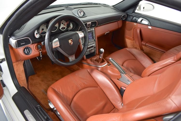

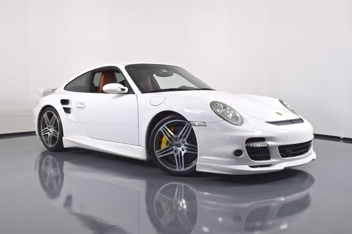

Why the dealer photos and no plate? If those are nor current photos you need to disclose.

Hi GT3 Chuck. How are you? Been a long time. The photos are all current. I know a local dealer who let me use their studio for photos. They were all taken a couple of weeks ago.
