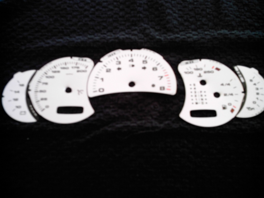

FS: 996TT Tiptronic Gauge Faces
Factory optional Aluminum gauge faces for a Turbo tiptronic. They are easy to change. $75.00 plus shipping.

I've been ask about the DIY on the gauge faces. It's easy. Here's what you do...
1) Disconnect the battery.
2) On each side of the cluster you have 2 screws hidden. One is under the 4 way flasher switch and the other under the little vent looking piece. Pop them both out and remove those screws and the cluster is now free.
3) Lift the cluster and unplug the harness from underneath (I think 5 connectors if I remember right.)
4) Remove cluster and move to a clean work area.
5) Remove the screws that hold the clear plastic bezel in place.
6) Use the tool (included) to gently remove the needles.
7) Gently remove the faces by lifting them from the pins that hold them in place. Replace the faces and reverse the process to finish the job.
Best of luck!!!
