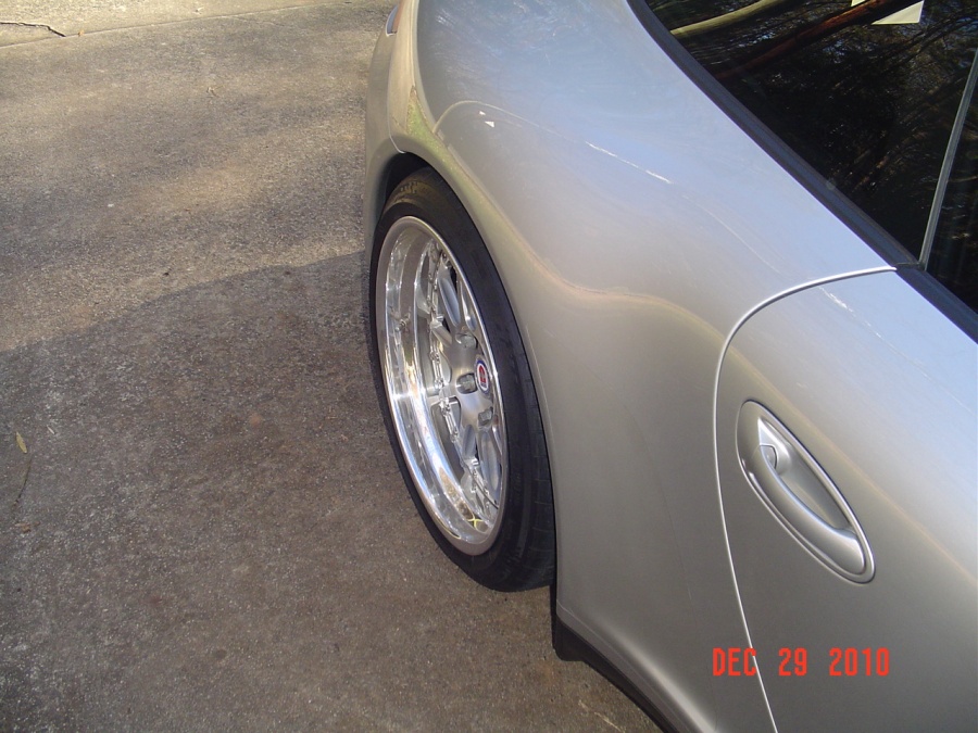

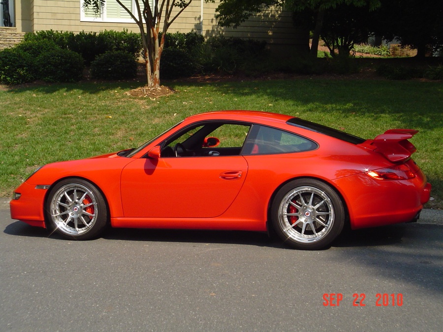

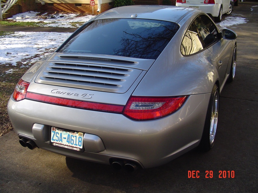

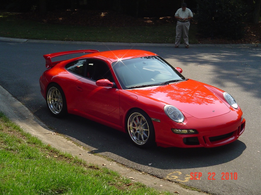

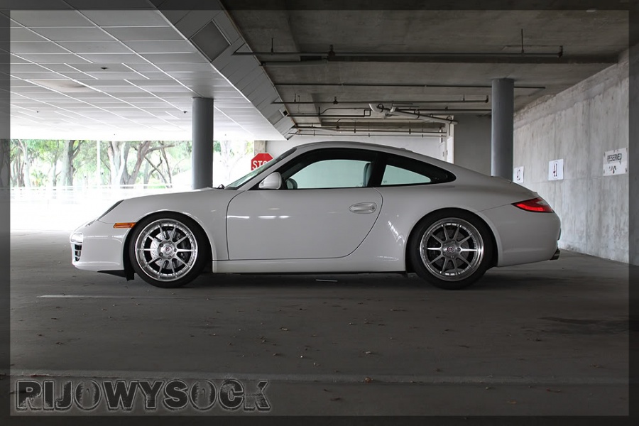

For sale is a set of HRE C93's with near new Michelin Pilot Tires, 19x9 fronts (ET45), 19x12 rears (ET56) with 235 on front, 305's in rear mounted, balanced and ready to go. As pictured, these fit perfectly on my 2006 C2S as well as my most recent 2010 C4S with 15mm spacers to make flush. The white 997 is RList member "Riley" who originally had these with 245/325 Invo's with no clearance issues even with the wider tires. As many of you may know, this was one of four or five sets Riley had on that car last year for his notorious photo shoots before he replaced the 997 with a Lotus. (I have many more pictures of these wheels if you'd like. Close-ups available as well upon request.)
These wheels are as close to perfect without calling them "new". There is absolutely no curbing, repairs, touchups, etc... They are as nice as they were new out of the box. These are the natural metal finish with the special ordered raw polished lips which means never any clear flaking, hazing, finish issues, etc... Just polish and go. Amazingly, I've polished the lips once with Mother's polish, and after 12 or so washes, they still shine with no spotting or need for anything other than your typical drying off.
These wheels are absolutely stunning in person. The rears are deep as can be. The stepped lips really add a new dimension. No clearance issues whatsoever. No need for rolled fenders. They're ready to go. If you need specific pictures, let me know. $3,500 was my asking price without the tires originally, but I need to sell these as I no longer have a P-Car to fit.
