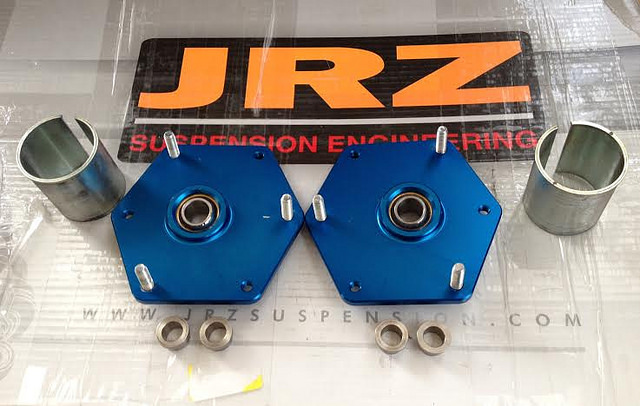

For sale is a pair of front JRZ monoball shock upper mounts (camber plates) to be used on a 996TT/C4S. I ran these on my car for about 6 months (2000miles) while my car was run in AWD mode. They are virtually new. These camber plates are correctly designed to take into account the geometry of the 996TT AWD front uprights. The advantage of these mounts compared to others like Mode is the fact that the monoball is recessed and positioned within the center of the camber plate as opposed to slightly below it as most other aftermarket plates. This feature gives you roughly an extra 1/2" of lowering to the chassis of the car without taking away from the shock travel. Additionally, these plates offer two sets of mounting holes which give you the option of stock factory camber (as pictured) or an additional -1º of camber by using the offset holes. Monoball bushings inserts with a standard 14mm shock piston diameter are included so these can be used with any 14mm piston shock. Other inserts can be used for any nonstandard shocks.
Finally, I am including a pair of shock tube adapters which allow you to use any shock that has a 51.5mm body diameter in the 55mm diameter 996TT upright. All JRZ/Moton/MCS/Ohlins along with stock GT2/GT3 shocks use the 51.5mm shock body diameter. What this means is that you can take any of those shocks or any OEM 996GT2 or GT3 suspension and bolt it on to your 996TT with the use of these JRZ upper mounts and adapter sleeves.
