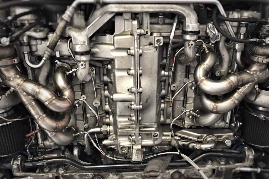

Racegrade TC8 EGT module and individual EGT sensors are here. Joe is doing the headers now.
Garth wired up the Motec C127 dash and logger. Also thanks to Chris Delgado for custom firmware for it to work with the ProEFI.
#TeamAIM

Type - K thermocouples...its like being at work
Careful with vibration and the thermocouples, kills turbine wheels all the time.
Another tip which you may already know, make sure the thermocouple does not touch the pipe wall. You will start picking up metal skin temperature changing your gas temperature reading which is what you are really after.

good eye

Joe@AIM finished my new headers with individual EGT bungs in every runner. Waiting on Garth to wire them into the Racegrade TC8 and that into the ECU and it will be ready to hit the dyno again.
#TeamAIM

Looking good. Proper collectors and wastegate positioning also.
