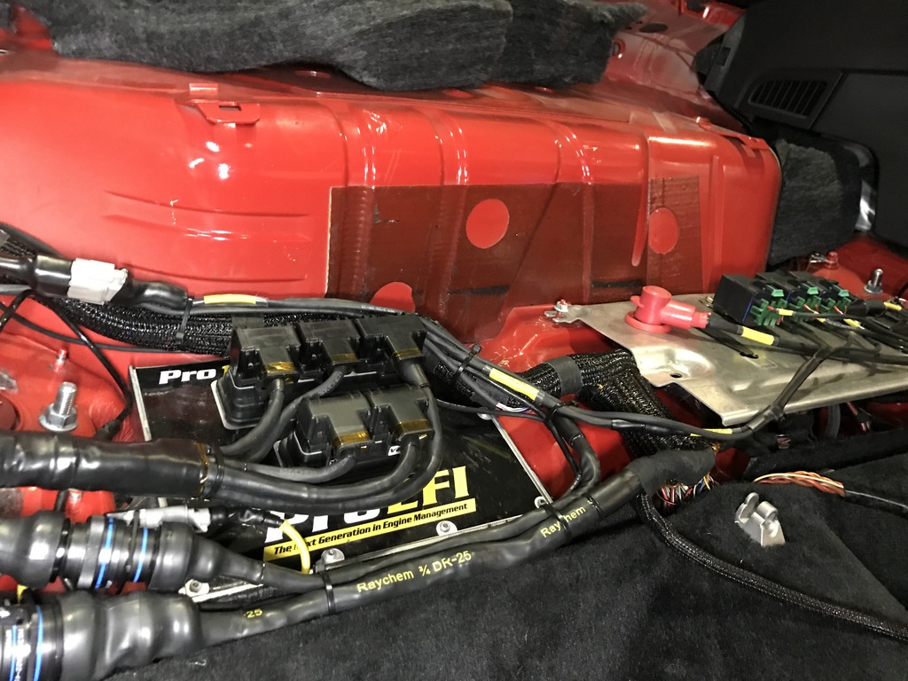

standalone wiring is cleaned up and the back part of the interior can start going back together, took apart the front center console yesterday to do the PCM3.0 conversion.
