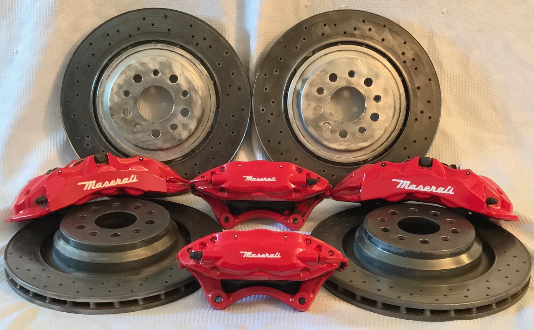

For sale is a beautiful complete set of the powerful Brembo brakes off of the 2015 Maserati Ghibli S Q4, all components have less then 15,000 miles of normal road use.
Included in the sale are:

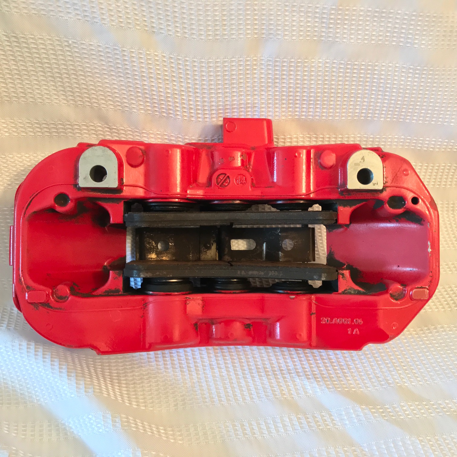

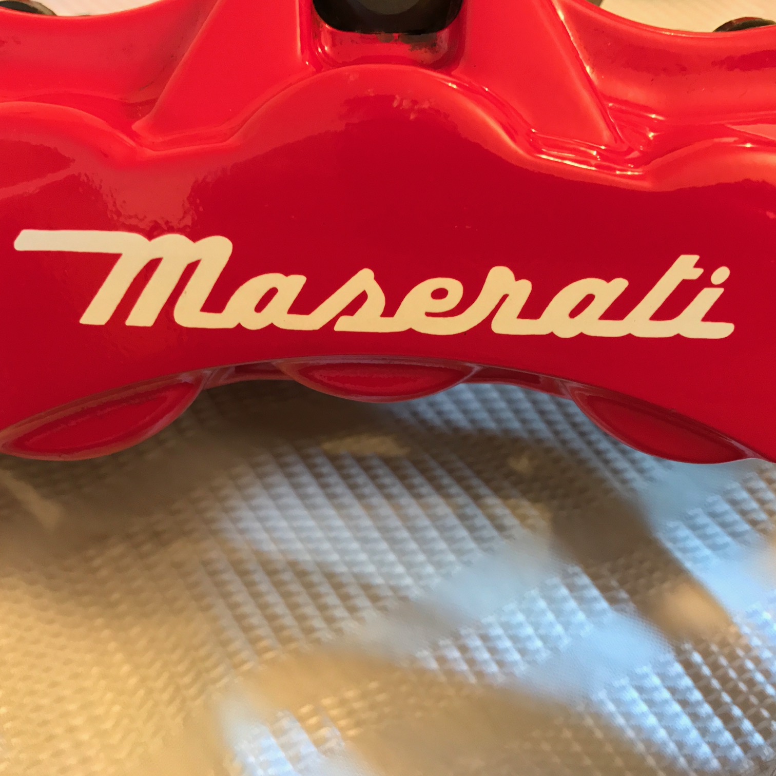

1) Brembo supplied two front 6 piston monobloc and two rear 4 piston monobloc calipers finished in the original factory Maserati Rosso paint. (An $800 option)
2) Two gently used Maserati front ventilated, slotted and drilled 360 x 32mm discs Manufacturer Part Number: 670030935 (Superseded Part Number: 670007374) (New $261.89 a side) and two gently used ventilated, slotted and drilled 350 mm x 28 mm rear discs 670031597 (new 173.36 per side). These are dual-cast discs, which combine the properties of cast iron with the light weight of aluminum, helping to reduce the unsprung mass.

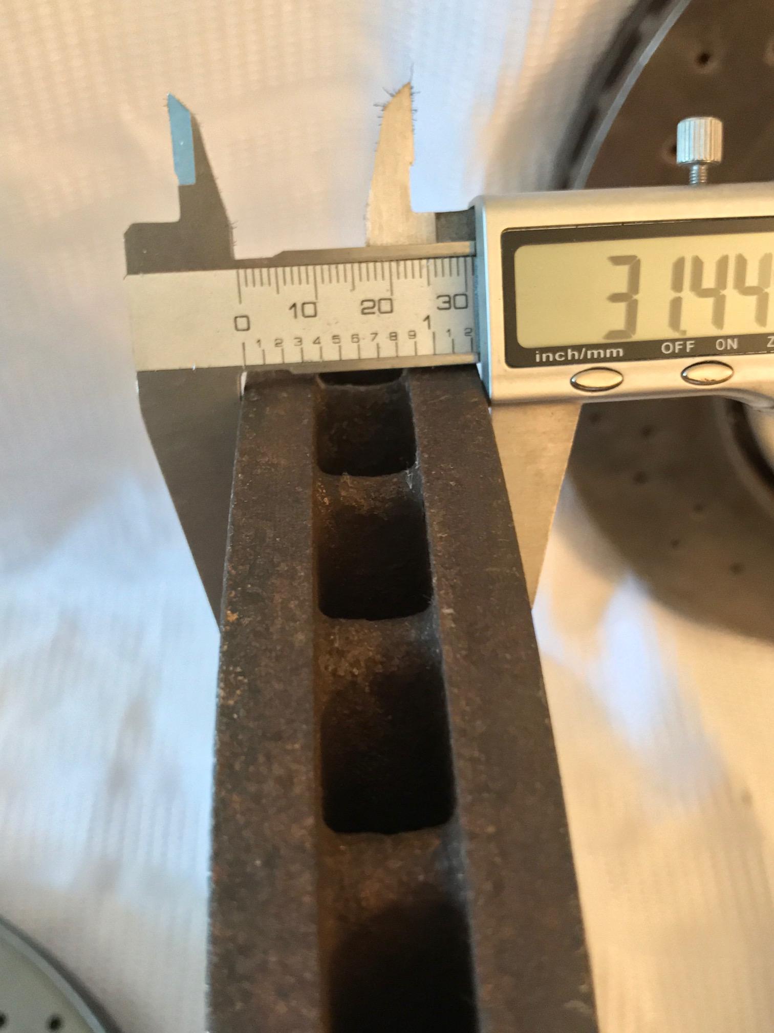

Front rotor thickness as sold: 31.44mm (new 32mm)

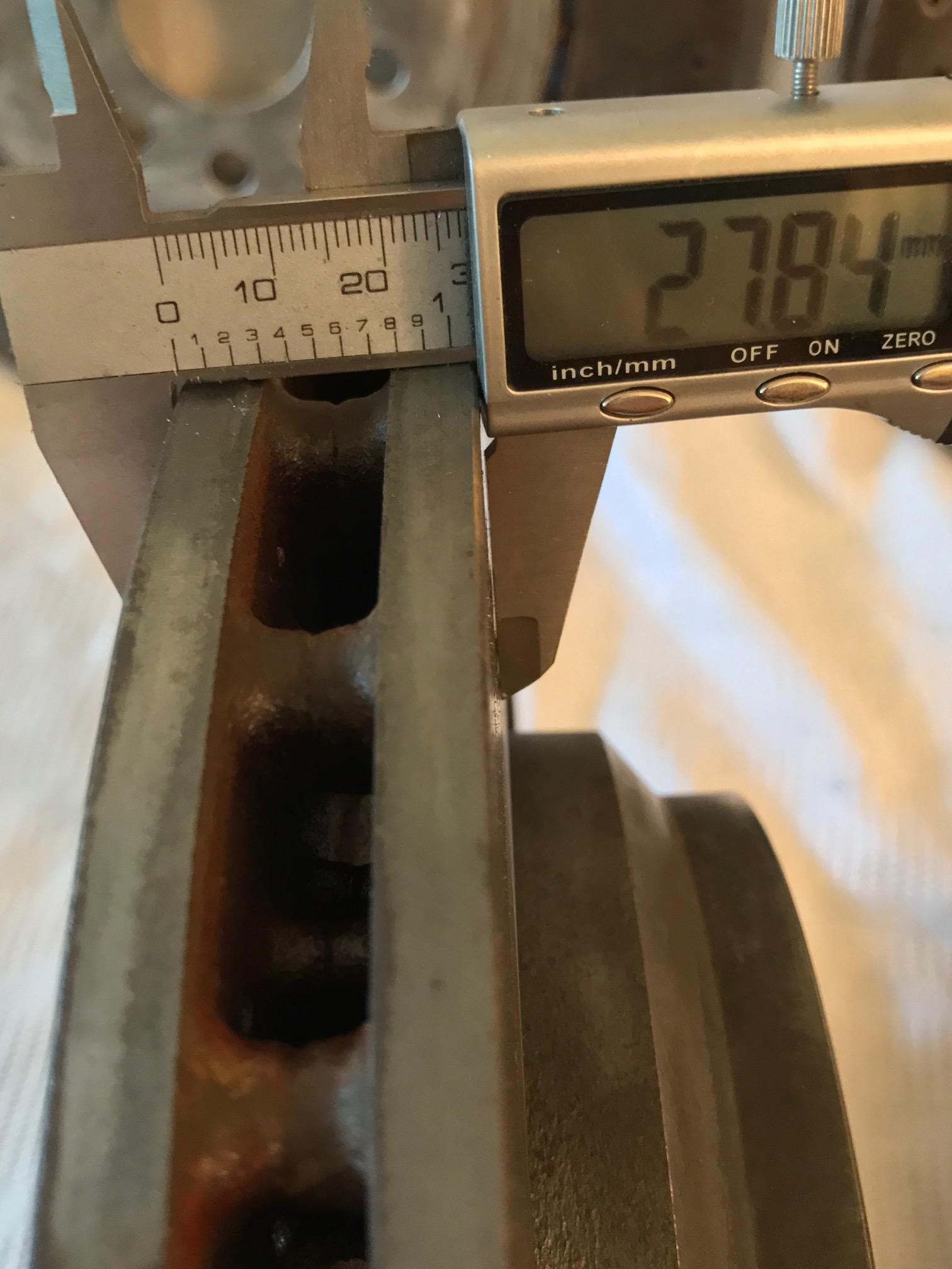

Rear rotor thickness as sold: 27.84mm (new 28mm)
3) Gently Used (<15000miles) Brembo Front Brake Pads 980156013 approximately 30-40% pad life remaining (New $361.73)
Gently Used (<15000miles) Brembo Rear Brake Pads 980156007 approximately 70-80% pad life remaining (New $312.59)
4) Fedex Ground Shipping in the CONUS
Price is $3000 Shipped via Fedex Ground , payment options include certified check, cash up front, or Paypal Gift. Local pick-up is available.
Brembo Rosso Red
GENUINE ITALIAN MANUFACTURED
BREMBO 6 PISTON FRONT &
4 PISTON REAR CALIPERS
WITH DISCS

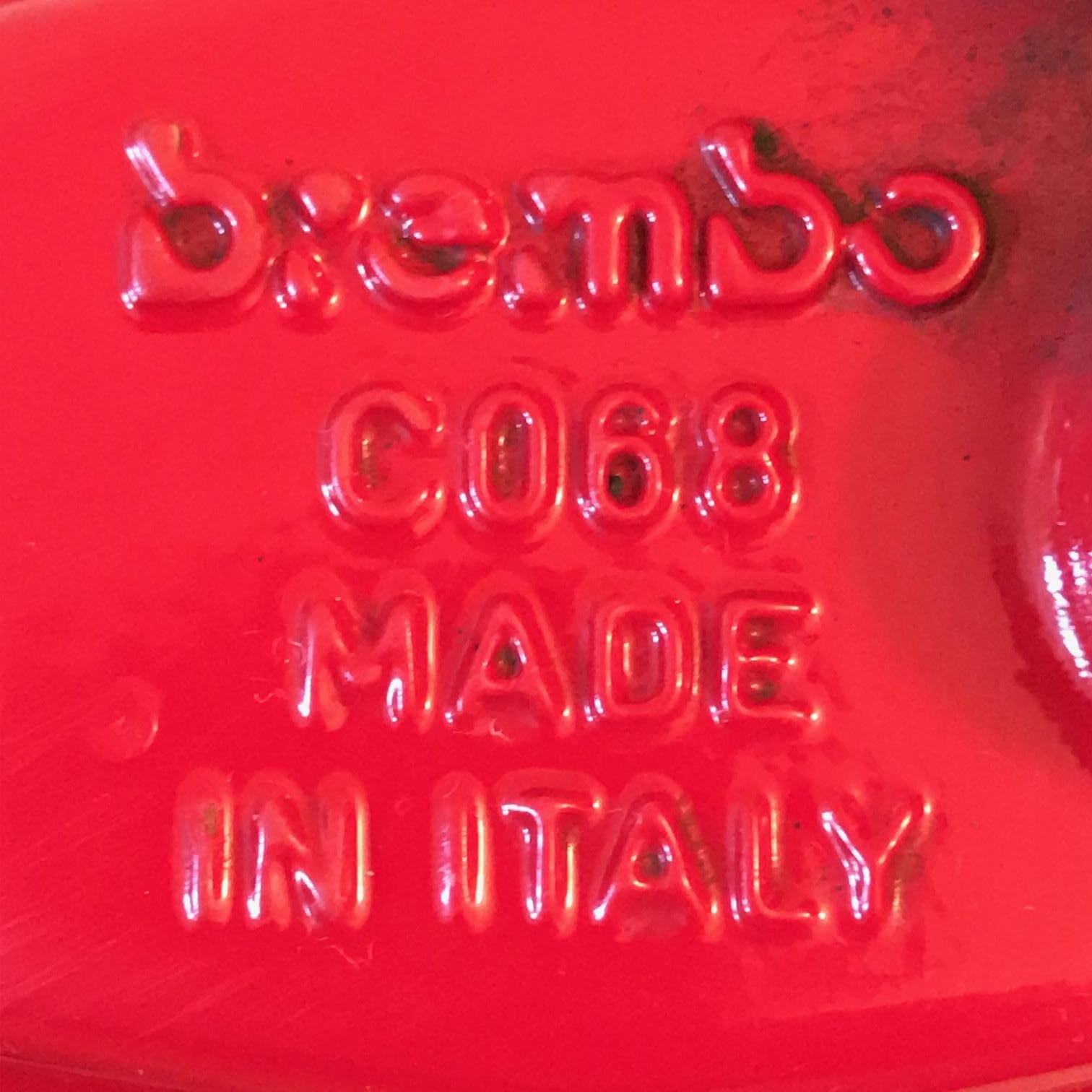

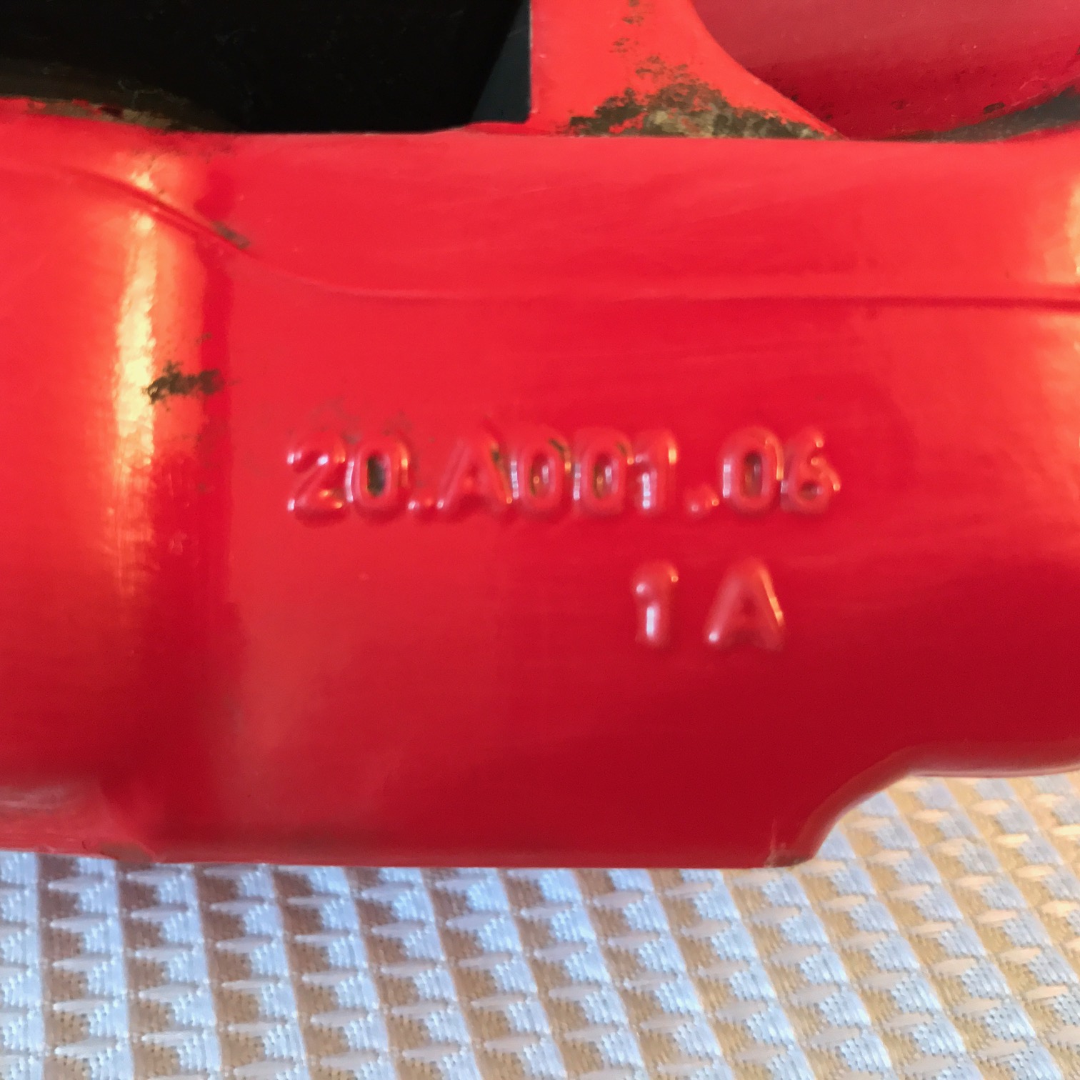

Front Calipers:
RHF Brembo no: 20.A001.05
LHF Brembo no: 20.A001.06
Pistons: 6 pistons
Unloaded Weight: 3.3kg
Piston Sizes: 2x 30mm, 2x 34mm, 2x 38mm
Piston Area: 5500mm2
Mount: Radial
Bolt hole to bolt hole distance : 194mm
Pad Length 190mm
Maximum Accommodating Rotor Dimension: 390x34mm
Caliper Mounting Bolt Holes: M14, non-threaded.
38mm Boot and Seal: pn: 182121
34mm Boot and Seal: pn: 215664
30mm Boot and Seal: pn: 215663
Centric Pn for all boots and seals: 143.35037
Bleeder Screw Maserati PN: 152954 (M10x1.0)
Bleeder Dust Seal PN: 215666
