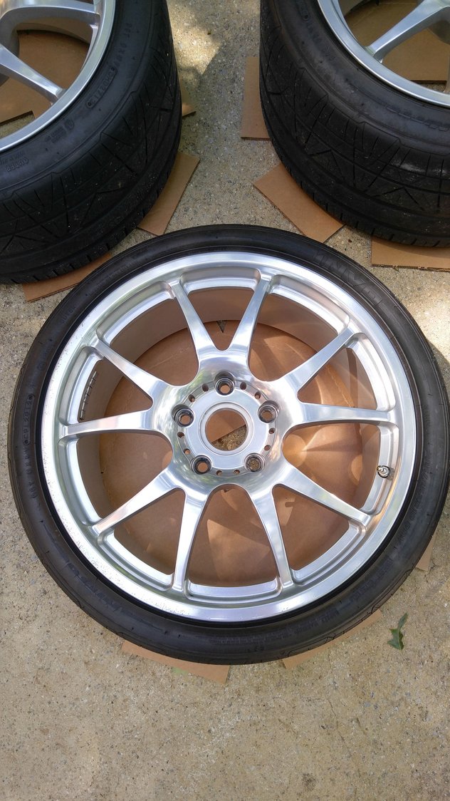

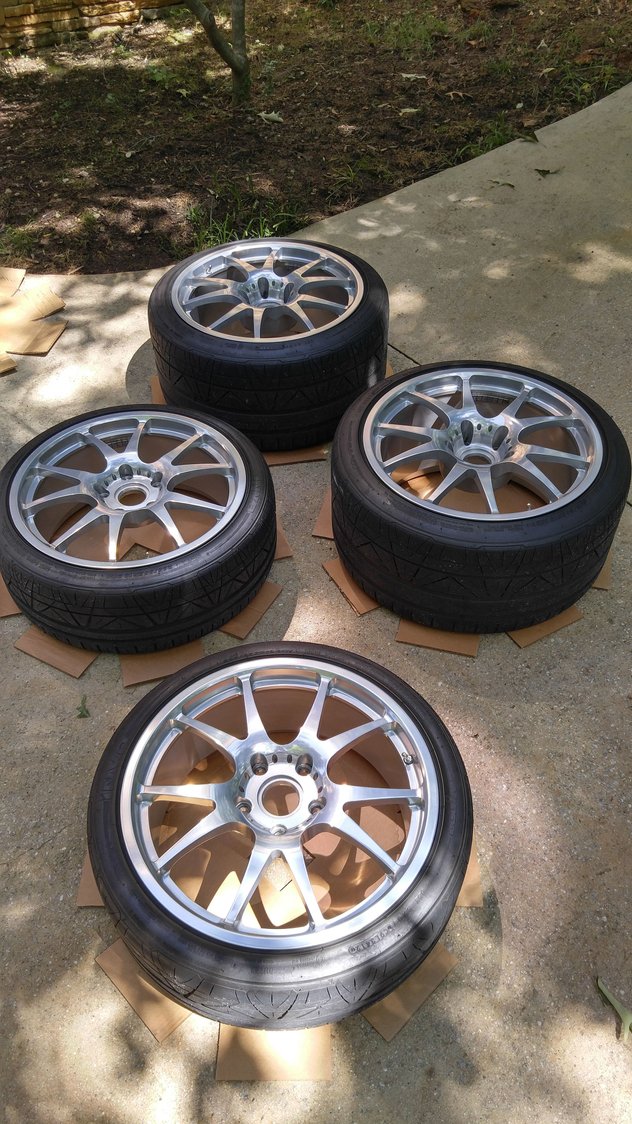

I have these Champion RS171s for sale in The Marketplace. For WB, rears would need spacers.

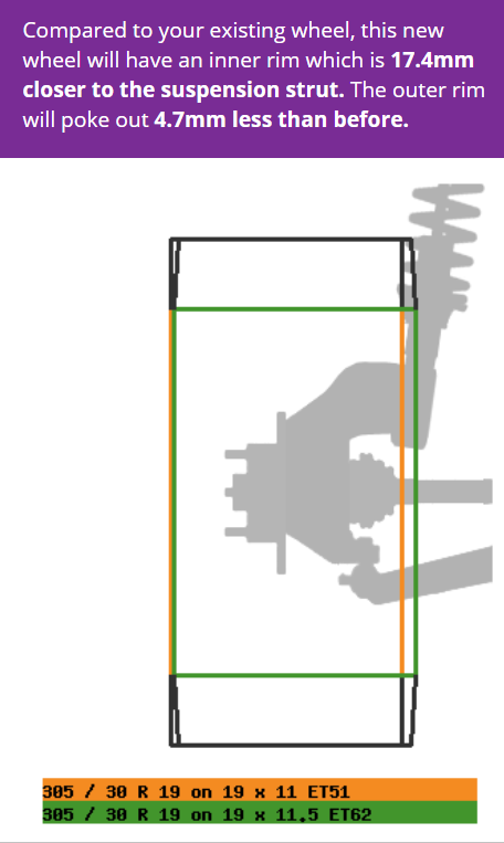

My rears are 19"x11.5" et 62 and factory fitment is 19"x11" et 51 so bolted directly on, you'd get this
where the outer edge would be 4.7mm further in and the inner edge 17.4mm further in. Note that my Champions are 0.5" wider which will help the tire to sit flatter for increased contact patch, vs putting the same tire on an 11" wide wheel and you have to factor this width difference into the offset comparison, which is why I like to use the calculator at www.willtheyfit.com like I did here.
Also, most people think the factory offsets are too conservative and add about a 15mm spacer in the rear. Doing this with my wheels would have the inner lip about 2.4mm closer to the strut (should be plenty of clearance for that) and push the outer lip out about 10mm, which would also improve the look and match it up to the front.

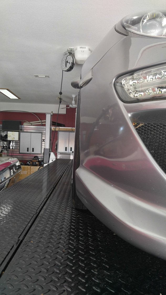

I agree though. I had some fronts on my car at one time that were a 19"x8.5" et 42 that looked like this, which was ridiculous, and made the car very twitchy at high speed when changing lanes on crowned interstates (which are pretty much all of them for drainage).
