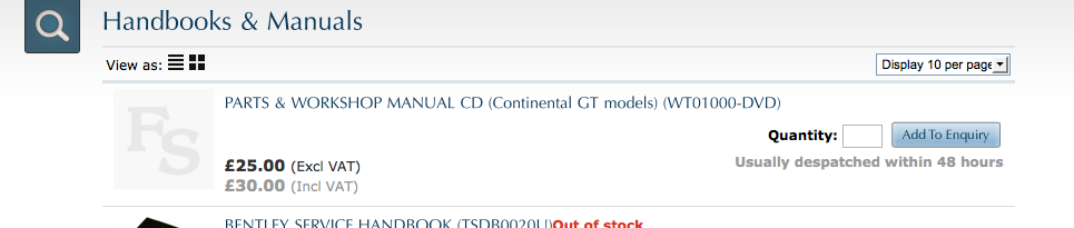

I simply bought the workshop CD from Flyingspares UK, contains everything a dealer has available for repairs

Is this the one you have?

Yes, thats it. It is officially only working for 4 weeks but you can trick it if that time is over.
Simply change the date in your computer before starting the program to a day when it was still valid. As soon as its open, you can switch the date back then and keep on working with it

So if I buy the DVD it technically will only work for 4 weeks?!

Yes. Seems to license online when you first install it. Tried it a month later on another computer and also got the "expired" message there. But changing the computer system time does the trick easily.
