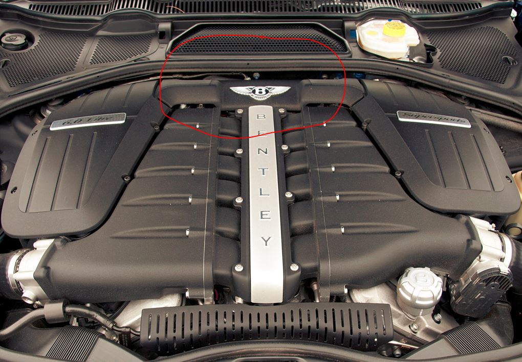

Wondering if anyone encountered this before.
I have a hissing sound coming from somewhere underneath the engine cover. It sounds like lightly pressurized air escaping from somewhere. You can hear the sound when the car is idle, the hood is open and your head is about a foot or two away from the engine. The pitch and the volume of the sound do not change over time - its a quiet, steady hiss. The sound is coming from the area circled in red in the attached image (not my car, but identical engine bay). I discovered the sound while cleaning out leaves from under the hood and I don't remember it being there before. The car drives absolutely fine (no loss of power, no other symptoms, etc). The sound is not related to climate control (I tried shutting it off completely and the sound is still there). My next service is in about 6 weeks so I'd rather wait (I don't want to waste time on dragging the car to the dealer yet). At the same time I don't want to get stuck on a side of the road somewhere.

that's the beginning of the plastic hoses splitting. they are wrapped with a heat shield that will easily slide down revealing the crack on the plastic seams. just up snap the cover pictured with the b on it. and put your hand over the two hoses (about the size of your pinky) mines started as just the hiss I even posted about it long ago was told that it was normal but it will eventually get worse and your pump will start to run more often especially when cold and when you hit the brakes.. maybe Bentley tech will chime in. this repair requires engine out so im going the splice mines and replace with rubber hose.

yep BentleyF is right,depending on year it is engine out,the split usually occurs on the right hand side and can be accessed by removing steering rack heat shield,we used to repair them and then found that on later cars we were getting splits on the pipework that is attached to transmission,the two hoses that join the intake are also prone to split and are easily replaced,not sure you can buy them separate but certainly can find after market bit of hose,best thing to do is carry out a smoke test from the vacuum tank and block off the rear pipes that go to exhaust flaps etc. this will give you a definitive answer to whether you have an air leak.

the cover with the flying B on just pulls up,the hoses are vacuum lines,there is a vacuum pump in the left hand wheel well on left hand drive cars ,from there the hoses go to engine,brake booster and to rear of car for exhaust flaps. if you pump your brake pedal continuously you will hear the pump run and if it does not shut off pretty quickly it usually means you have a leak,like i mentioned the best thing to do is carry out a smoke test.if you have factory warranty you have nothing to worry about and although engine out is a big job i have done loads and you would never know it has been out once they are finished.

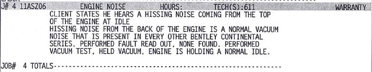

Here is what the dealership had to say:
Question for Bentleytech - do you think they are not doing enough troubleshooting?

if they have smoke tested it and there is no leak then there is not much more they can do,these engines are noisy and maybe you just did not notice the noise before. at that top end of manifold it does sound a lot.
