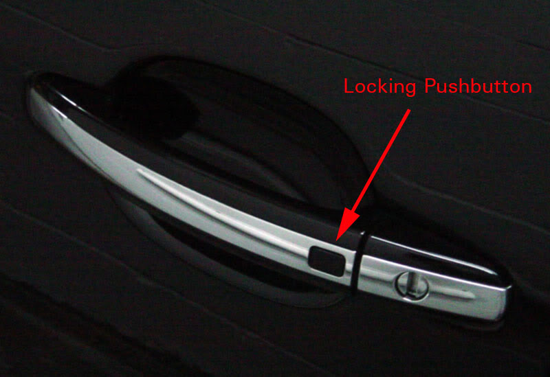

Keyless Access Locking Pushbutton
my Keyless entry Pushbutton not work.any skill to reset or

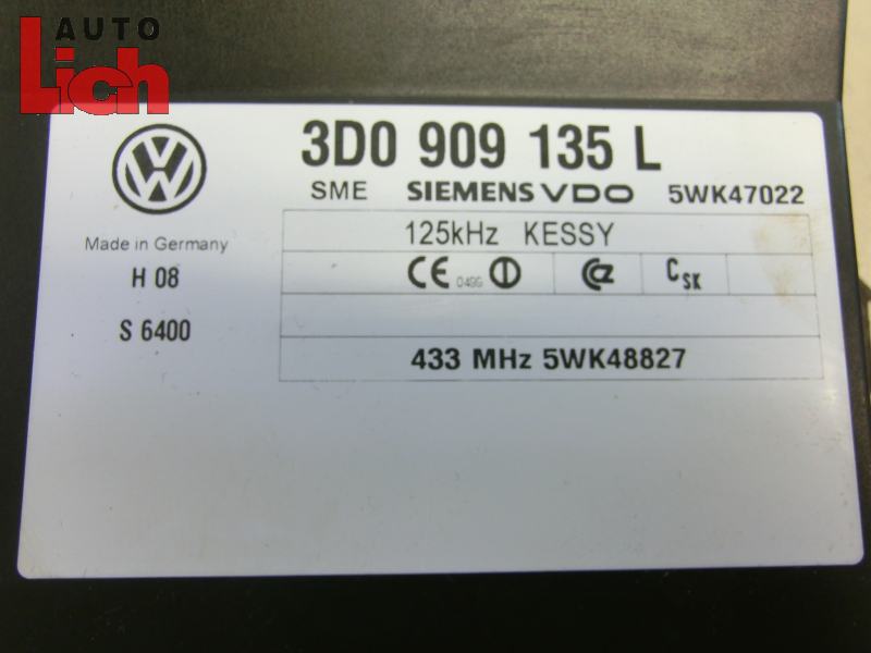

no water under carpet..the button it just work once after re-programm.check all cable connect is fine.they said the problem should be from the keyless module 3D0909135L ..i try to find it from internet..no luck..must buy brand new

The keyless entry module (kessy unit)is under carpet at front.

Plenty on eBay not G,J and N versions so not sure if suitable.
How much is a new module?
J

those for VW or PORSCHE...i dont want to take risk.but hard to find one on net..!!!

that pic is my car.i took it because i ask them open it for me.i need make sure the look & parts number.really hard to find for bentley gt

found two on net.
http://www.ebay.it/itm/VW-Phaeton-3D...-/350778182828
parts number is same.KHZ&MHZ is same...but H 08 on left no. is different from my one H10..
i also found the one can order..the pic not clear is H10 or H8...!!
http://autodijagnostika.biz/en/polov...-5wk47022.html

this parts number kessy 6610 (Bentley GT - canada) mine one is 6400(Bentley GT - Phaeton US)...my car from UK right hand drive...so ?? really mixup..
http://www.ebay.com/itm/161032094695?_trksid=p2050601.m570.l5006&_trkparms=gh1g%3DI161032094695.N21.S2.M2870&autorefresh=true

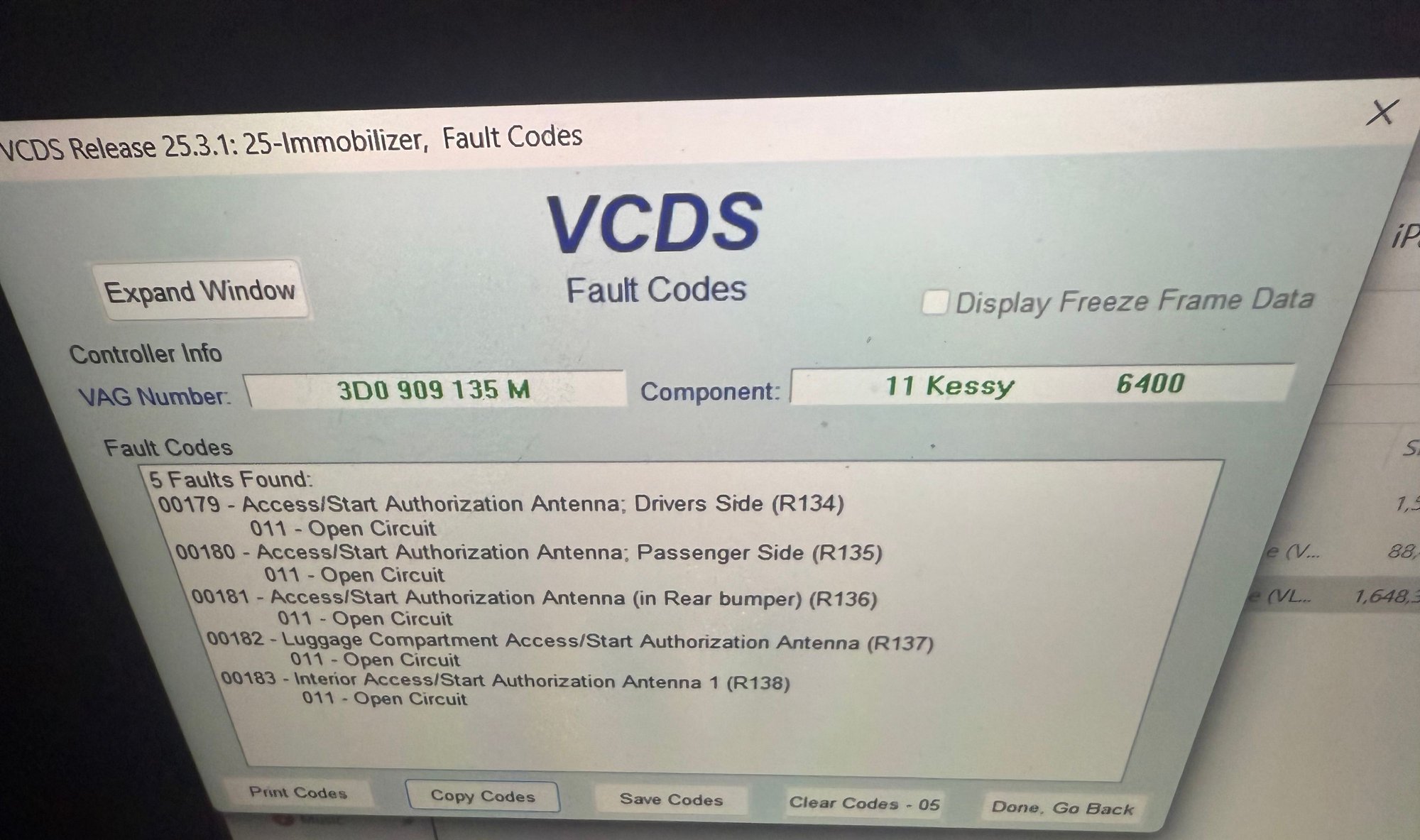

Keyless entry work after codes cleared and then stops working
I’m trying to get my keyless entry to work on my 2004 GT. After I clear the codes in the immobilizer, the buttons works but then after a few minutes the following codes come back.
The floor is dry.
