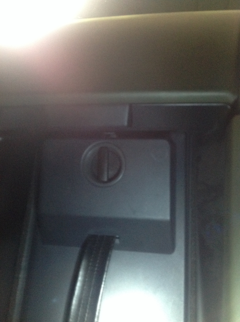

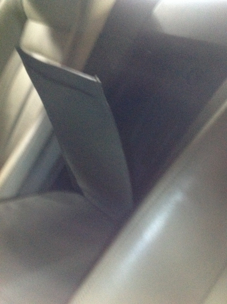

Still cant really work out the problem so i have attached a photo.
It appears the hatch cover sits too low so the catch at the top doesnt quite reach the slot to hold it up.
Also , what is this leather flap supposed to do ? It just sits in mid air, and doesnt look correct.
Thanks
Digger

thats the problem i am talking about,the catch has broken or warped and won't hold the hatch up.the leather strap should be looped and when the hatch is down you can reach through and pull the panel up to latch it.
