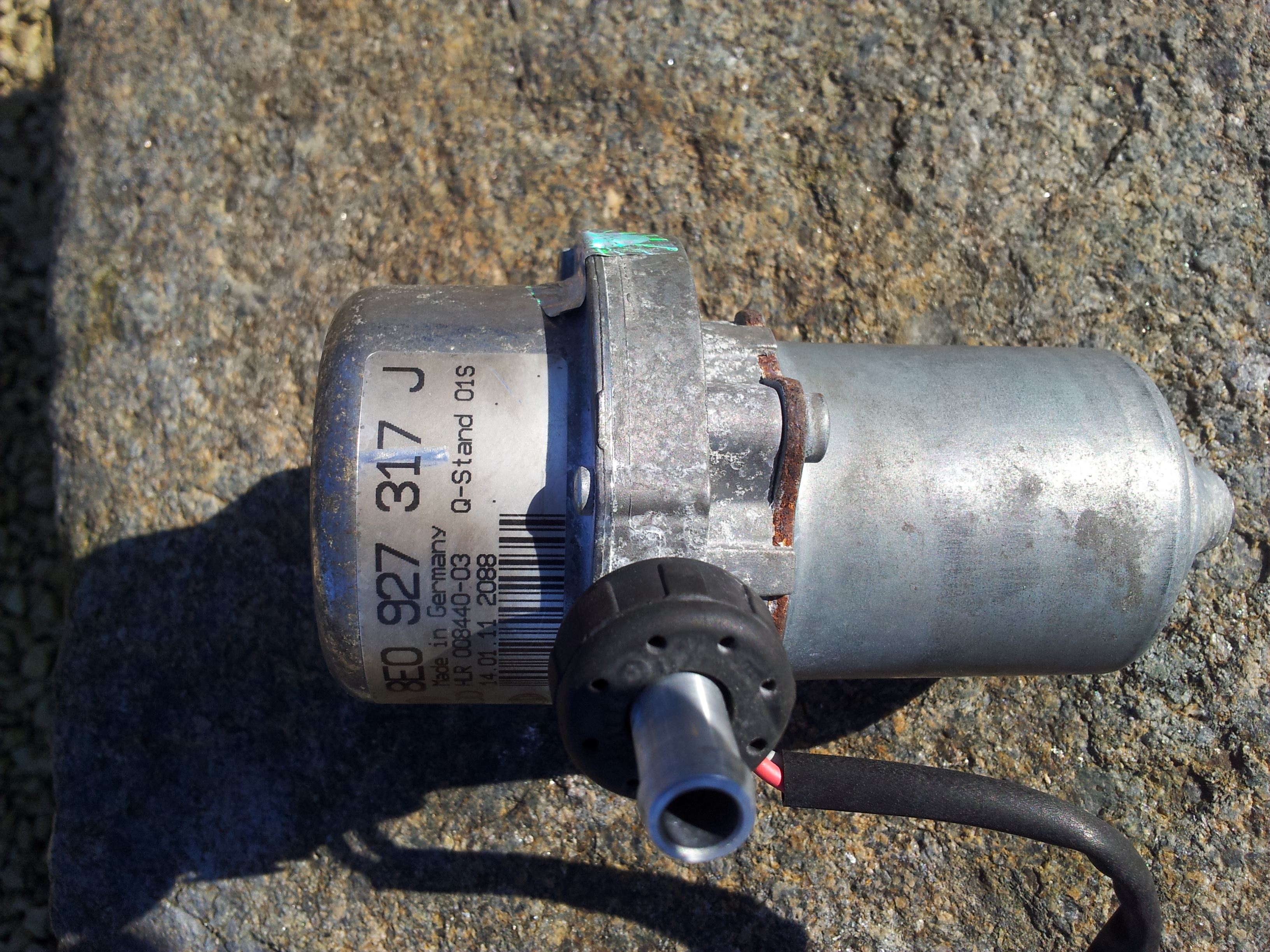

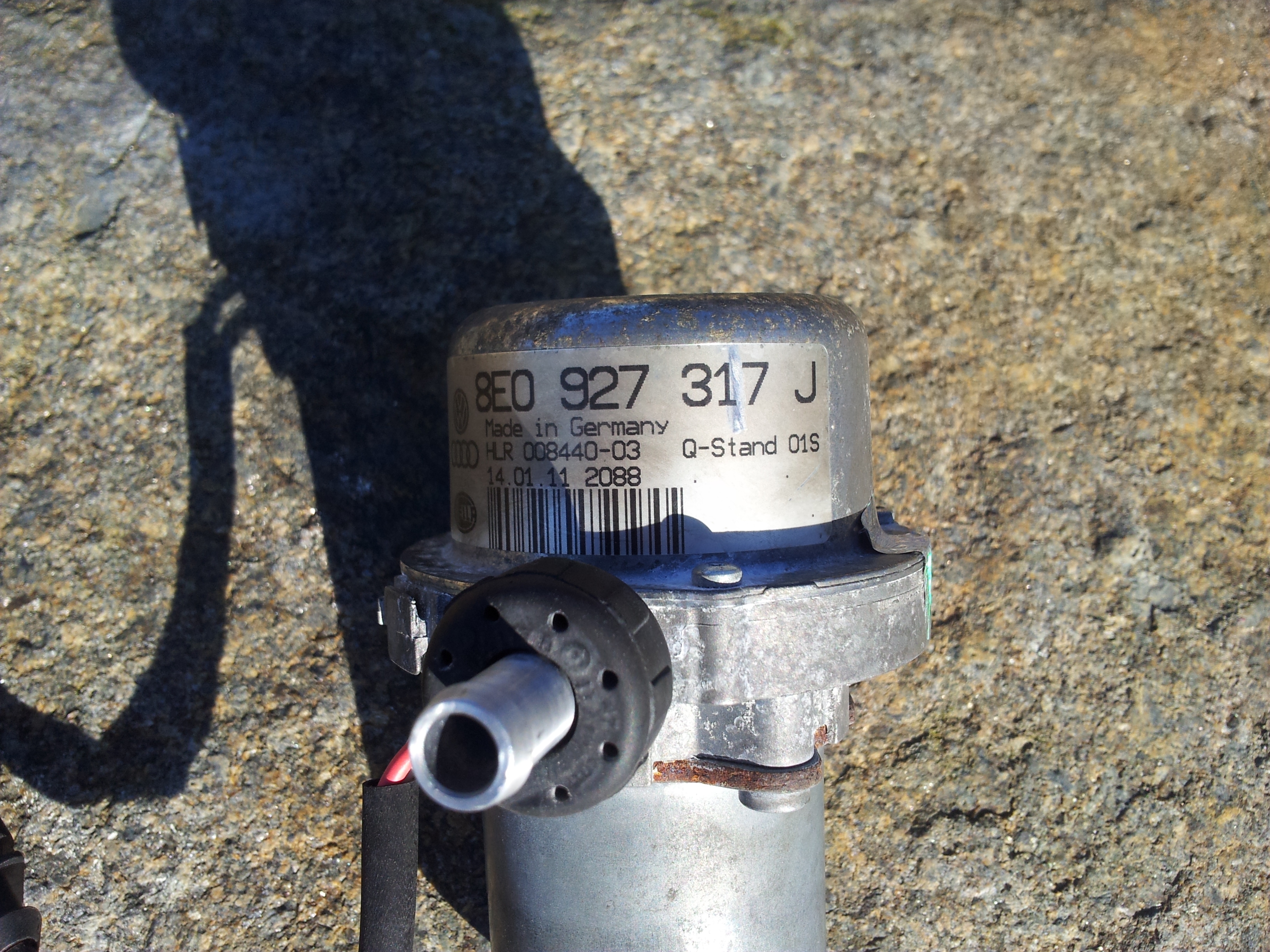

I reckon that the electric brake vacuum pump is shared with a number of vehicles, VW and AUDI use the same one with part number 8E0927317.

With reference to my last post, my vacuum pump has given up the ghost and blown the fuse. I suppose it wore itself out when I had the leaking pipe.
My pump part number is 8E0 927 317 A. It has VW Audi markings.
However, I have found a replacement with part number 8E0 927 317 J
The replacement is from an 2011 Audi A8 W12 and it looks identical.
It should be here this week so I just hope it solves the problem.

Here are a couple of photo's of the Audi A8 W12 brake vacuum pump.
The only difference to mine is the letter at the end of the part number.
Cost new is over £300. My used one from Ebay Germany was £64 delivered.
I just hope it does the trick.

Firstly. Sorry for the size of the pictures in my last post. Not sure what I did wrong, but I have an idea.
Anyway, after a couple of hours, the replacement pump is in and running perfectly. Even the electrical connection was identical so it was a breeze to do.
The most fiddly job was removing the inner arch liner. The pump is easy to get to after that. I think I saved a whole lot of money there.
I also noticed whilst doing the work that the upper suspension arm is marked with the 'Audi' symbol. So there is another part that is interchangeable.
