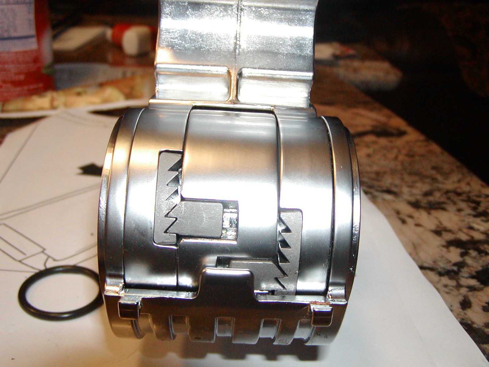

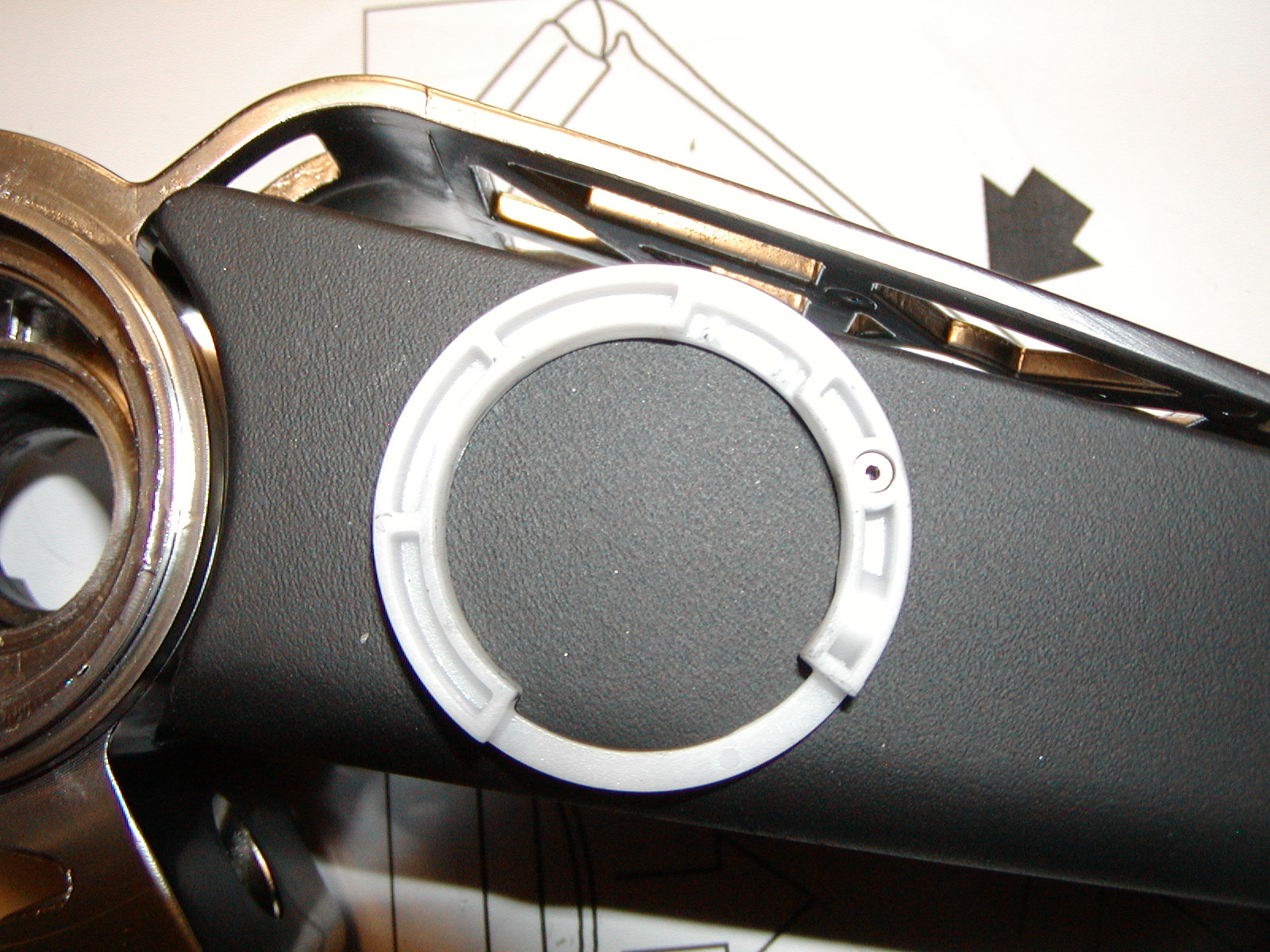

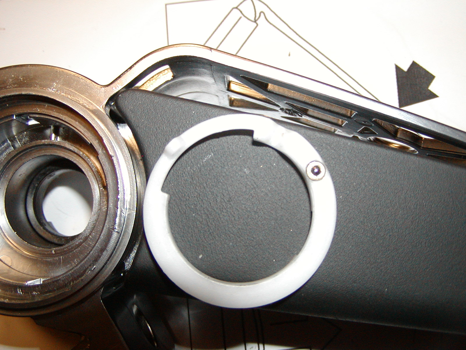

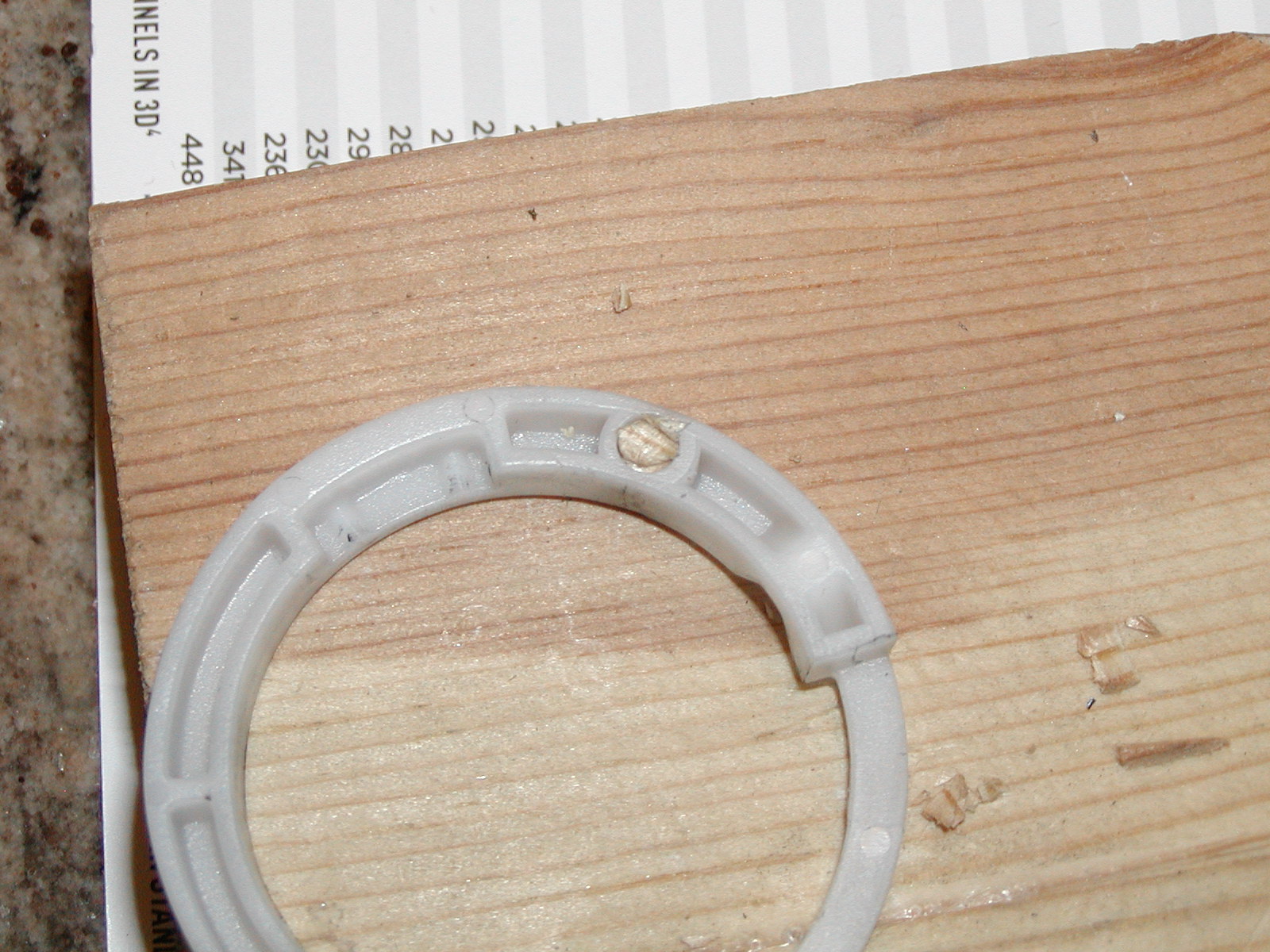

part
Most likely nothings broken.
pix brass detent shows it inserted into the plastic collar, the hole goes all the way threw see pix back side. so what i did because the plastic rides right against the metal, so I pushed the brass flush to the front and filled the back so it could not push away from the ratcheting parts.
ID:	408480   Click image for larger version
Name:	brass detent.JPG
ID:	408481   Click image for larger version
Name:	fill back side.JPG
ID:	408482   Click image for larger version
Name:	racheting parts.JPG

G L about a year ago mine started like yours untill it got stuck in the open postion. Unfortanitly it will not fix itself. Bob
