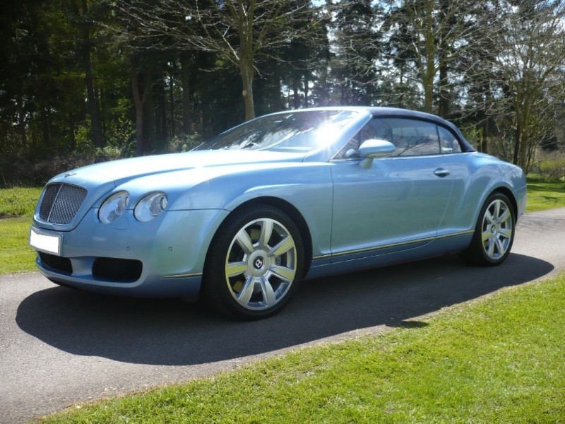

Going to look at a GTC tomorrow advice please ?
I was looking at Maserati Granturismo/cabrios and had a look inside a GTC and wow had a test drive and was blown away with how special the car felt , made the maser interior look like an old fiat ...
I am looking at one tomorrow with a view to buy if all good :-)
Advice gratefully received ???

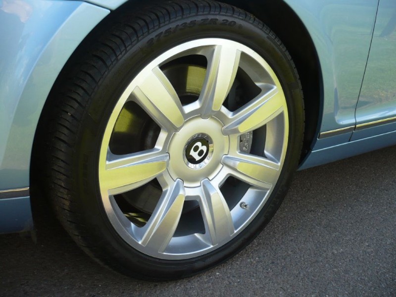

Brake discs discs/pads
Any other concerns I should look for car is a 2007 42k miles and 8 service stamps Bentley /specialist so sounds promising :-)

Check to see if they did the false air / hose fix atop the transmission ($3500) and the convertible top is known to have the rear window become unglued. Especially in places with high heat (FL, AZ, etc).
Also check the top for pinholes by the rear third 'bend /elbow' and how the top folds down, as the top has bits that break and thus the top does not close smoothly / properly and rubs the body of the car as it goes into the 'boot' storage.
