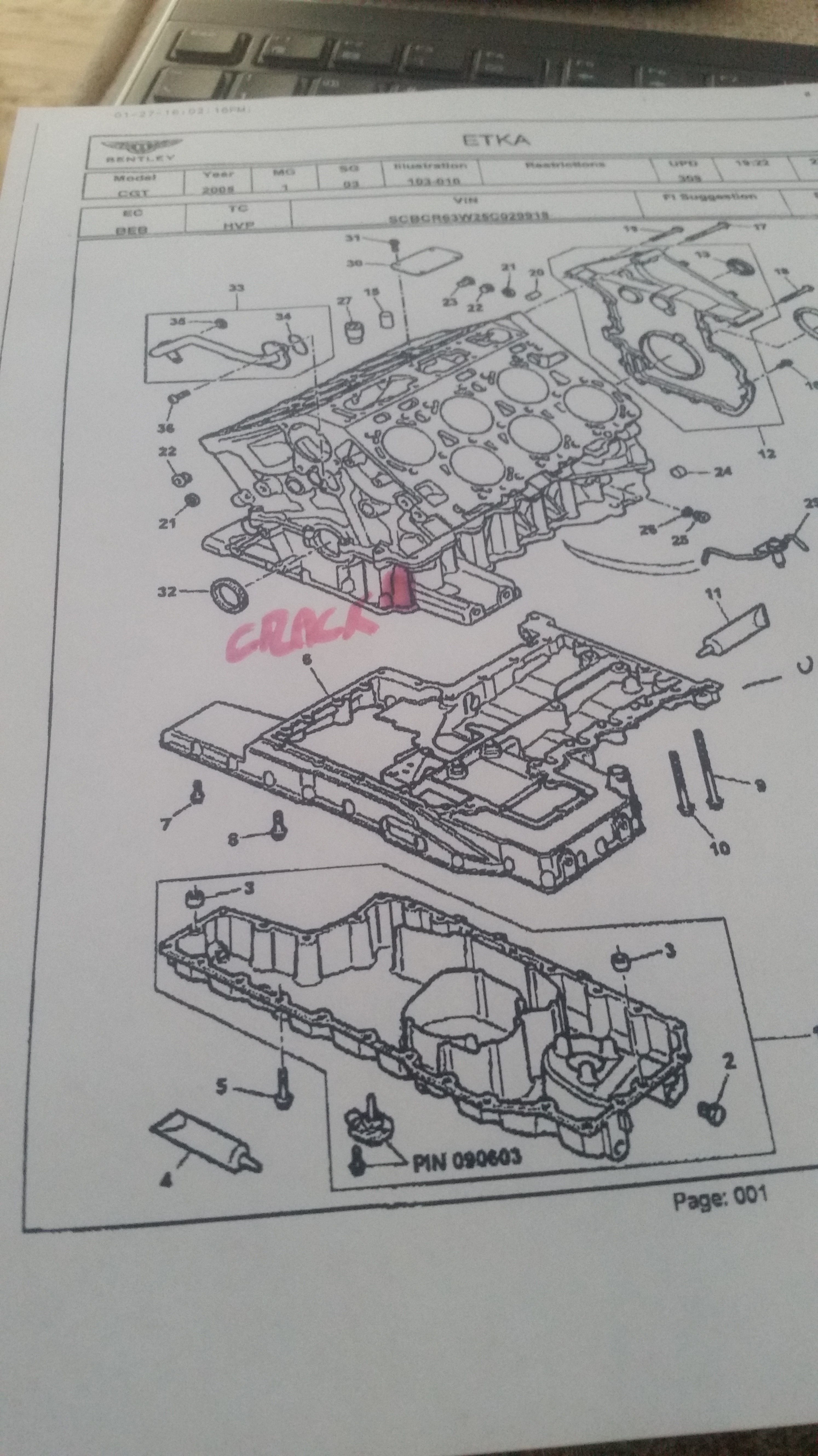

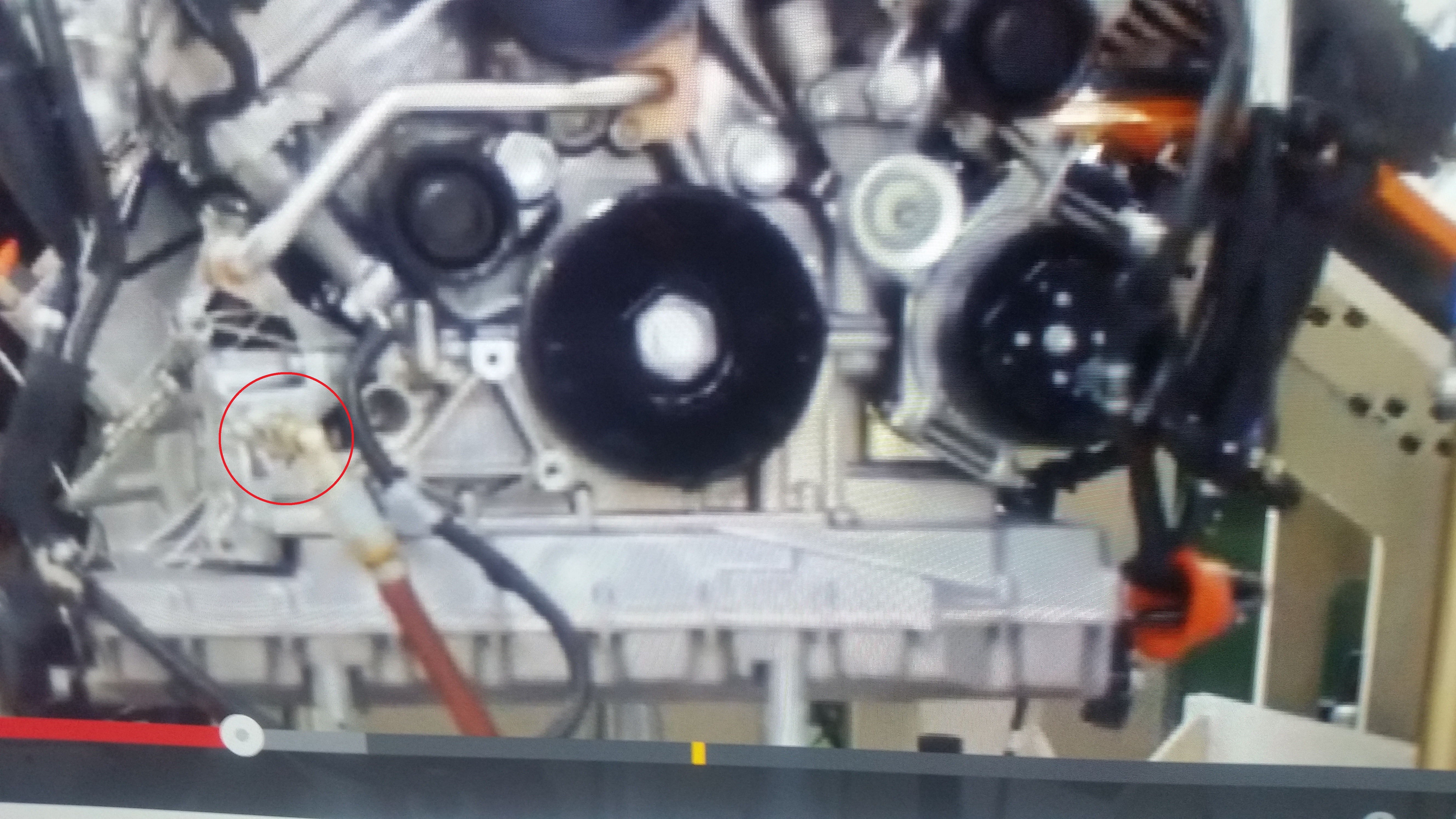

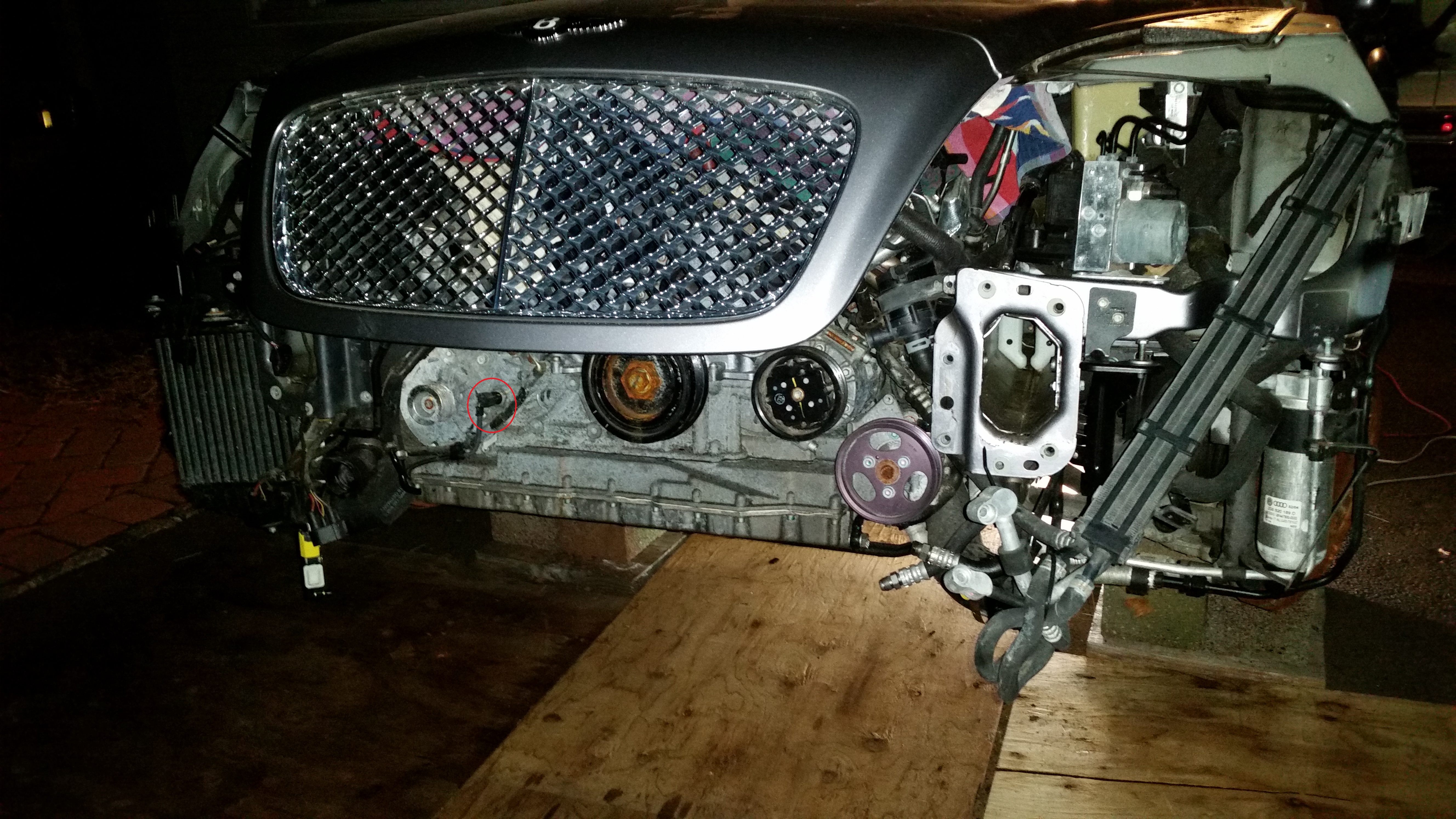

I believe it is #22 in the attached picture, also see picture with pressure test hose attached for factory testing.
Please ignore the "crack" and pink area, this was what I used the enlighten a seller that the pink area that was badly damaged on his unit was indeed part of the block girdle and not a pan area as he insisted.
