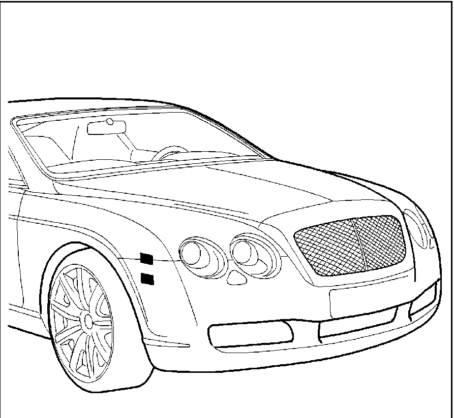

Remember to press the buttons on the centre console before you jack the car.
Here's how;
Here's how;
Nice reminder. Thanks.

I printed one off in A4 size and keep it on top of the spare wheel next to the locking wheel nut adapter.
Les.

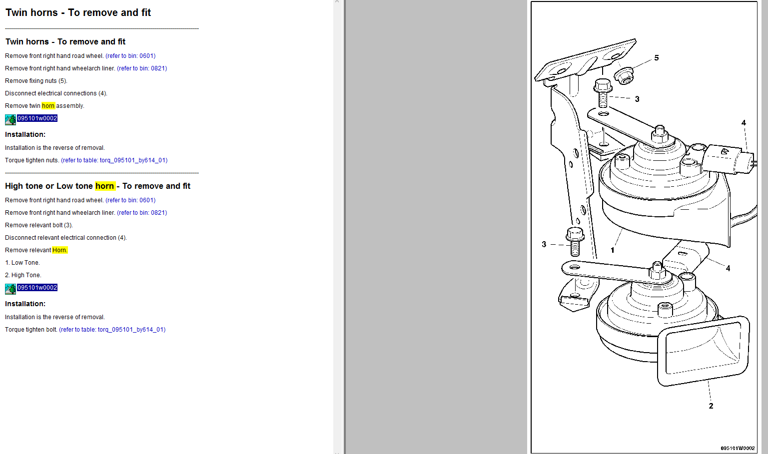

Hi Mr Vette,
I just bought a Bentley workshop manual CD (got one few yrs ago but misplaced it).
