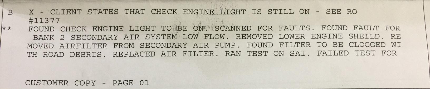

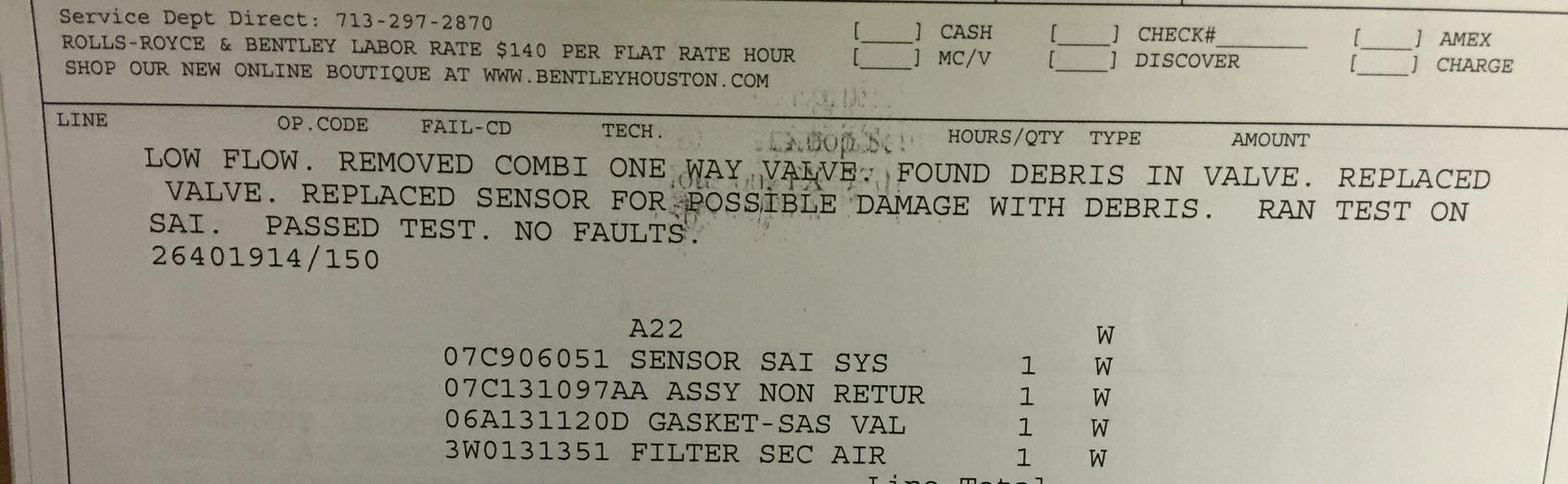

i went through the paperwork the previous owner gave me and it seems like the car has had a similar problem in the past (not sure) but from what it sounds it is, you be the judge, PLEASE NOTE this is from the previous owner, nobody has looked at the car yet on my end.

Old Aug 31, 2016 | 06:58 AM
stevenrmusic's Avatar
Joined: Apr 2010
Posts: 2,730
From: Worldwide
Rep Power: 147
stevenrmusic has a reputation beyond reputestevenrmusic has a reputation beyond reputestevenrmusic has a reputation beyond reputestevenrmusic has a reputation beyond reputestevenrmusic has a reputation beyond reputestevenrmusic has a reputation beyond reputestevenrmusic has a reputation beyond reputestevenrmusic has a reputation beyond reputestevenrmusic has a reputation beyond reputestevenrmusic has a reputation beyond reputestevenrmusic has a reputation beyond repute
Interesting. A smoke test is a good start and your Bentley mechanic might find the solution as it seems there are a variety of situations...... Let us know how it goes.

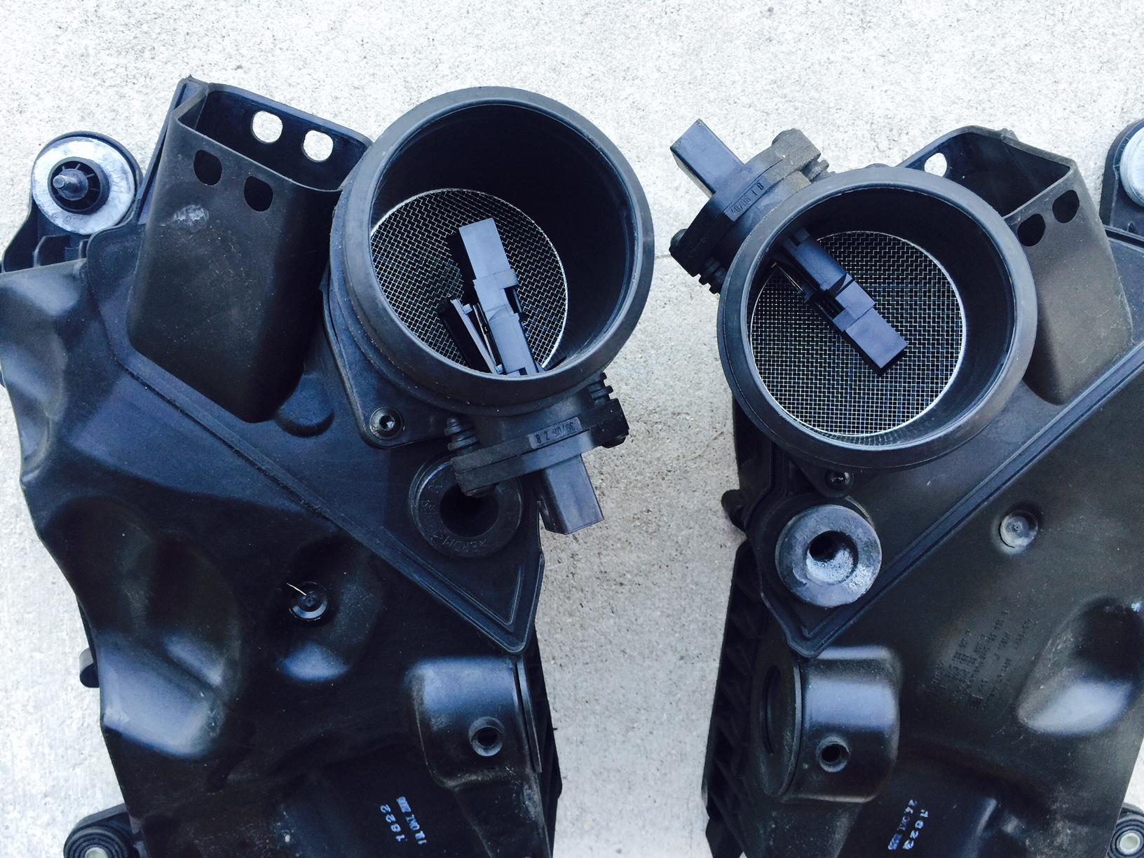

Does the car normally run rough when that particular vacuum line is busted ?? or would it still drive normal ?? I took the Mass Air Flow Sensors off and this is what i found so far, seems like one of the MAF's sensors is broken, could this be the issue ?? i'm leaving to work and will continue to diagnose the car with the smoke tester since i have to borrow it from a friend.

Old Aug 31, 2016 | 07:39 AM
Joined: Apr 2010
Posts: 2,730
From: Worldwide
Rep Power: 147
Hmmm... not sure and we have a tech or two here that am sure knows more than me. When the hose above the transmission went on the 07 GTC here the idle was rough from time to time, but not always. There is the common:
Possible broken oil dip stick top. Remove stick and see if the top plastic on the car or stick assembly is broken.
Broken plastic 'Y' connector for hoses toward rear top of engine
Am sure there is more, yet a smoke test is inexpensive/easy and that helps to see if all your lines are good. Hopefully someone with far more experience than i chimes in.
