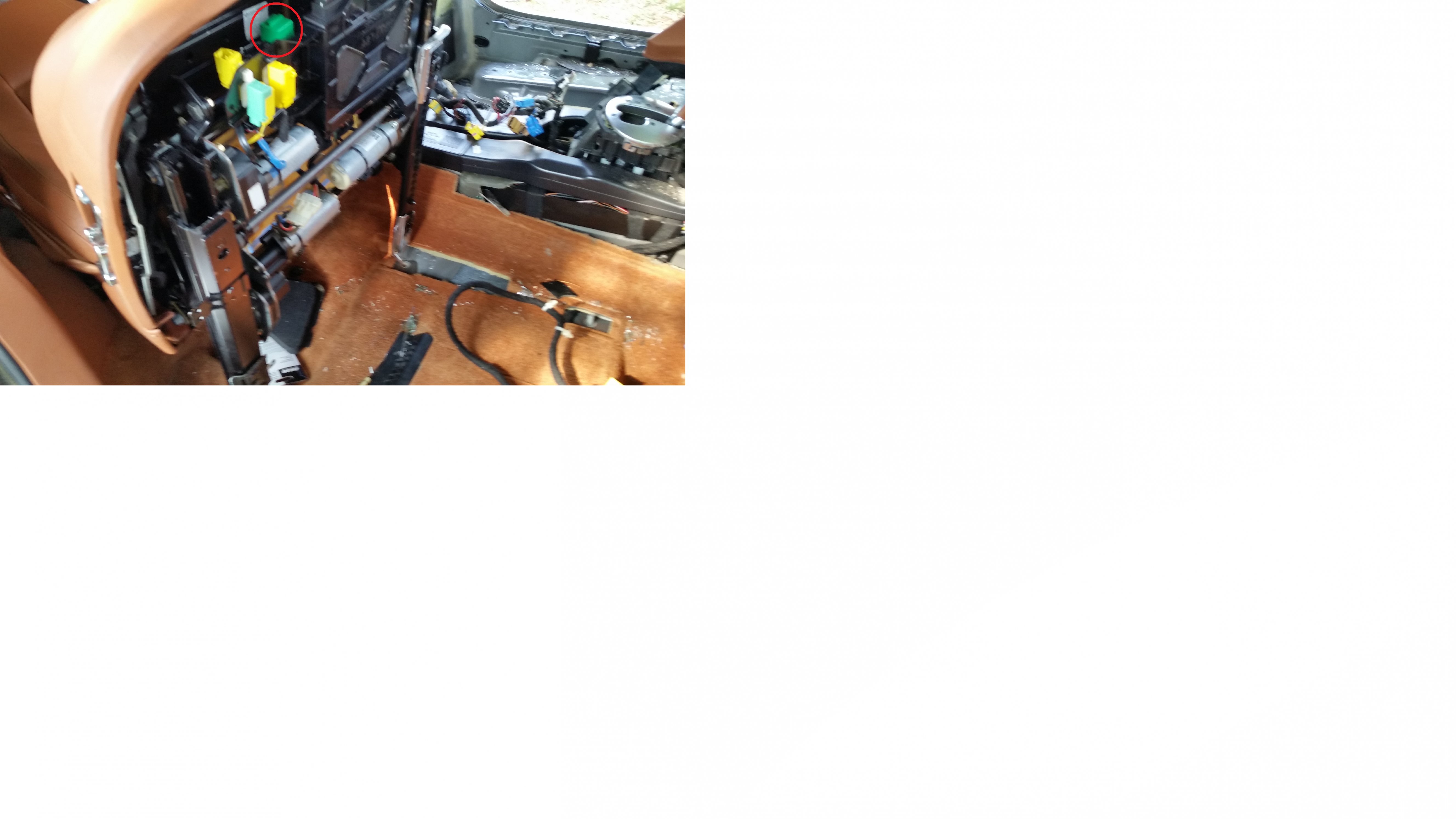

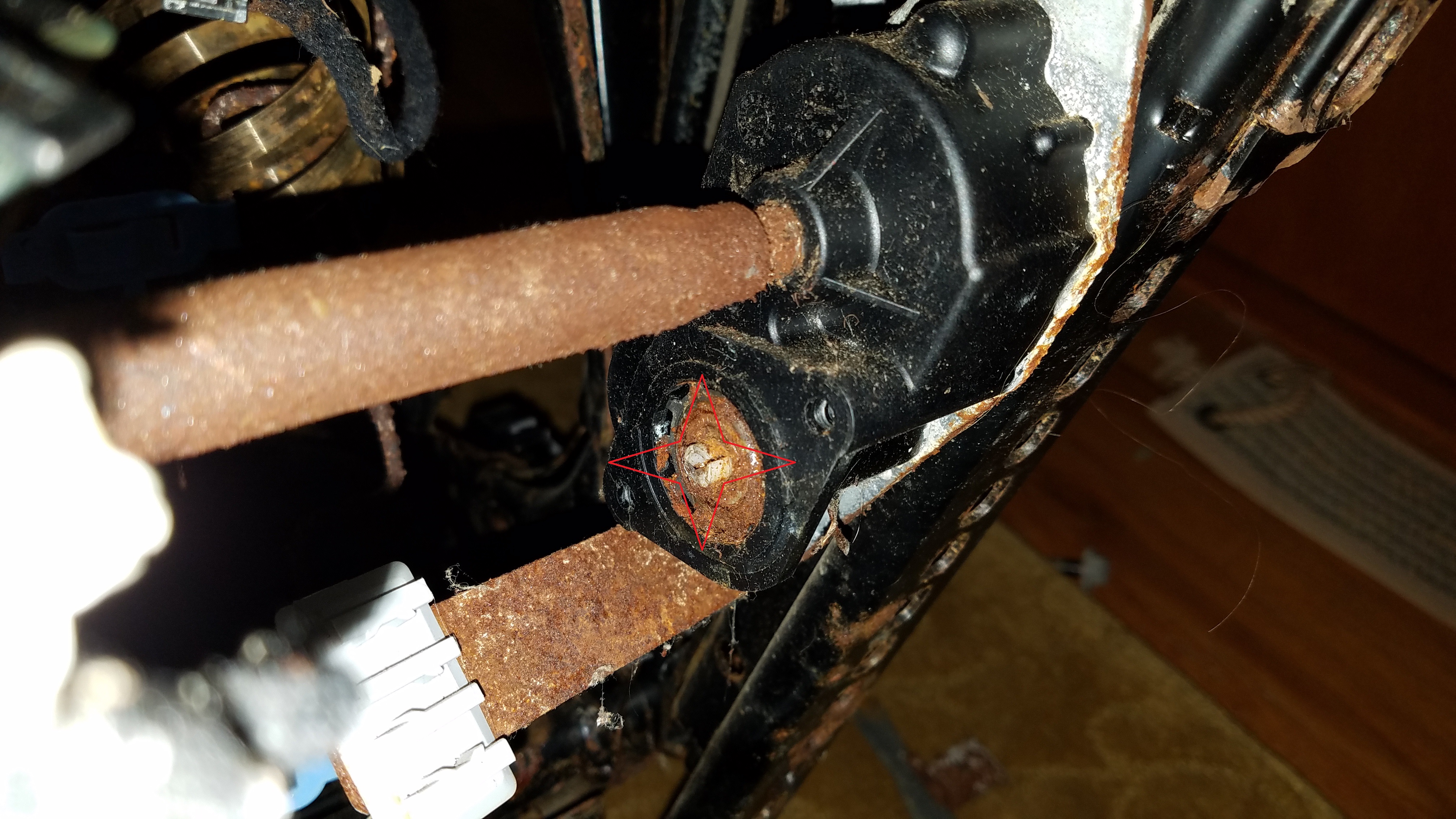

As far as your comment "and surely there must be a way to manually get the seat more forward..", YES there is, BUT it will NOT be easy, you would lift the seat upward to the highest position front and back, next pop off the black plastic cover for the seat module (front of seat), now it is time for you to determine if it is a switch, the module, or the forward/reverse electric motor, the F/R motor is the one by itself on one side, meaning you will see 2 motors on one side and one on the other, (being you are RHD, and we are talking about your driver seat, it should be the one closest to the console) you should first while holding the switch in the forward position tap on the motor with a metal object and see if you get any movement, like on an old engine starter motor, ALSO I should have asked this first, BUT do you hear any sounds at the bottom of the seat when putting the switch in either forward or reverse position, as in clicking or clunking, if no go still, you can disconnect the module plugs on both sides, being there are plugs on both the front and back of the module, check all connection to be clean, and reconnect and test, OR this is up to you, while the module is out of your way you can access the 5 wire plug for the F/R motor and apply power to 2 of the 5 wires,+/-, AGAIN this is up to you to figure out, NOW if the motor is indeed shot, then the only way to move the seat forward or back is to remove the motor while the seat is bolted down, and here is why, as with my rebuild the electric motors were shot from water damage and the seats were stuck in their positions, the problem is when the F/R motor does not function you cannot access the bolts and nuts that hold the seat down, SO here is what I did, I learned on the drivers seat (USA LHD) destroying the F/R motor/transmission assembly as I just wanted the seat frame out, (and the motor/trans is still on EBay cheap) I then saw how I could remove the other with no damage, I removed the F/R motor held in by two 25 torx screws and inserted a old speedometer cable into the F/R transmission, and the other end into a screw gun, that allowed me to move the seat F/R with no problems, NOW getting to those 2 torx screws is a royal PITA, but doable.
Good Luck !!

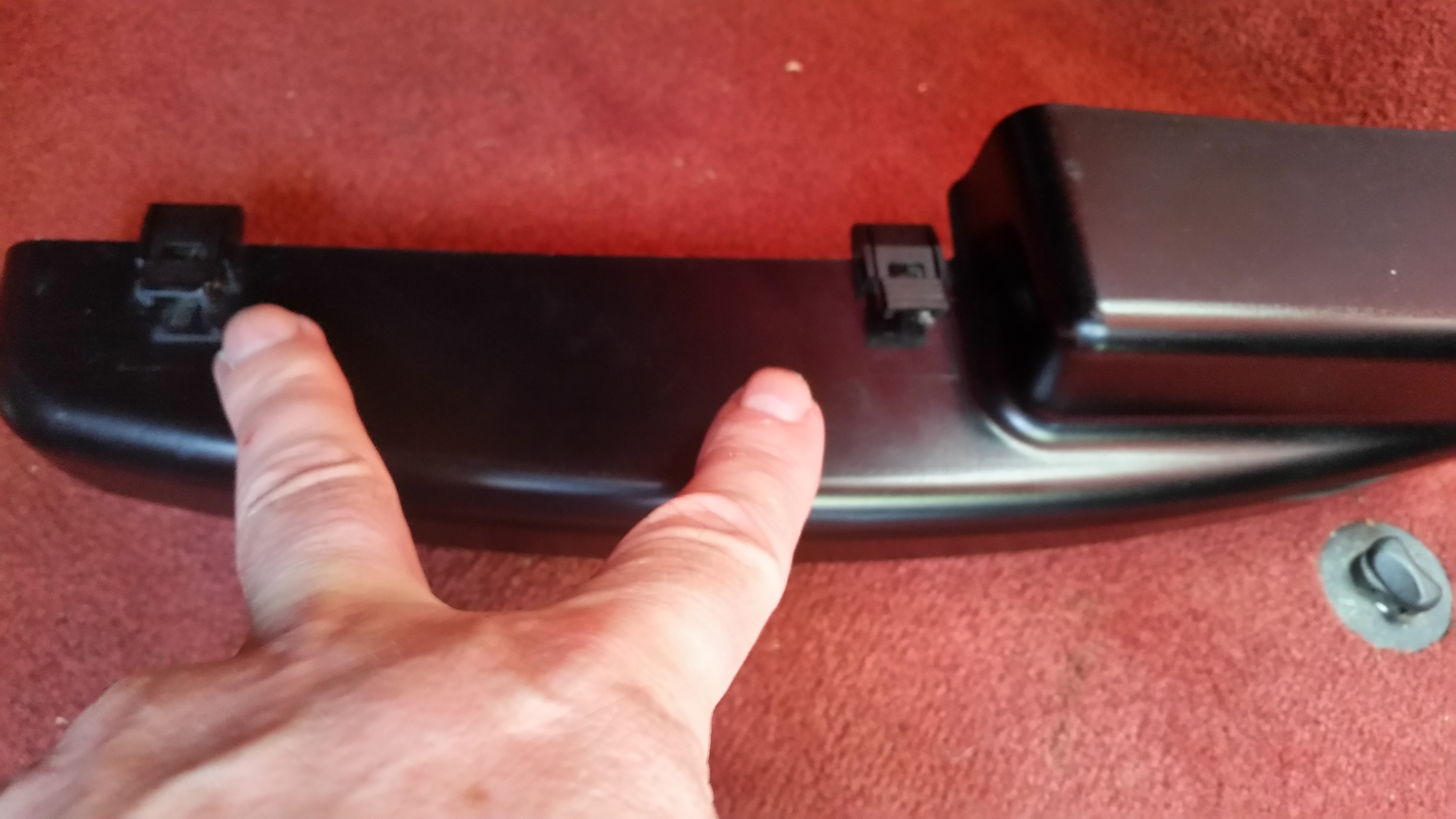

Also, is there a trick to the lock on the plastic cover under front of seat ..I've tried lifting two "click-in fasteners" simultaneously, but the plastic doesn't come off with careful force (don;t want to break anything - plastic can be brittle)..

So disconnecting both batteries for a few hours had no effect at all. I did manage to get the tight plastic cover off though, to reveal lots of cable connections..
As for "clicking in" - operating both the main control and the arrow buttons on top of backrest you hear a clear "click" from pressing backward movement (the seat would probably move too if not already furthest back position), BUT no click and no sign of life when operating / pressing forward buttons.. What does that tell us ?
And, the F/R motor/transmission being towards the rear of the seat, I cannot even see it from the front (at least not without removing the connections boxes in front...how to actually get to the motor seems a bit of a challenge.. Is there a control module that could perhaps be faulty and could be more easily accessible? With the motor itself, given that it is operating taking the seat rearwards, and that the unit "clicks in" on "rearwards command" but no click is heard for "forwards command"..doesn't that indicate a relay or module issue rather than motor itself (and why would it blow just like that, and one direction only)? Perhaps it is time for a trip to the dealer to see what they have to say..

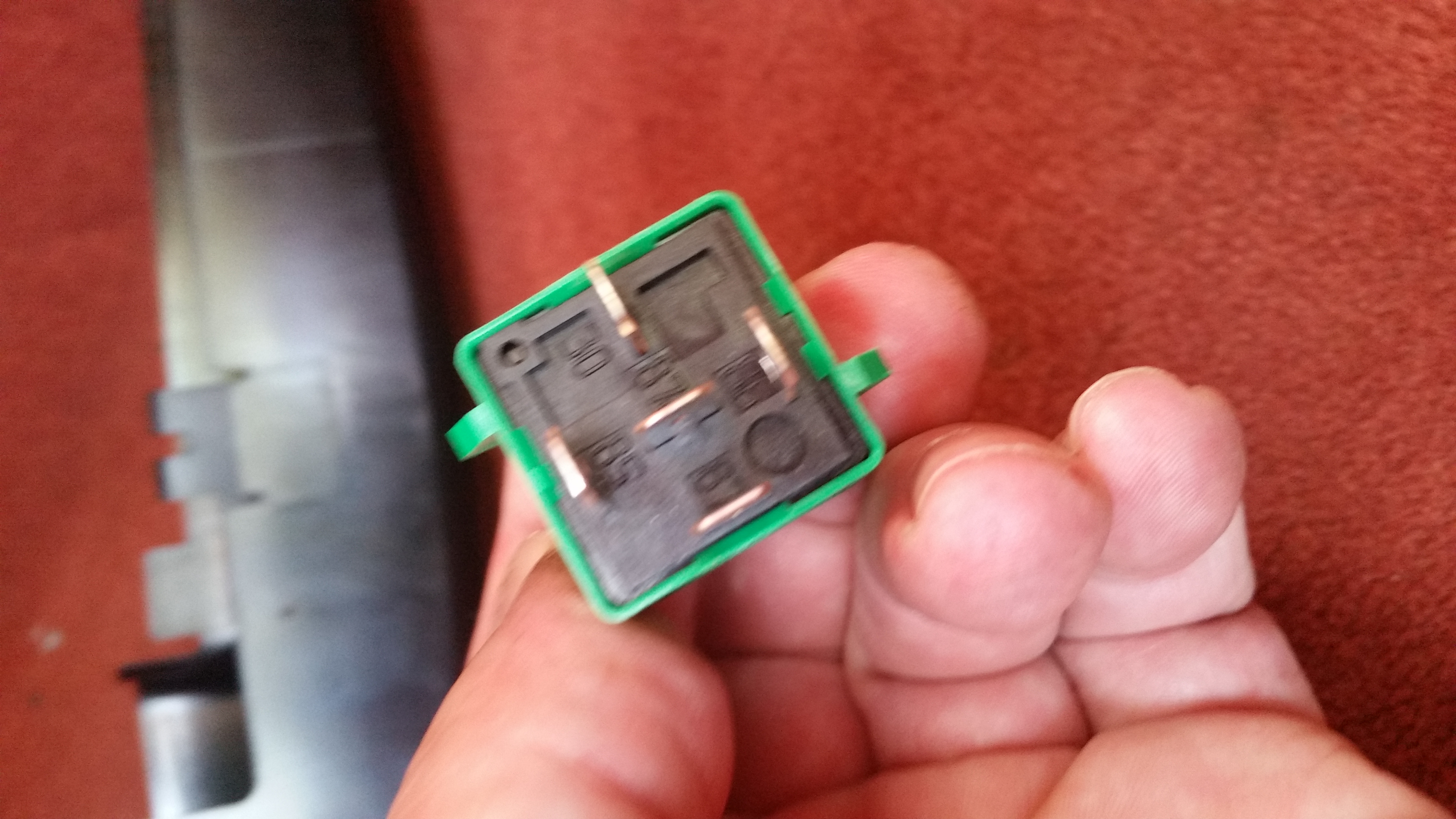

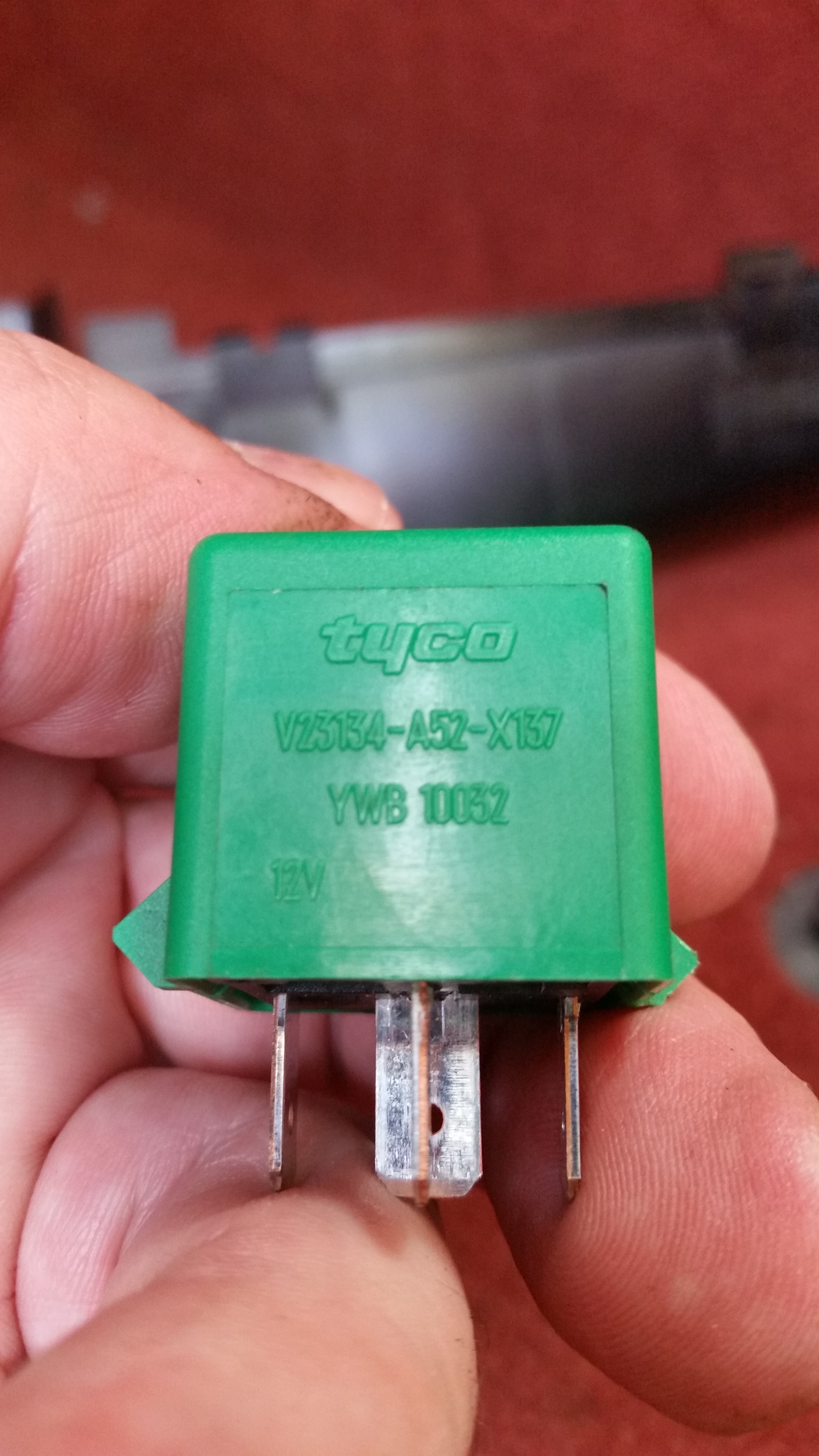

Hello Lars,
I went out and pulled my cover off to expose the control module because while I was out last night I had a thought and now see you had the same, the "RELAY", So I moved my seat forward and back and could only hear a slight clicking, and that clicking was from the control module itself not the relay, so I felt the relay while switching between F/R and nothing, no feeling of click, SO I pulled it out (PITA) and guess what, all other functions still work except F/R, but I can still hear the slight clicking for reverse but no movement of F/R with the relay out....
The GREEN RELAY location can be seen in the prior posted picture of the seat lying on it's back, and here is the relay pulled.
Also for future knowledge the F/R trans/motor is in the middle, the trans/motor towards the rear lifts the rear of the seat up & down, as does the trans/motor towards the front does the same for the front of the seat.

I would NOT take the relay from the other seat, it is a PITB's to pull out as it has two locking clips of the sides of it that risk breaking, just pick up a relay of the same design from parts store to test.
