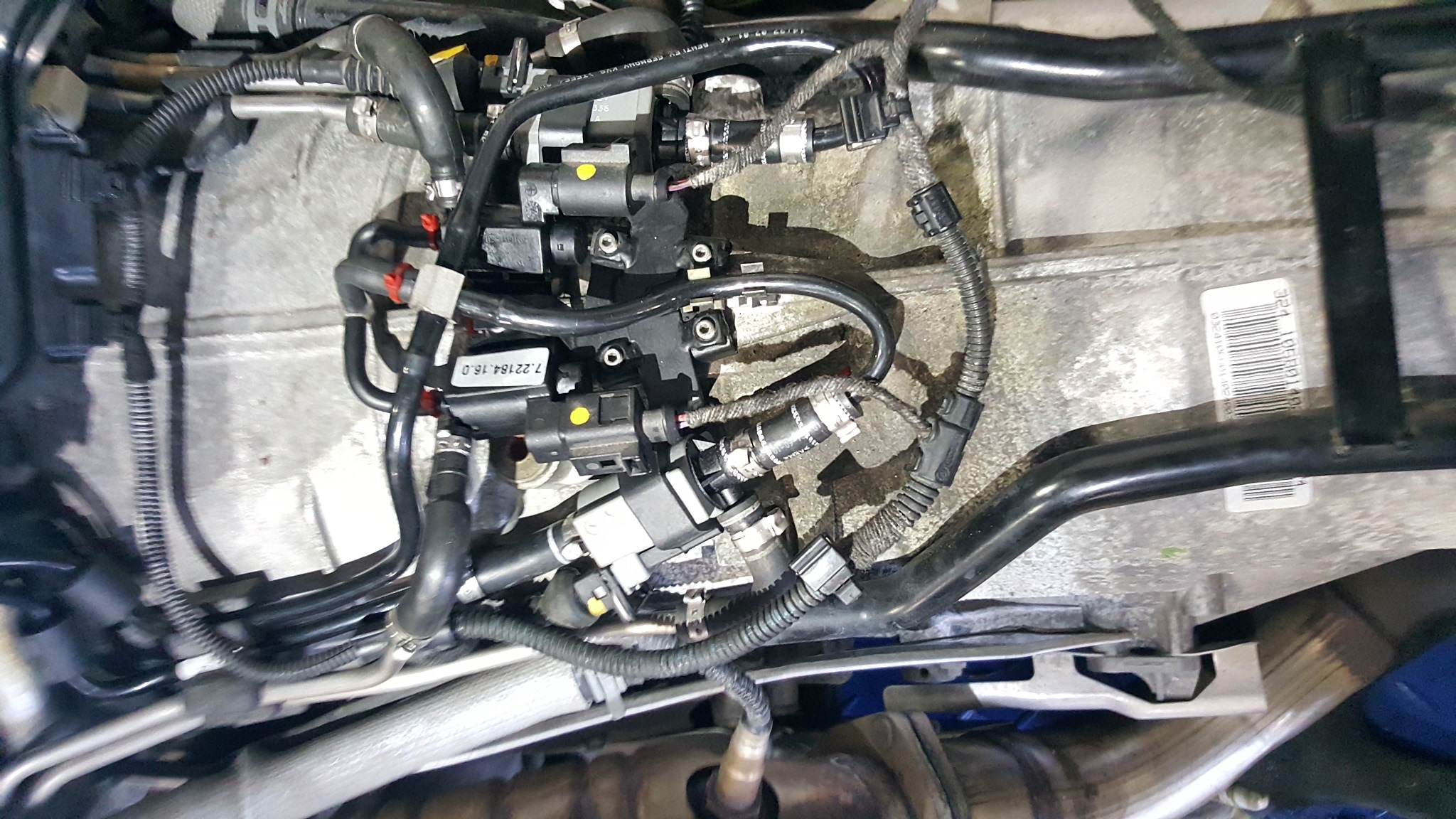

Here is a picture of the transmission top vacuum plumbing. I took this recently when a local 05 BCGT had the engine out. I have more shots from different angles if you would like to see.

Had a look today on the vacuum lines on top of the transmission and they were all cracked:

Am curious what is making these OEM hoses consistently crack? Bentley just replaces them with like-hoses made of rubber and not a full redo with a better system. Is the problem the lack of quality of the OEM (circa 2006-ish) plastic formulation, hoses too small for the junction, too much heat in that area, or ????

My Indie did tell me that the new hoses were upgraded from the original spec'.
Fingers crossed.

Now its time for fixing the vacuum lines. Thanx Johnny for the offer with your extra lines, but I am in a hurry getting this done, so I made my own. It was a real pain to make, but turned out OK....
Got me some hose and steel brake lines
Bend to fit exactly to the original crap hoses
Meassuring up
Installing
All done. It was a pain, but never again am I going to have cracked vacuum hoses

Here are some more updates. Today, I fixed the vacuum hoses behind the steering rack on the firewall.
Hard to see , but hoses are split here too. Seems like they like to split on these nut looking tees, both on top of the tranny and here.
Everything fixed now
Fixed
Time for another smoke test Everything is good and never vacuum leaks again here
This is what the plastic lines behind the steering rack looks like
