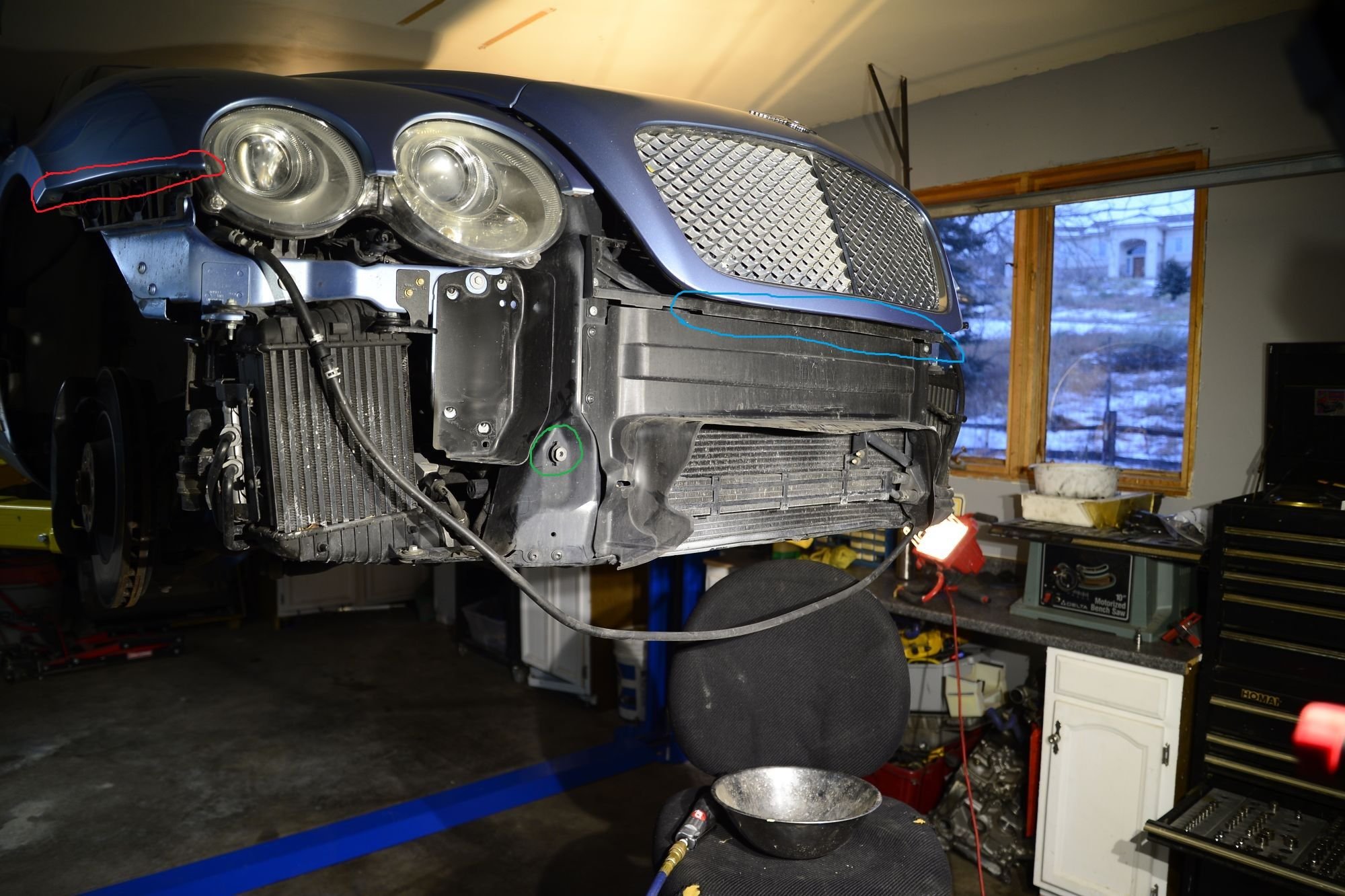

The bumper cover comes off really easy. First off. The picture shown is with the steel bumper removed already. The blue circle shows 6 fasteners securing the top of the bumper cover. The green circle shows 1 of the 2 fasteners securing the cover, mounted inside the air vents. The red circle shows clamp on strips securing the cover to the fenders and also has a fastener inside each wheel well securing it. then there are a few more fasteners to the wheel well covers on each side.
Inside the bumper cover there is hard foam shaped to attach to the steel bumper (not shown)
