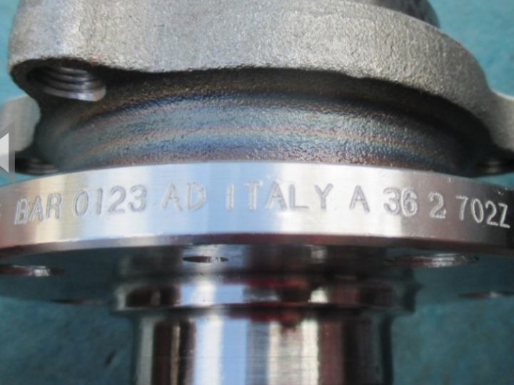

1eapplebaum has much to be proud of1eapplebaum has much to be proud of1eapplebaum has much to be proud of1eapplebaum has much to be proud of1eapplebaum has much to be proud of1eapplebaum has much to be proud of1eapplebaum has much to be proud of1eapplebaum has much to be proud of
This is the SKF number on the hub assembly. SKF precedes the word bar on the file photograph.

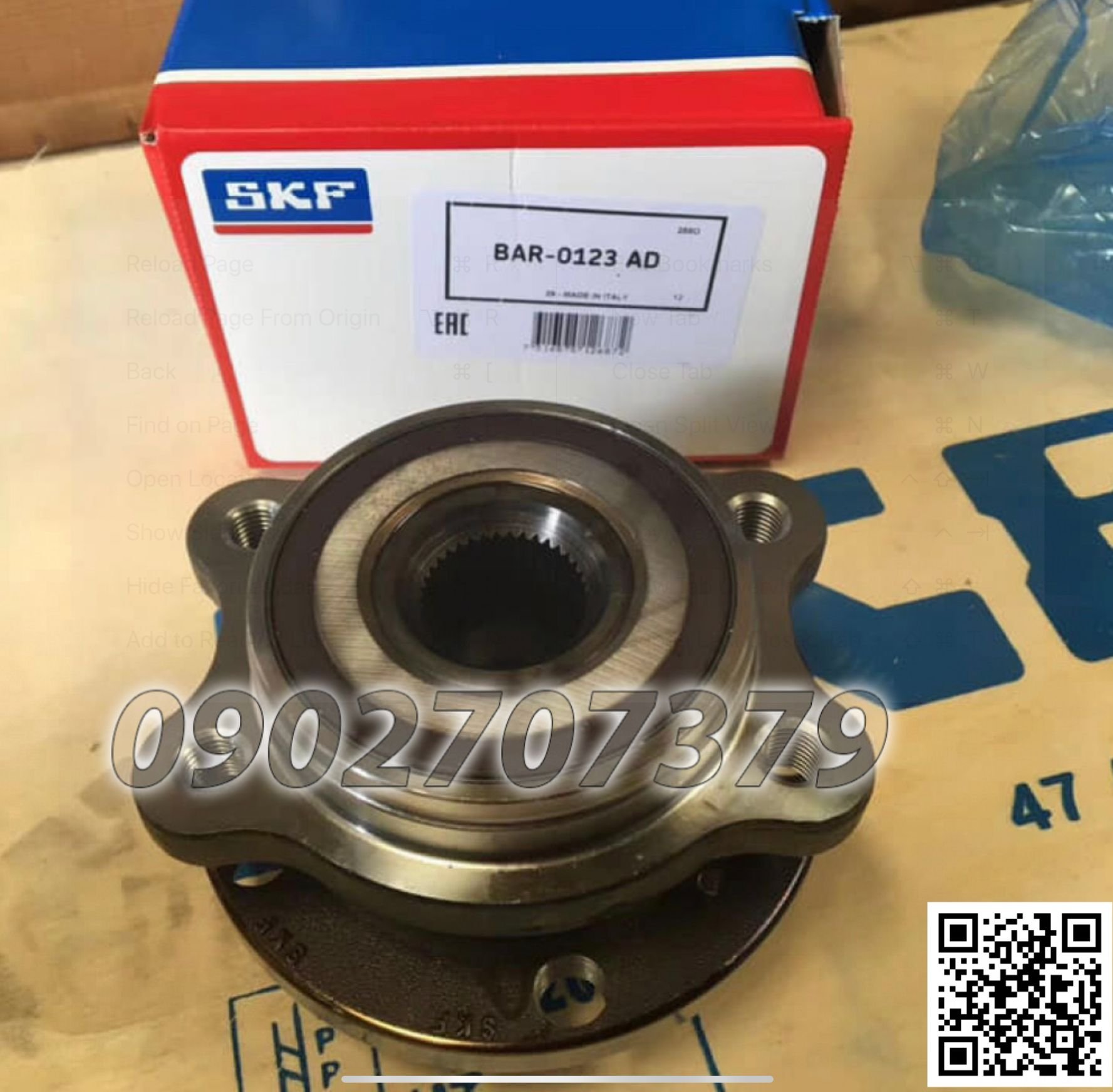

nguyennhatquang has a spectacular aura aboutnguyennhatquang has a spectacular aura about
I found this pic online.. is that the right one?
I google SKF BAR-0123
Originally Posted by nguyennhatquang
I found this pic online.. is that the right one? I google SKF BAR-0123
Sell BAR-0123 AD Front Wheel Hub Bearing, RFQ Sell BAR-0123 AD Front Wheel Hub Bearing High Quality Suppliers & Exporters at www.tradebearings.com https://www.tradebearings.com/Sell+B...suppliers.html
That probably is but the vendor is sketchy. Tomorrow try calling a bearing distributor that carries SKF product. Pass along the part number. Cross-referencing and research like this is interesting occasionally there is a slight variation that makes the part incompatible.

I just call the supplier in china and they said it is Original SKF and fit bentley which they sell many
asking $159
I will order one and see if it work
