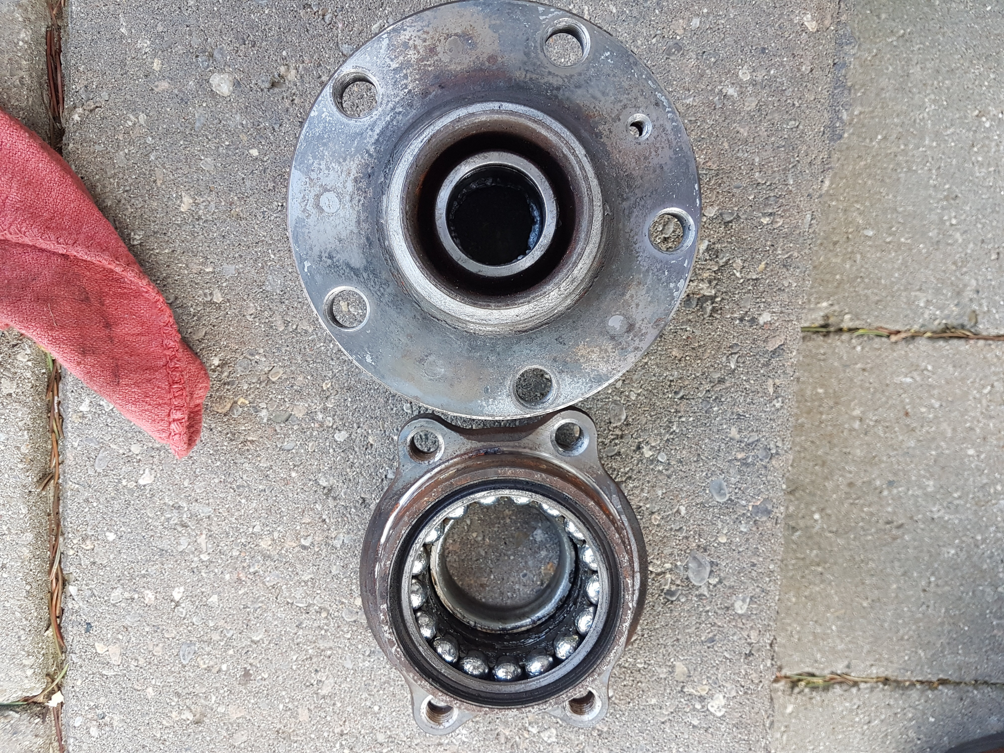

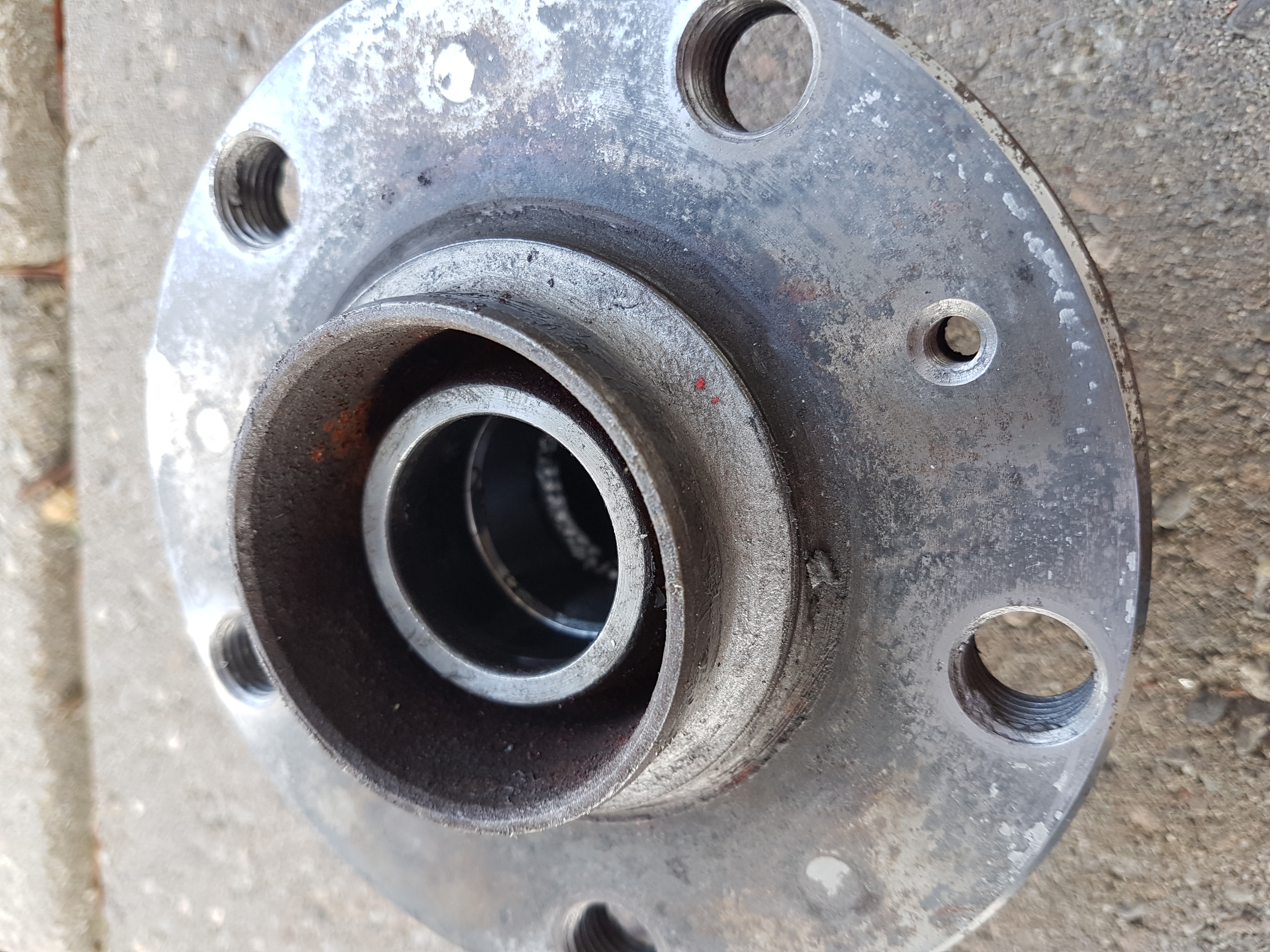

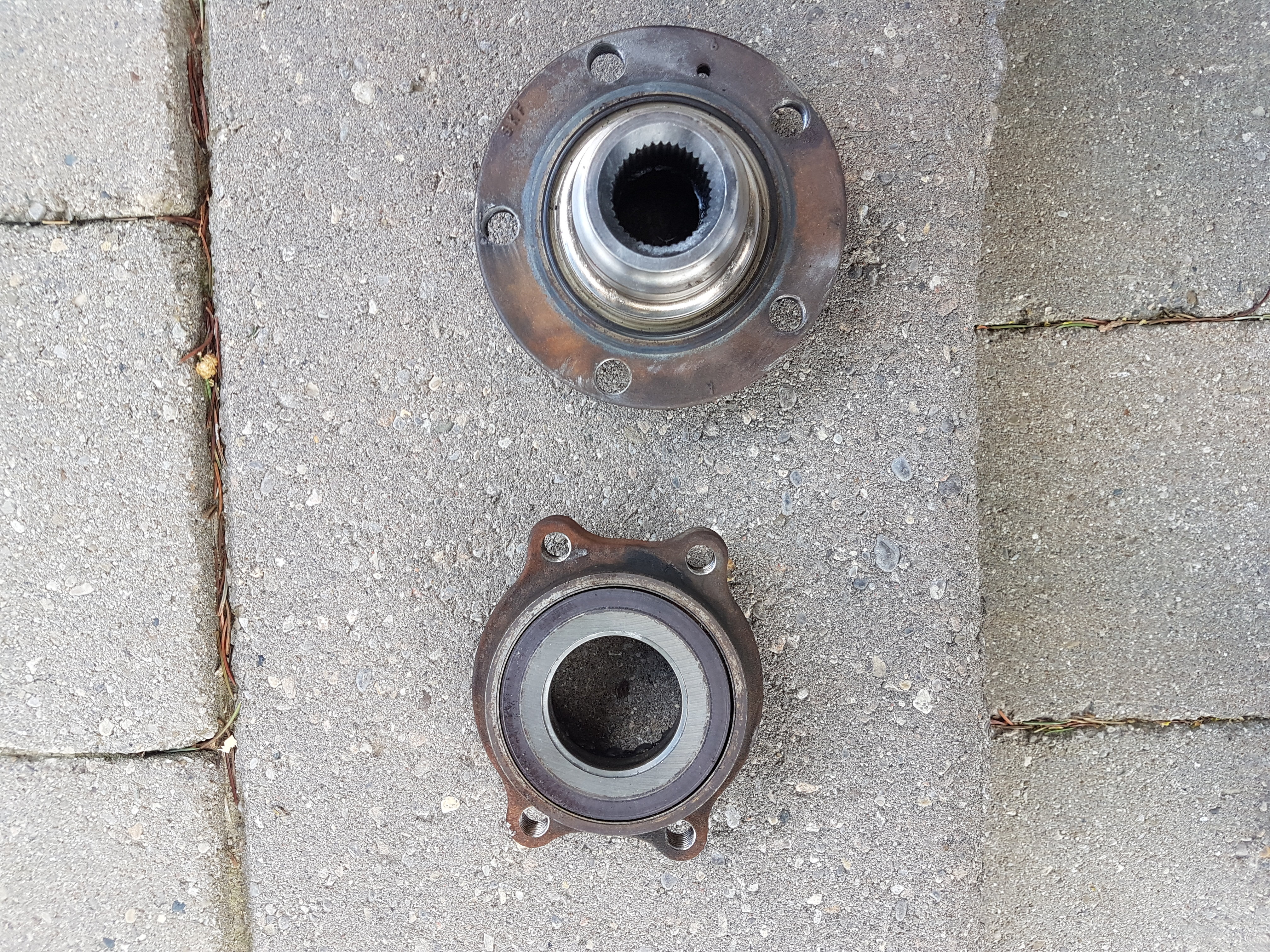

front left wheel bearing r/r
Last week my Indie was doing an alignment on my 2005 BCGT front end and heard a wheel bearing noise on the front left. There was no play in the bearing and I couldn't hear it (I'm hard-of-hearing). I went for a 2nd opinion and got the same answer...bearing noise on the left front. Note: car has circa 55K miles on it.
After a lot of research, I thought I might get away with an Audi S8 bearing. My hope was to reuse the Bentley hub. Everything on the spec appeared the same and the Audi bearing was only $300.00 Cdn.
WRONG!! The hub on the Bentley is exclusive to Bentley and you can only use the OEM bearing/hub combination. The price ranges from $500.00 US (including shipping to Canada [but not including duty and tax] from the UK from Scuderia systems) to $1231.00 Cdn (from the Bentley dealer). (Gasp!). Because we had the car apart and I couldn't tie up the garage's hoist, I was forced to source from local Bentley dealer. Parts plus two hours of labour = $1740.00 CDN (HST tax in).
It is not a difficult job. However, you will need a press to separate the bearing/hub assembly.
Put the car in "jacking mode". Remove the wheel, loosen the center bolt to the shaft; unbolt the caliper (huge) and hang it off the knuckle to avoid having to disconnect the lines; remove the brake rotor; remove the center bolt to the shaft and then remove the lower wishbone mounting bolt (very long). You can then remove the shaft from the bearing by pushing back the shaft. Once the shaft is out, unbolt the bearing from the rear of the knuckle and the hub and bearing can be removed simply. Before we removed the hub/bearing, I could hear the grinding noise when I spun the hub with my hand.
Remember to use NEW bolts for the bearing and the center bolt. They are not included in the price. Because you are not altering the suspension geometry, you don't have to do an alignment.
Everything seems fine now.
