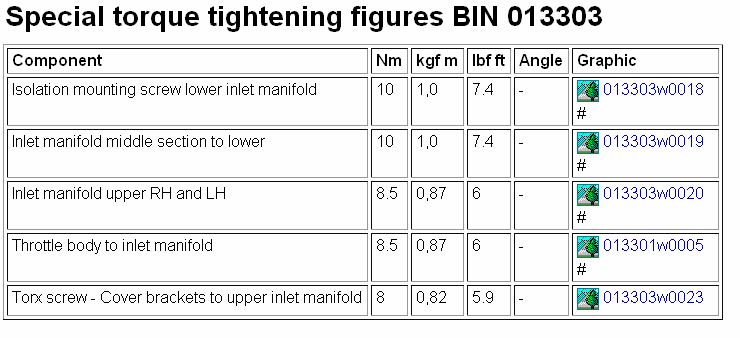

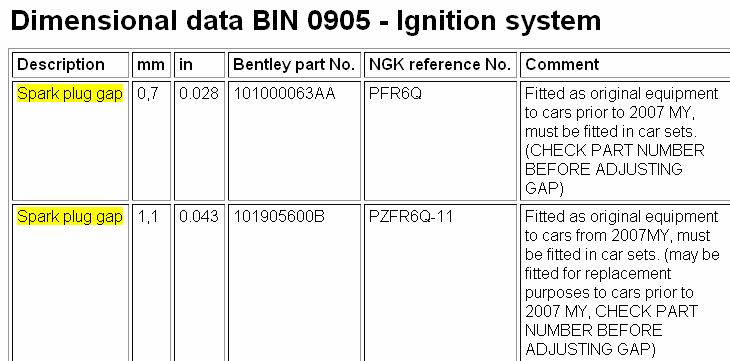

Hi all, I have a 2012 Bentley Continental GT W12 and I am changing plugs and coil packs.
1. What should the gap be on the plugs and what should torque be on plugs?
2. What do I torque the manifold to?
Thank you for your help. Paul

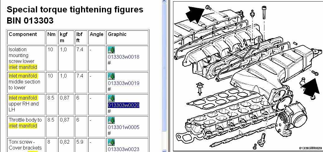

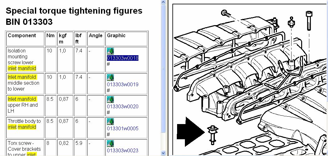

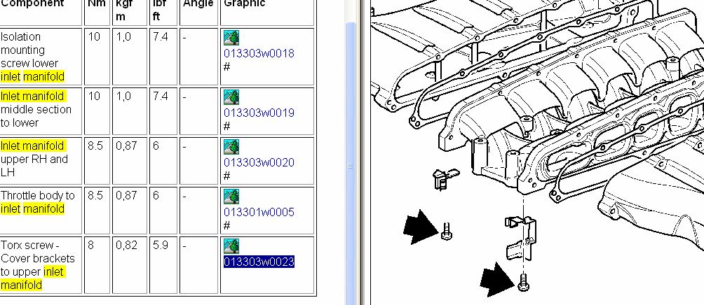

spark plugs should be torqued to 19-22 lbs. See diagram for plug gap. Also see diagrams below for torque spec on intake manifold.
PM me if you need additional info.

Thank you very much! That was very helpful and all is back together. Miss is gone also so assume coil pack was bad. Thanks again
