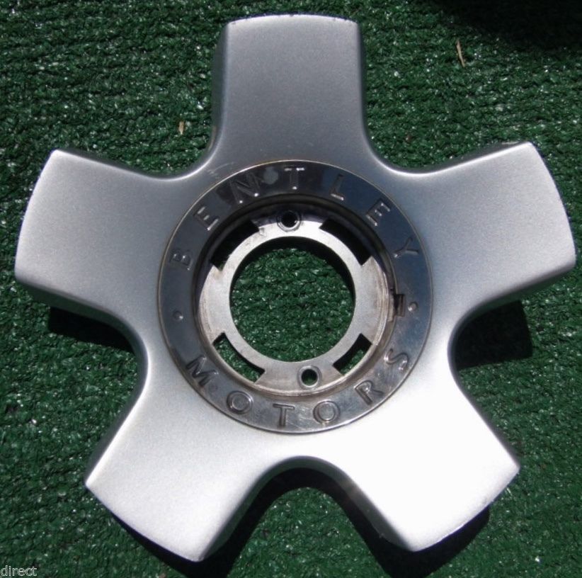

Does anyone have any experience changing tires on this vehicle? I can remove the center cap, but I am at a loss to go further. Bentley Tech said the inner housing pops out. I cannot seem to do that. Any help would be appreciated.

Hello,
After you remove the "B" you should see 2 allen head screws like shown in the photo with the holes at 12 & 6 o'clock.
