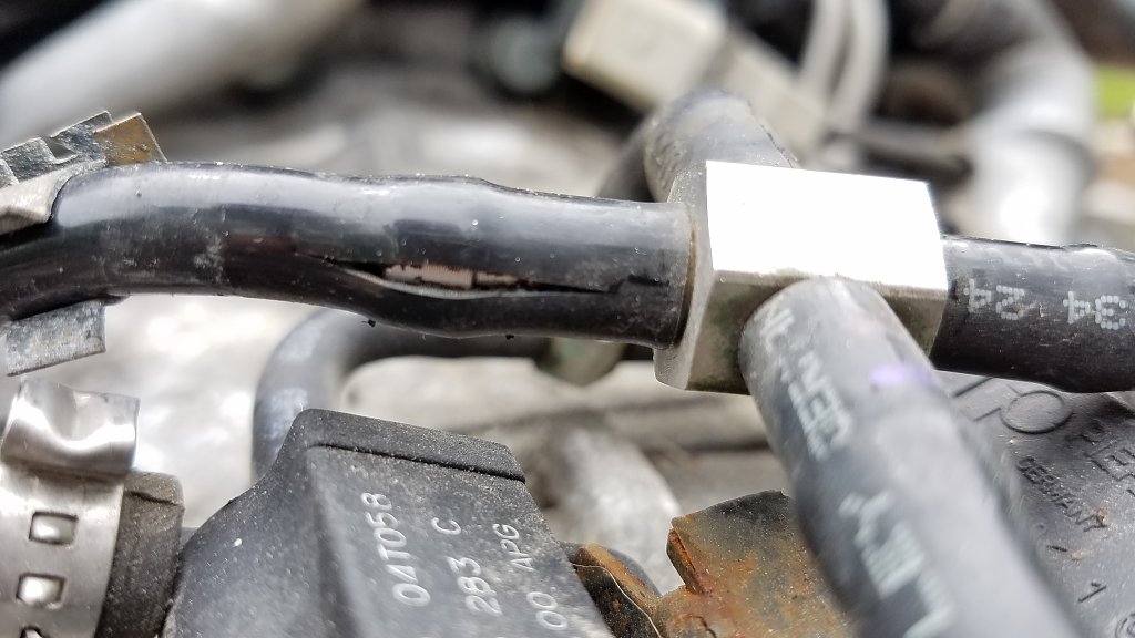

Originally Posted by Mauser
can you give me more detail on the 'Infamous vacuum leak/engine out' problem please ?
Plastic lines on the top of transmission crack on 04, 05, and some 06's, engine and trans assembly must be dropped to make repair, there are also plastic line along the firewall that fail sometimes.
Here is a picture of my 05 lines, Jason in the video made me a new set.

Wow Unbelievable ! So, I'm assuming there was never a recall for this therefor how the heck will I know if it's been done or not if I find a car that doesn't have all the Garage receipts ? Or maybe it's so common, a bit like the Maserati cam variators that everyone looking to buy an early Bentley GT wants proof the job's been done ? Any idea what this job would cost at a Bentley dealership ?

Labour costs for an engine/transmission R&R are around 45 hours. Parts for this problem are usually insignificant (i.e. couple of hundred dollars). While the vacuum leak is a known problem, not all cars experience it. I have 55,000 miles on my 05 and, in spite of doing exhaustive testing, have not experienced the issue. I know five Bentley Conti GT owners of similar vintage in my area and only one has encountered the problem. It showed up in a smoke test. It is relatively easy to diagnose (see several posts on this forum). Unless there is supporting paperwork, I know of no way to determine whether or not the procedure has been performed. There are other vacuum leaks that can occur, but do not need the engine/transmission R&R to fix.

Originally Posted by PMS
While the vacuum leak is a known problem, not all cars experience it. I have 55,000 miles on my 05 and, in spite of doing exhaustive testing, have not experienced the issue. I know five Bentley Conti GT owners of similar vintage in my area and only one has encountered the problem..
Hello Peter,
That's good to hear, but I am wondering if yours was fixed prior to your purchase, of the three I have personally seen, all three had the issue, 1) my 05 one owner from Long Island with 10,388 miles with cracked lines as shown in photo posted in prior post, 2) a one owner wrecked 04 engine and trans package with verified 28,000 miles (45,000 KM) from Canada with cracked lines, 3) a one owner 05 with 13,000 miles at a salvage yard with, you guessed it, cracked lines, and a fourth that I did not see myself but was told buy the person whom sold me the black 06 parts vehicle seen in my re-build thread, that he nor his mechanic knew of this issue only to install the engine and trans into another vehicle only to remove it again for the repair, he was very @$@#% !!!
So that's 4 out of 4 for me....
And I am sure Jason (BentleyTech NY) has seen many.

Originally Posted by Johnny Hotspur GT
Hello Peter,
Possibly you are correct Johnny. My car may have had the repair prior to purchase. My car is from Florida originally and the service records only include OEM Bentley service (not indy services) so, I have no proof of repair. I have my fingers and toes crossed.

I'm the guy with a vacuum problem that PMS mentioned. It is a 2004 with 77000km. I bought it 3 years ago at 49000km.
Like others said, the actual vacuum line is cheap but the cost of labour is the killer. The entire engine has to be taken out.
Here are my major repairs:
1. Vacuum Leak ($$$$$)
