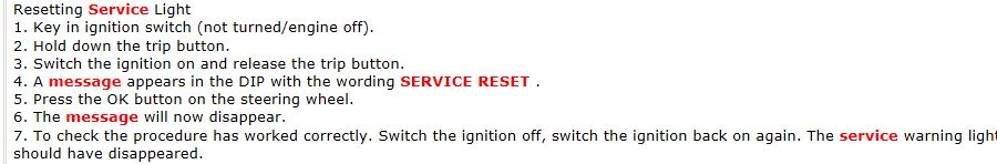

member STEVENRMUSIC posted these instructions previously on this forum.

I got rid of the service reminder, following your procedure.
