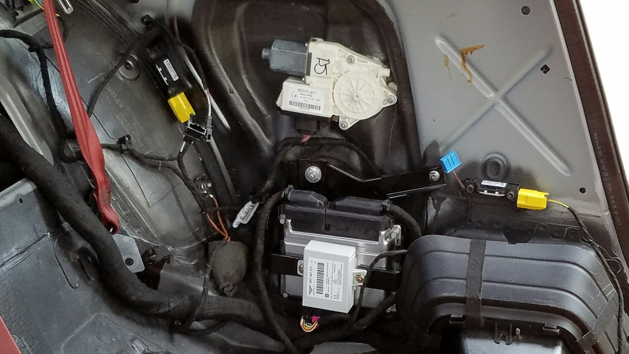

All I can say is "WOW", that's a good one, go back and smack your Indy upside the head with a phonebook.... There are no air lines running to "air strut control module", AKA Suspension Control Module, nothing but wires, you can see in my attached picture said module located on the drivers side rear quarter below the quarter glass window behind the white TPMS module, the suspension CM is part#3W0907553 + the suffix letter depending on the year or revision like "A", also the $2000.00 for a used part is ludicrous, and the $4000.00 new, BS.....

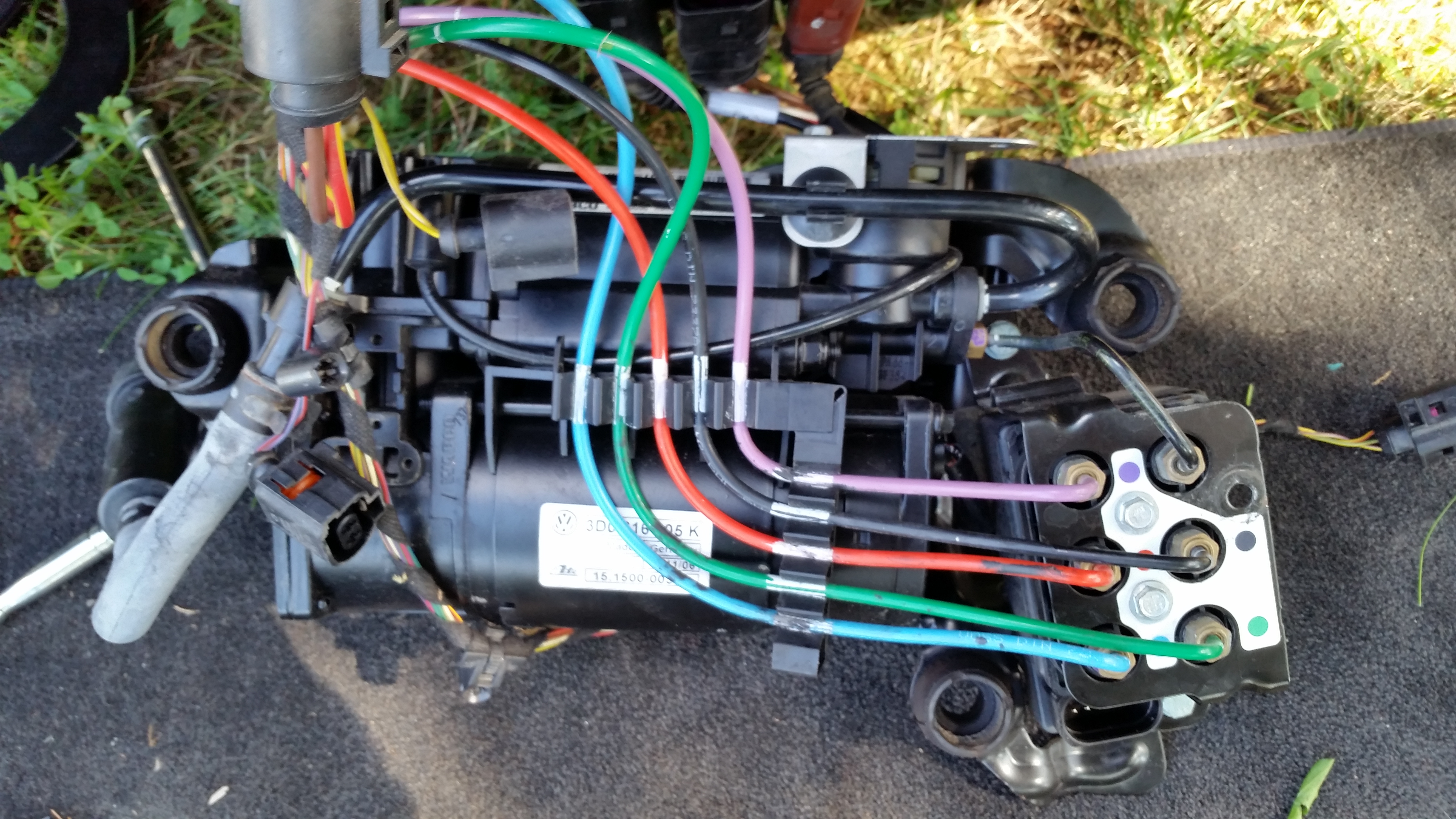

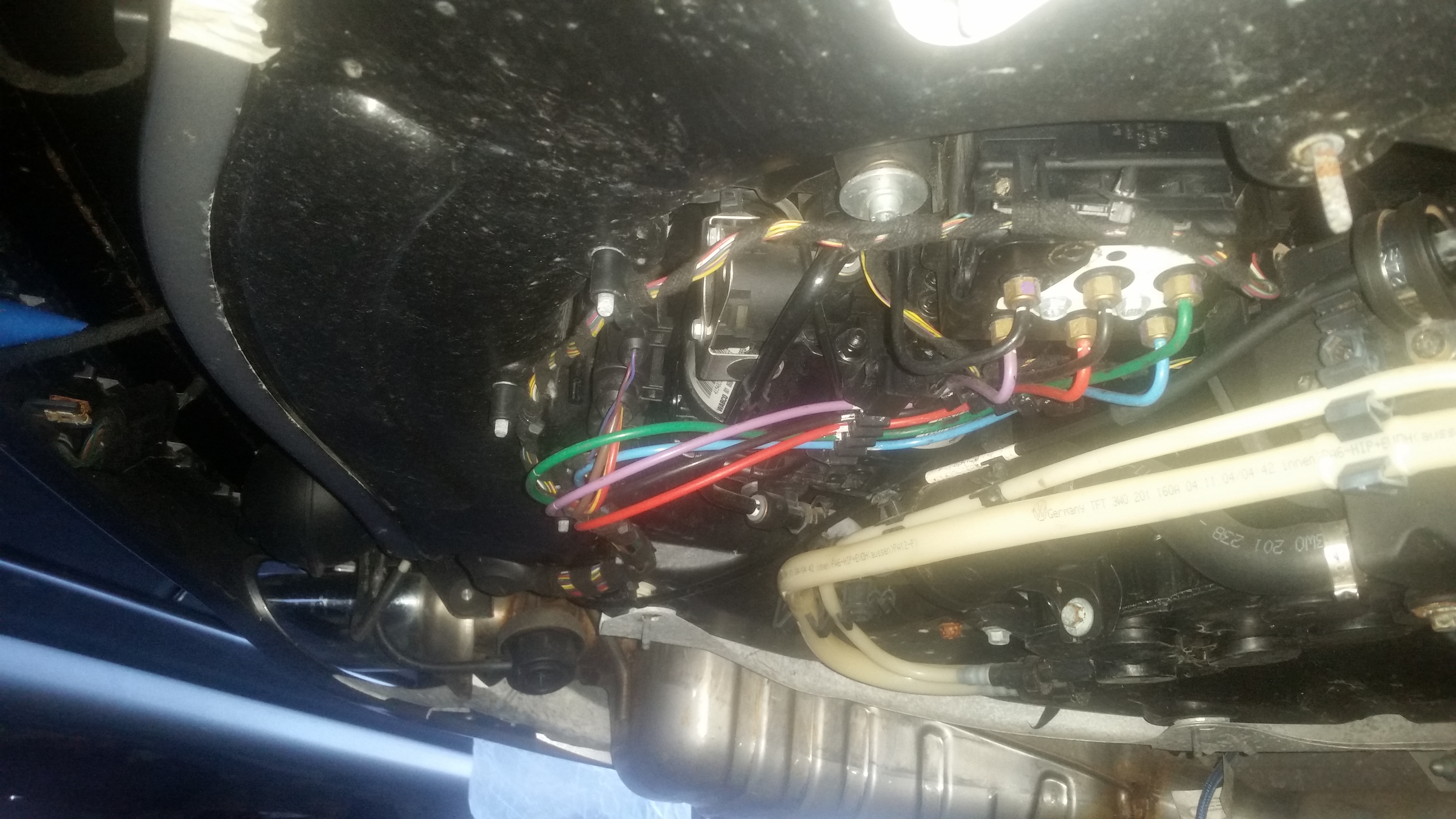

Now if your Indy meant something totally different, like the air suspension air distribution valve block located under the vehicle in the spare tire circle mounted on the air suspension compressor itself, then that would make since as to a possible leak, but again the whole compressor with the VB attached is not $2000.00 used, I have that setup here in the marketplace for $850.00, but by what you stated he said, I am going with he is trying to screw you by stating that the air suspension control module is leaking air internally......
