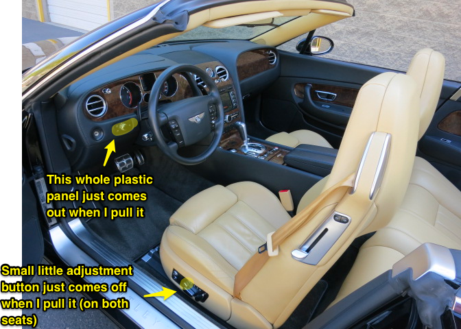

I) Couple of panels and buttons just come off when I pull it. On 2 other 2005s, those don't come off. Anyone has the same issue where they just come off? (see attached)

I) Never had buttons become loose or fall off. Everything seems over engineered -- ***** and pulls seem like chrome plated metal and not plastic
I haven't seen this and sounds like someone has broken the tabs tinkering with it or replacing the part.
