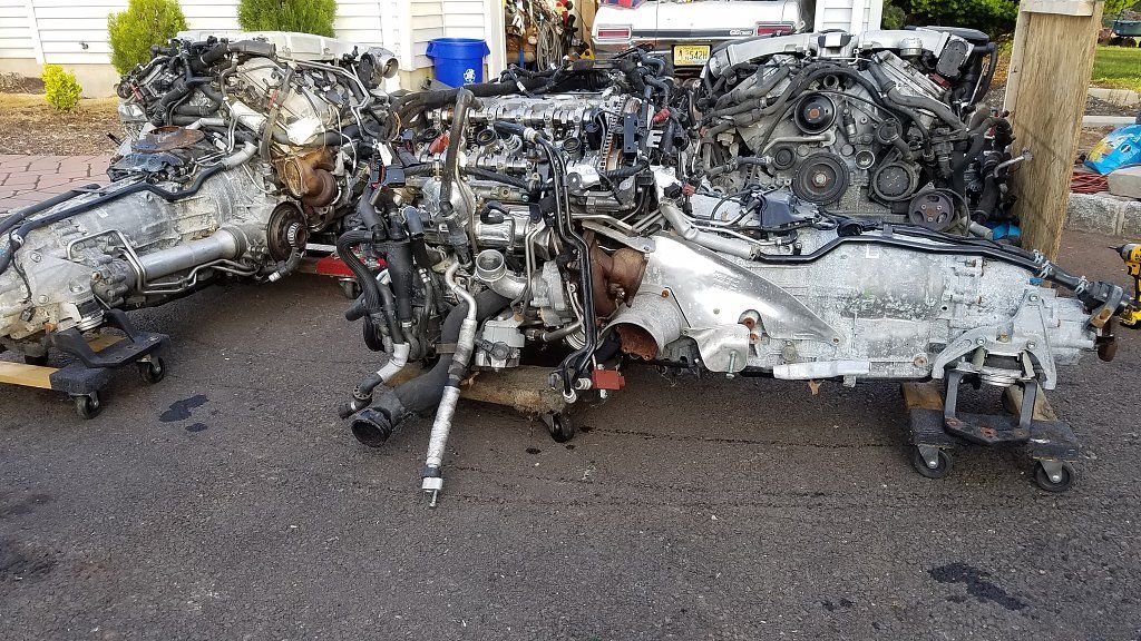

@bigreddon & @captainbaker ,
It is indeed an engine and transmission out job for 2004-2006 GT, one can not service the vacuum lines and solenoids over the top of the transmission without dropping the package.
Here are the cracked lines at the stainless steel four way fitting over the transmission on my 2005 with 8840 miles at the time.
Johnny

it IS NOT an engine out job. 3 hour job. I’ve done it 6 times.
No disrespect @bigreddon ,
But, if you have done this job 6 times already, then you have either worked on only late 2007 or newer GT/GTC's or Flying Spur's, or, you have only fixed half of the issues with the lines on any 2004-2006 GT, as these 2004-2006 GT's have more plastic lines down the back of the engine and over the top of the transmission to the solenoids, these lines fail just like the lines along the firewall.
Johnny

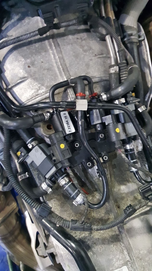

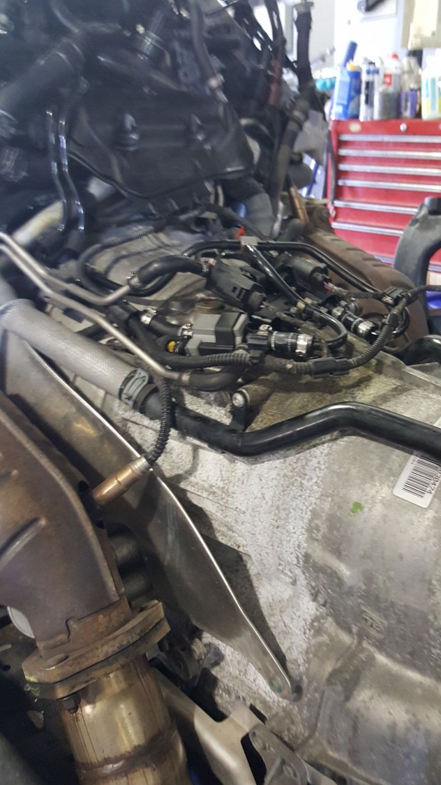

Another view of 05 vacuum lines
05 BCGT transmission vacuum lines
05 vacuum lines
