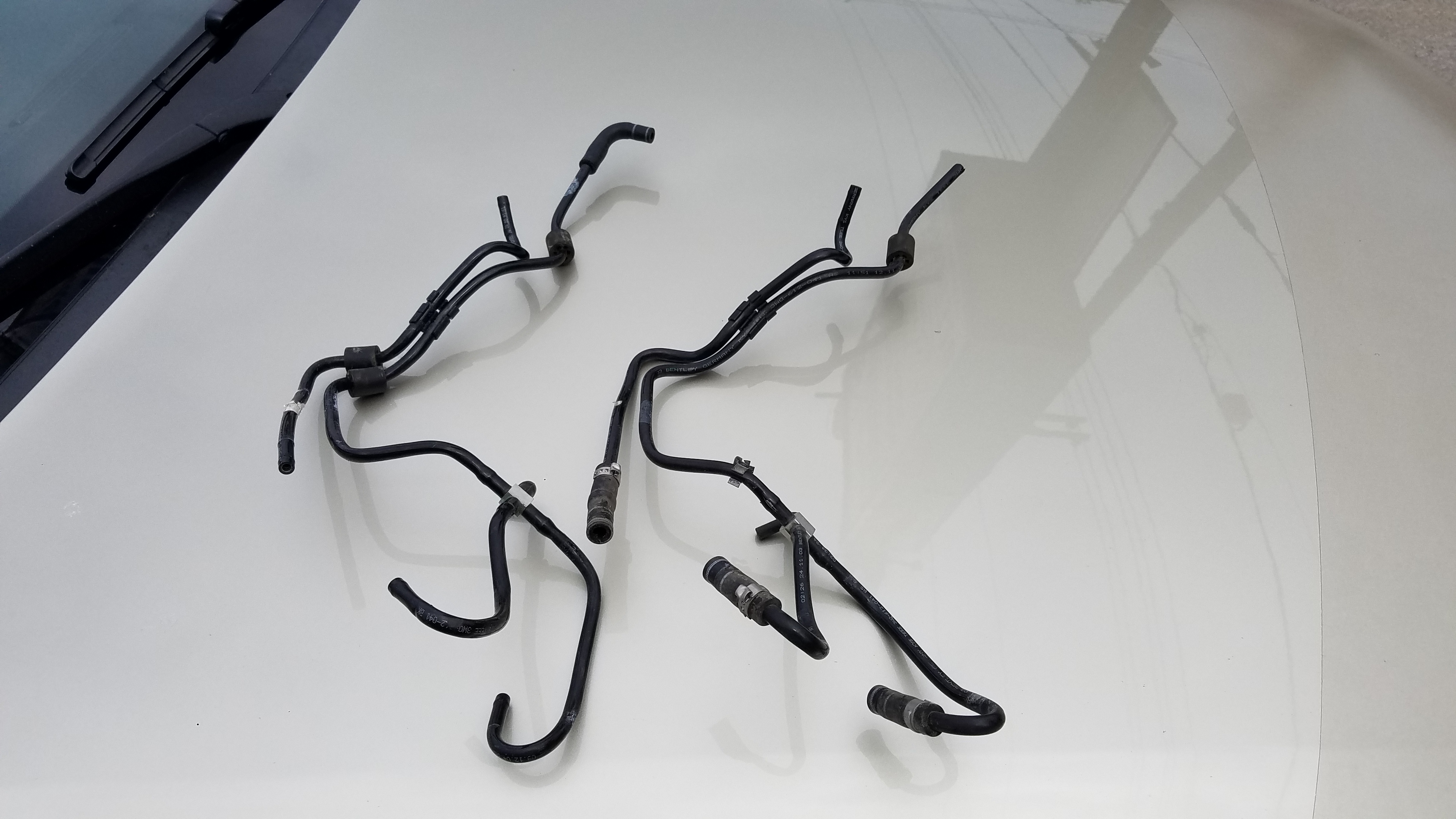

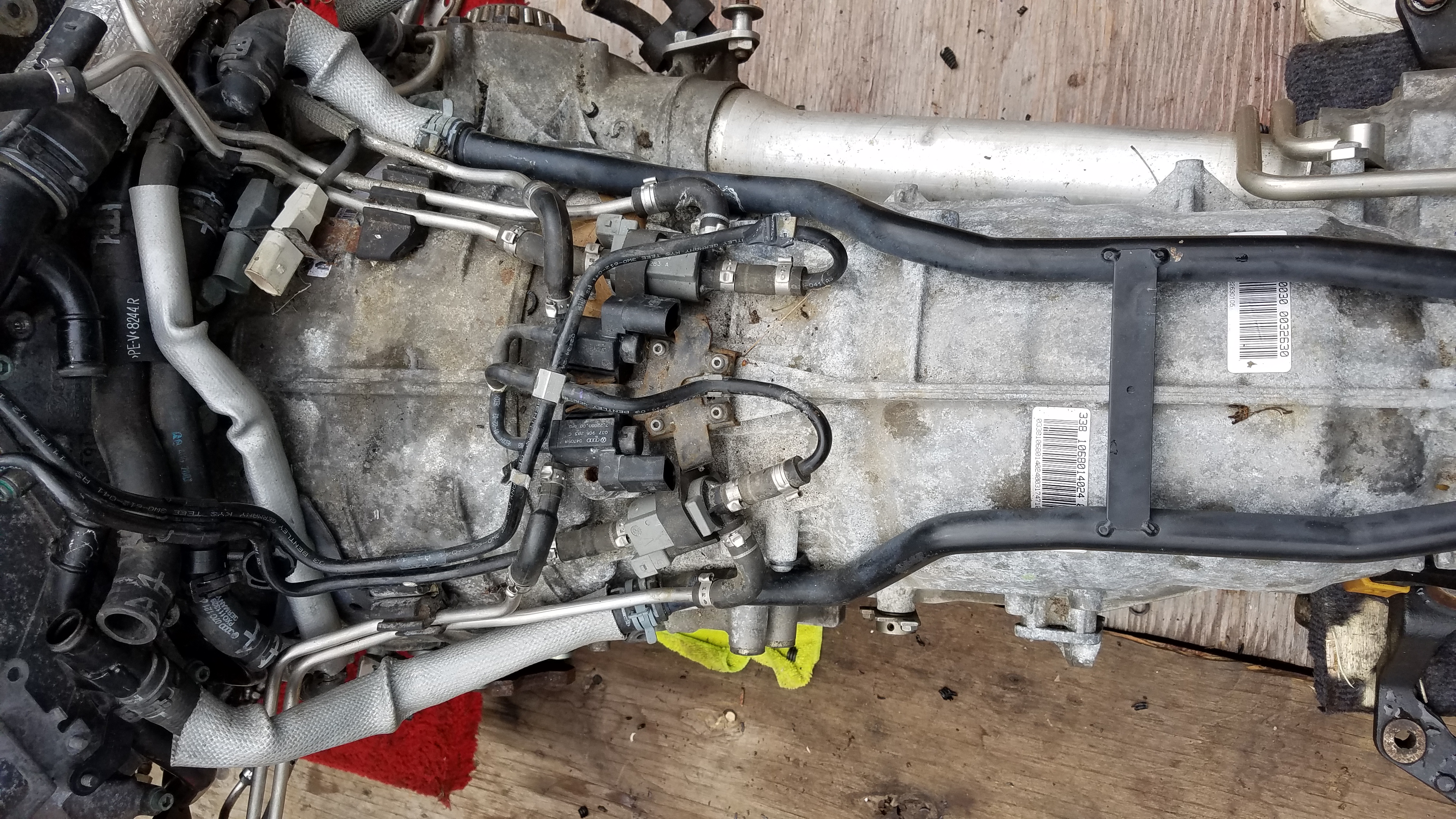

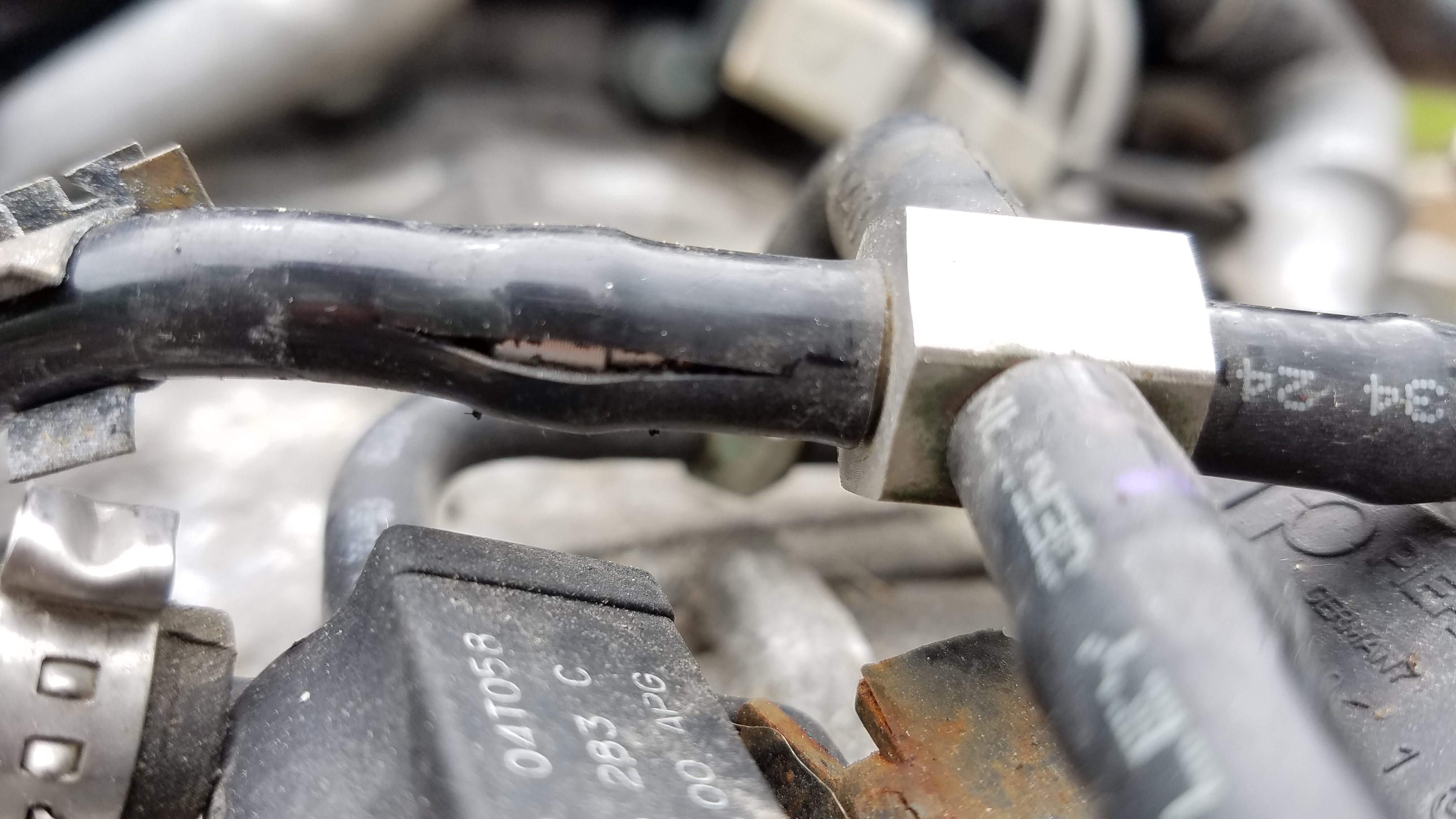

Originally Posted by tarnow1942
I wouldnt not buy an 05 because of this. Budget it in your purchase price. I did. If the vacuum leak occurs,pull the engine yourself or at an indi. Change the vacuum hoses to steel. Change the starter. Change the top O2 sensors,and enjoy the car for years.
+1.
My 05 GT only has 8840K miles on it and the plastic vacuum tubes were cracked at the connection areas on said tubes.
You would do the replacement of vacuum tubes only once, you would replace them with steel tubes and not the dealer plastic replacement parts.
See my GT build thread for pictures of cracked plastic vacuum tubes.
https://www.6speedonline.com/forums/...-pictures.html
